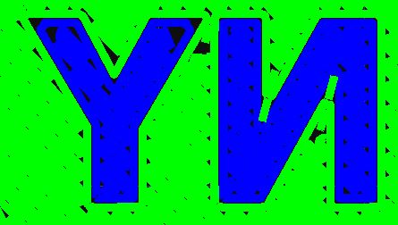

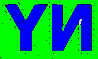

Please revisit print paths for v1.6 Release Candidate 2.5 versus v1.6.2 Release. Unless there are some circumstances I'm not aware of, v1.6 Release Candidate 2.5 has more robust print paths. v1.6.2 Release seems more likely to leave gaps in my prints.
Print Gaps In Y Extremities And Between Letters N And Y
No Significant Print Gaps In Or Around The Letters N And Y
Edit: v1.6 Release also looks good with minimal gaps, but not quite as good as v1.6 Release Candidate 2.5 above
