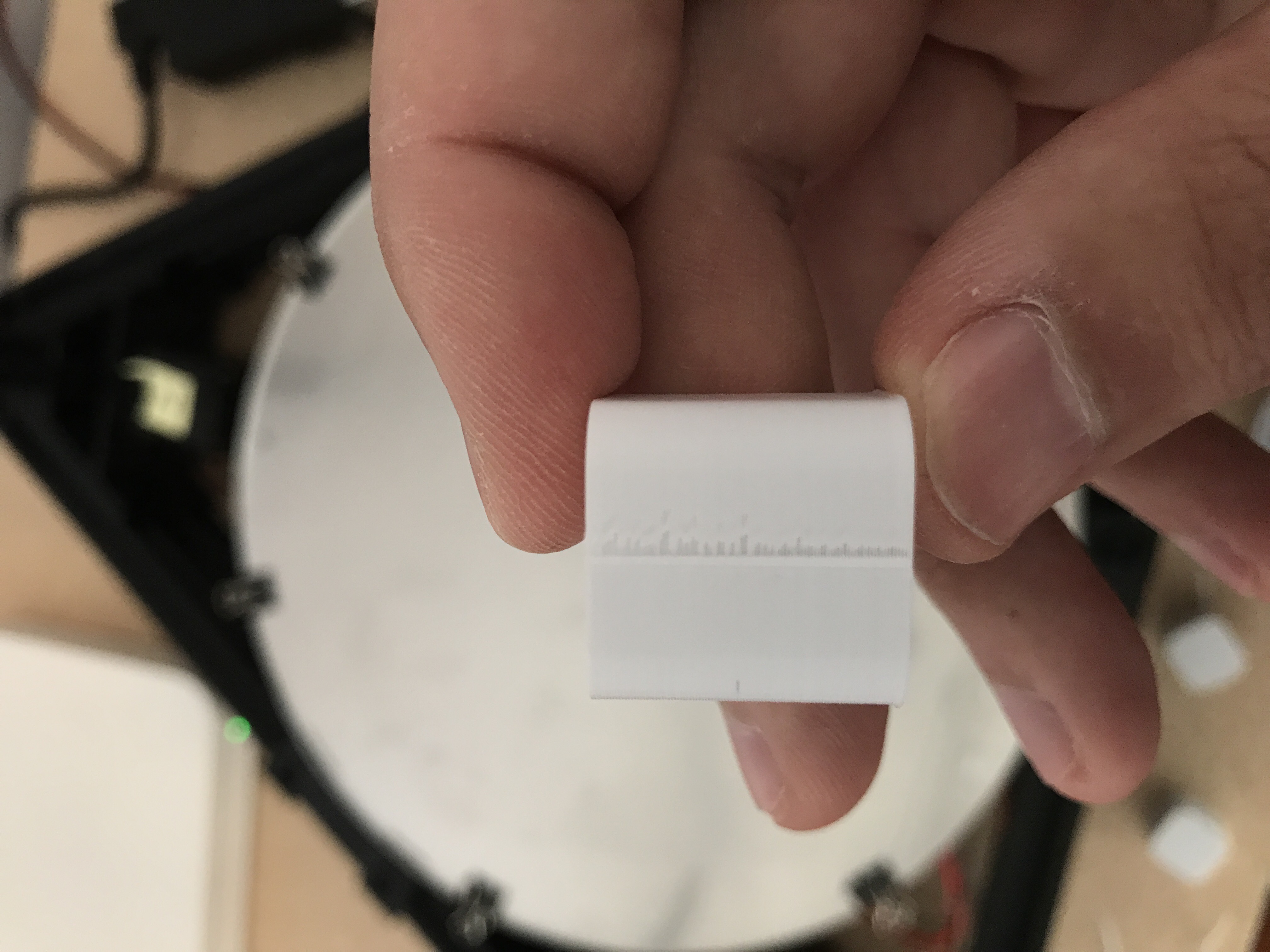

I just finished my preload test from 0 - 1. Do I have any layers that are 'good'? It posted the picture sideways but the 0 side is on the right and 1 side is on the left.

Could you please zip and post the G-code?

Seam on the side, what a novel idea. Probably easier to read than on the corner like mine.

I used the profile from the kisslicer weebly page for the D300VS and that is how it printed

I just looked over your G-code. Your Drive Length is 78 mm, which is a nice tight direct drive. You won't really need the Preload functionality on your extruder for stiff materials like PLA (so I would just leave the PreloadVE value at the wizard default for PLA which is 0.75). The Preload function will be much more useful if you want print in TPU or, to a lesser extent, in materials like Nylon.
(I have a Bowden system where the my Drive Length is almost 10x yours at 730 mm, and I absolutely need Preload to print with clear NinjaFlex...because my custom printed Ping Pong paddles needed those clear rubber pads [8^)
