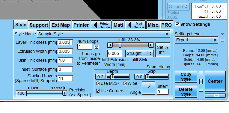

Jonathon, In the "style" tab while trying to enter a dimension in Layer thickness, Extrusion width, Infill extrusion the entry keeps reverting to .005 + the dimension I enter. Windows7 64
- Untitled.png (36.81 KiB) Viewed 27317 times
OK, got it. It happens because the conformance checks on the settings are happening before a valid value is in place (like if you started by typing "0.") A workaround for now is to select and edit a few characters in the existing valid value. Sorry! It's fixed for the release.

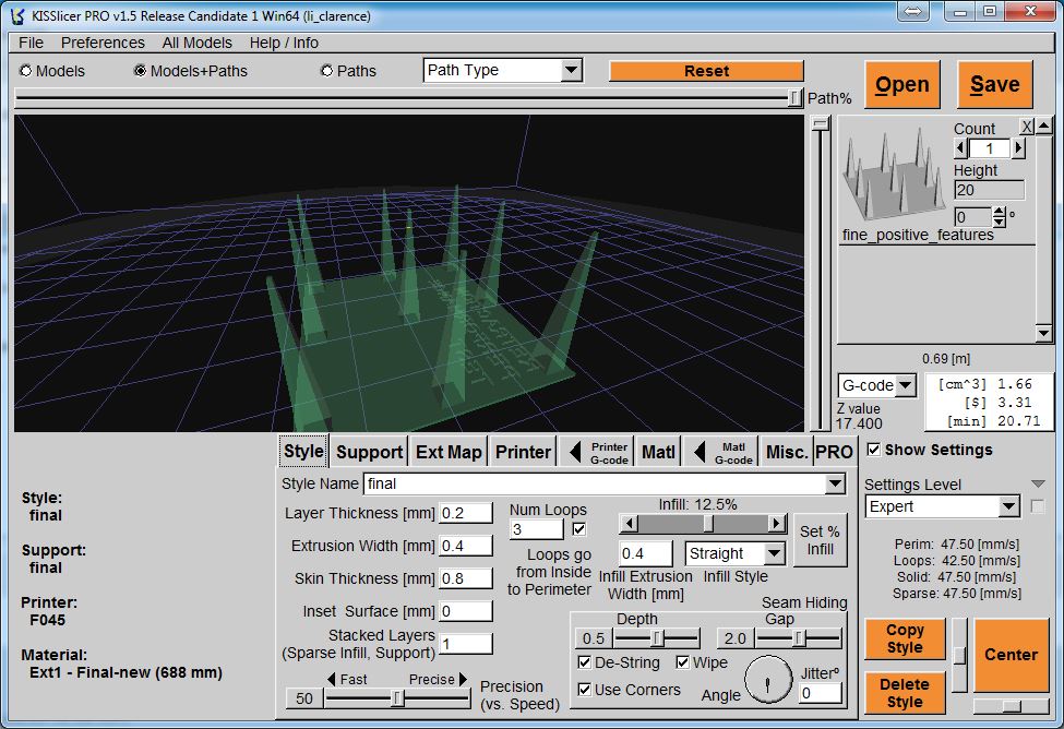

tested RC1, but found it might drop some top layer?
http://www.thingiverse.com/thing:533472
fine_positive_features.stl
on RC1 after slice only till 17.4 layer height
on 1.4.5.10 it's noraml till layer 20mm
after some test found on 1.5beta 2.20 it's still correct.
But since 1.5beta 2.21 it's only left 17.4mm layer.
The top of those spikes seem to be 0.33 mm wide. A full loop with a 0.4 mm nozzle would be 0.8 mm wide, so I wouldn't expect KISSlicer to generate paths all the way up to the tip. When I use an extrusion width of 0.15 mm it does fill all the way to the top, as you would expect. I guess I could see generating the top of the spike with a single extrusion while moving vertically, but that seems fairly unusual, and prone to other issues (like knocking off previous spikes when moving back down to do other plastic on the same layer).
