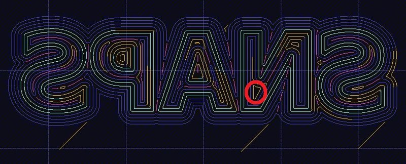

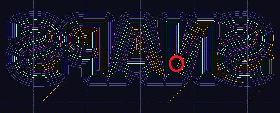

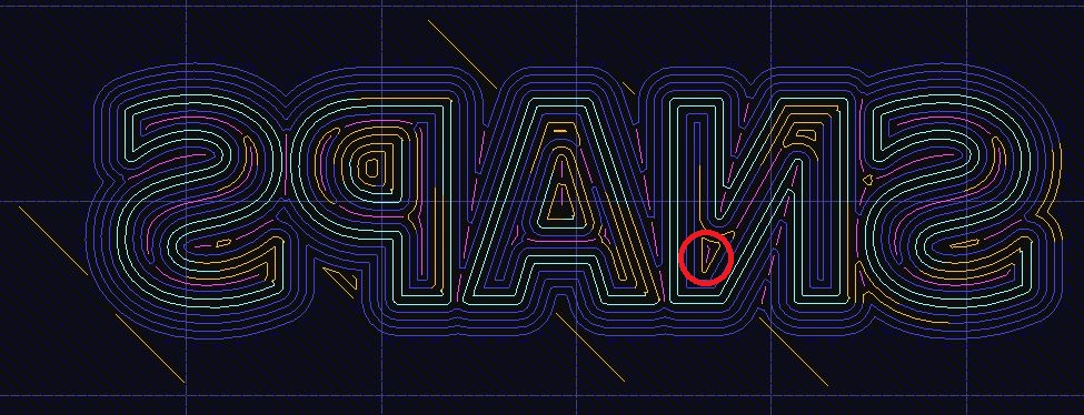

Thanks for allowing narrower crowning paths because they can be useful in some situations even if they are not ideal in every situation. For the most part the KISSlicer v3.8 update cleaned up the gaps I was getting in my text after v2.2. However in the below example one of the crowning paths in the letter "N" is missing in the first layer, but it appears in the second layer. Is this by design or can you make the crowing path appear in both layers?
The paths were created w/ 0.4 mm extrusion width and 5 loops. I attached the files for your reference.

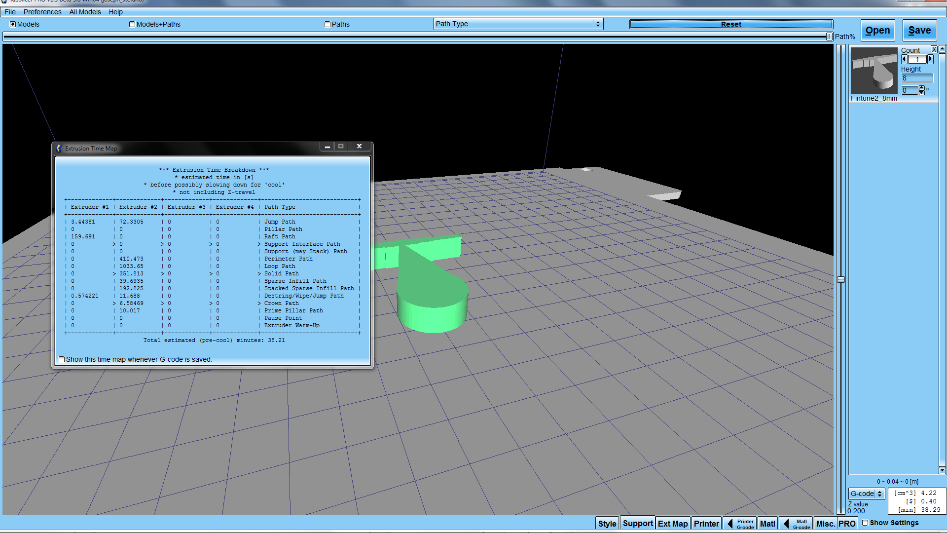

Regarding the extrusion time map, I'm guessing that G-code comments are disabled?
Regarding the crowning on the bottom layer, that was definitely not intentional.
I will look into both of these, thanks!

Yes, it does display with comments enabled.

@inventabuild: Just playing with my internal thresholds didn't fix that crowning issue, and I don't want to change any core mechanisms right now before the 1.5 release, as I'm afraid of breaking other stuff. I'd like to postpone working on this until after the release. (Btw, did you know that you don't need to cut the text out of the box top? You can just assign the extruder with the text a higher priority and KISSlicer handles the overlap for you.)

- fixed time map when G-code comments were disabled

time map works.
