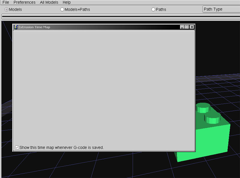

frozen.rabbit
Posts: 137
Joined: 17 Nov 2014, 09:20
Post by frozen.rabbit »
Extrusion time map is a blank window in Win64, single extruder set up.
joestefano
Posts: 57
Joined: 14 Nov 2014, 17:53
Post by joestefano »
You have to save your G code before you load that feature
frozen.rabbit
Posts: 137
Blank after save.
