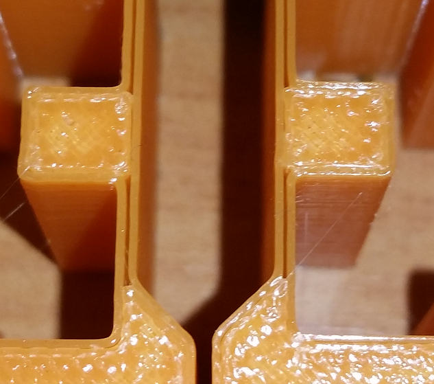

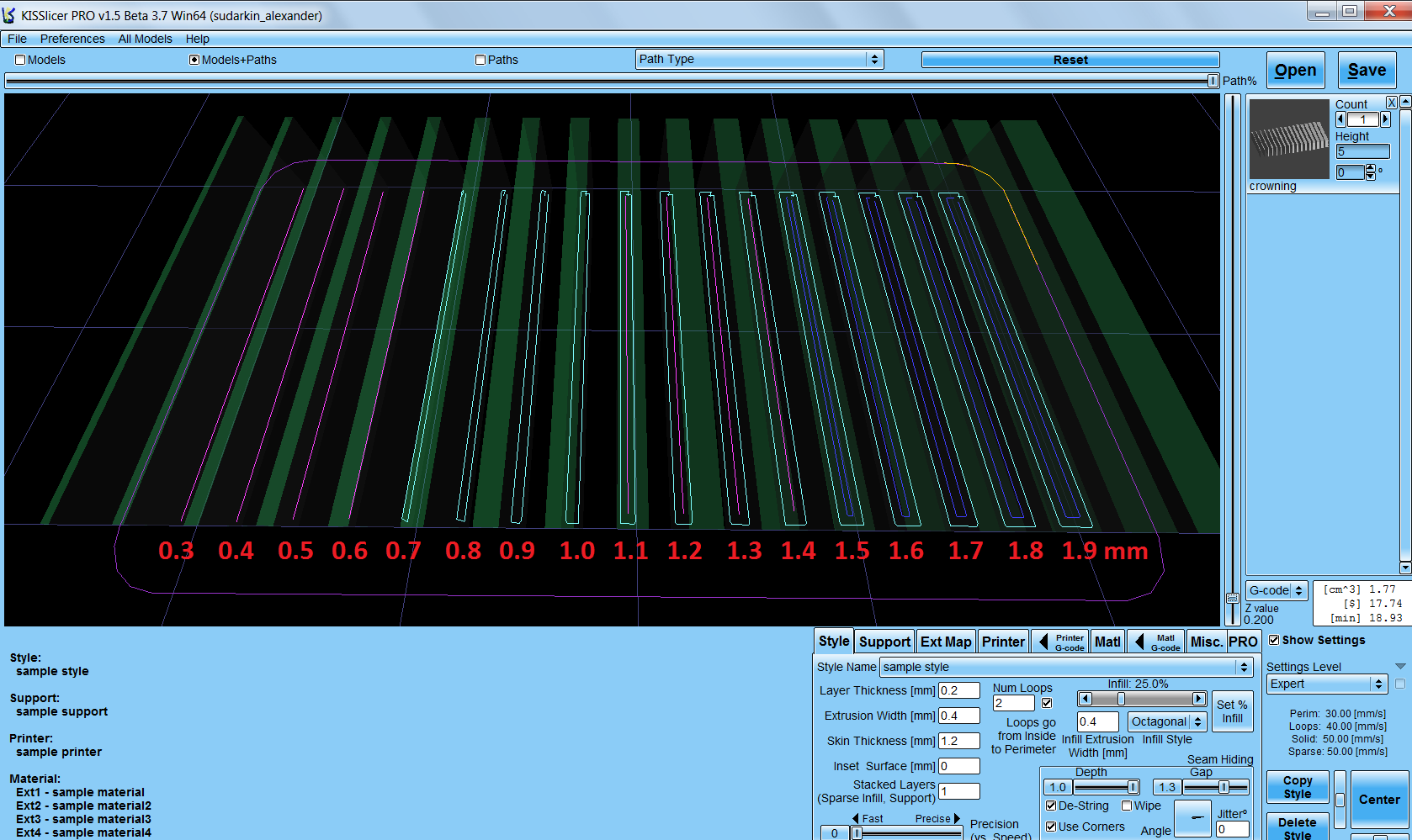

Hi lonesock !
Please fix a crowning problem for walls 0.9 and 1.0 mm. if extrusion width 0.4 mm.
for 0.9 mm wall - gap is 0.1 mm
for 1.0 mm wall - gap is 0.2 mm
crowning.zip
stl file with walls
(1.96 KiB) Downloaded 967 times
radus wrote:Hi lonesock !
That behavior was actually by design. In my testing I couldn't get decent extrusion below 1/2 the nozzle diameter, so I just disallow extrusion less than 1/2 extrusion width. I guess I can try it again, but it will have to wait till after the 1.5 release.

lonesock wrote: That behavior was actually by design. In my testing I couldn't get decent extrusion below 1/2 the nozzle diameter, so I just disallow extrusion less than 1/2 extrusion width. I guess I can try it again, but it will have to wait till after the 1.5 release.
Imho let be a poor extrusion, than is empty space.
Empty space =(
Empty space =(
radus, could I please download that model? I will play with it. Note that I can revise the limit on the crowning width down, but there still needs to be a threshold so the printer doesn't waste time laying down plastic in tiny microscopic voids.
