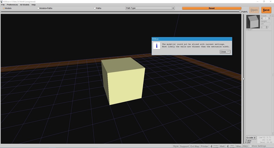

Maybe i'm doing something wrong ...
I downloaded both 3.5 and 3.6. i just copy and past my setting files but i can't slice anything, i always encounter this error message (see screenshot)
I can reproduce your problem but only with the unregistered version of KISSlicer. Weird enough, the "Style" settings are completely different depending on whether I start the registered or the unregistered version with your set of ini-files.

After some testing I know a little more now on this problem :
Testing Environment ==>> Windows 10 X64 Pro - Kislicer 1.5Beta 3.6 unregistred - STL file is a simple cube 25*25*25
1/ I run Kisslicer with his own parameter files ==>> slice it successfully
2/ I only change "Extrusion width" from 0.5 to 0.4 ==>> failure of slicing
2/ I only change "Extrusion width" from 0.4 to 0.6 ==>> failure of slicing
3/ I only change "Extrusion width" from 0.6 to 0.5 ==>> slice it successfully
"Infil Extrusion Width" seems unaffected
