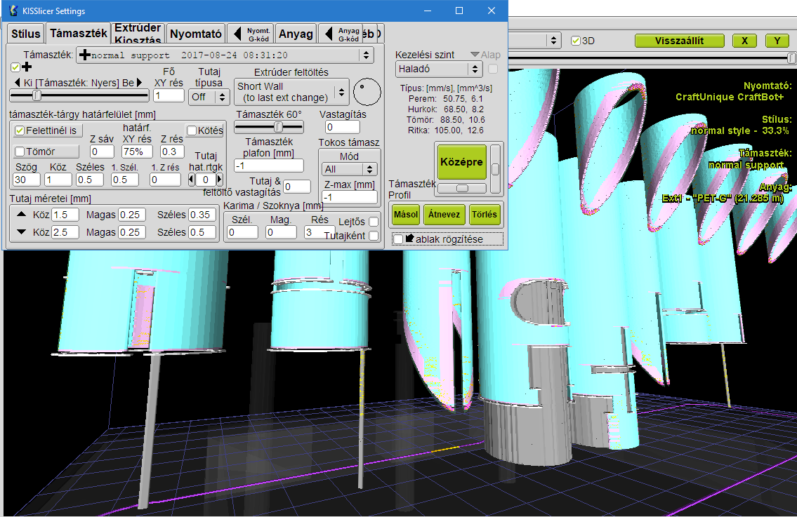

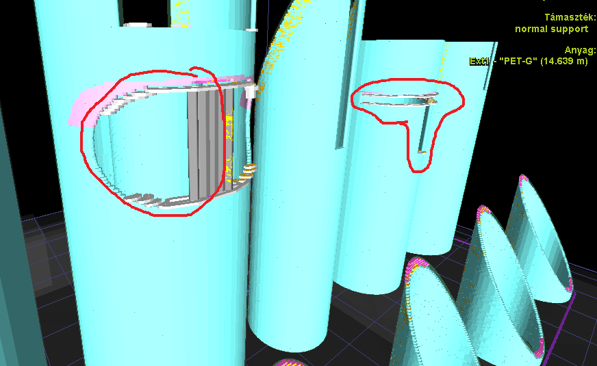

Missing support in the middle.
missing support
missing support
xmas75
Posts: 8
Joined: 21 Aug 2017, 05:38
Post by xmas75 »
Upside down for test more missing, and settings window.
