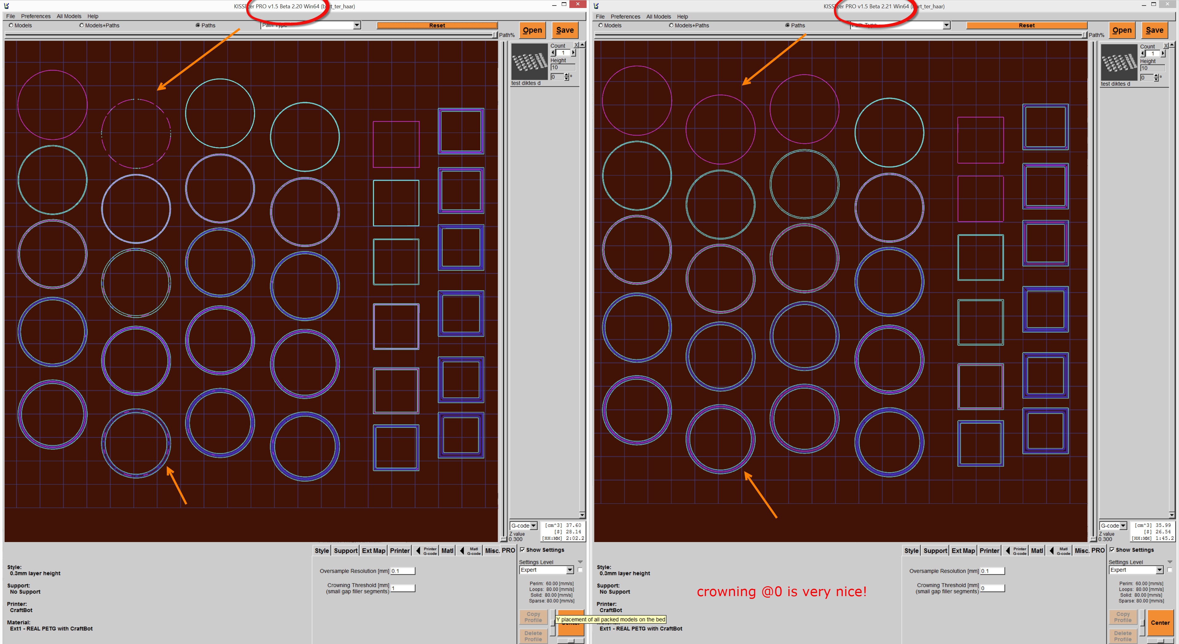

Aloha, a new beta of Kisslicer in the DropBox, 2.21, where mainly Crowning is improved. Test it with crowning set to 0 (zero). With me, it was giving great results:
Bart ter Haar

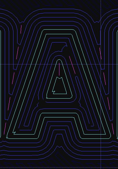

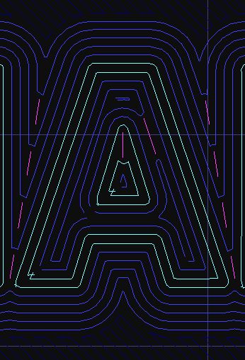

The crowning mod obviously offered some improvements, but it did not fix gaps in letters that I print on the top of a box. Below shows the letter "A" actually prints better w/ Crowing = 1 (1st pic) than it does w/ Crowing = 0 (2nd pic) where Oversample Resolution was 0.1 in both cases.
Oversample Res = 0.1, Crowning = 1.JPG (21.73 KiB) Viewed 5377 times
Oversample Res = 0.1, Crowning = 0.JPG (22.18 KiB) Viewed 5377 times
Style - Letter A Crowning 1 vs 0.JPG (51.15 KiB) Viewed 5377 times

funBart,
Here it is. I'm using two extruders and assigned ext2 to the text. The 1st pic shows Crowing =1 which prints better than the 2nd pic which shows Crowning =0. How can Crowing = 1 fill in the solid spaces in the model better than Crowing = 0?
(Edit: re-loaded these pics w/ Wipe = 0 to eliminate the unnecessary Wipe color in the pics)
Oversample Res = 0.1, Crowning = 1 - Path.JPG (52.23 KiB) Viewed 5350 times
Oversample Res = 0.1, Crowning = 0 - Path.JPG (62.35 KiB) Viewed 5350 times
Also, it would be nice if Jonathan could improve the adhesion of the Wall to the bed w/ either 1) giving it a brim at its base, 2) giving it a squiggly at its base like he did w/ the Prime Pillar or 3) allowing more loops although this adds time and filament to tall builds. In its current form I can't use it w/ ABS because it comes loose from the bed with only one loop to hold it down.
In addition, KISSlicer adds the line "G1 X0.00 Y0.00 F3600 ; go to next printing position" at the end of every job and I'd like to pick my end position for example X20 Y25 because I modded my printer and X0.00 Y0.00 causes my hot end to bang the corner clip for short prints if I forget to go in and change that line of g-code.
Thanks,
