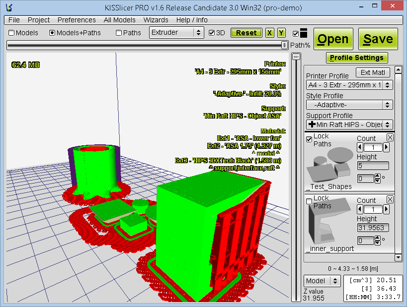

The minor UI thingie with Mac: after switching back and forth virtual desktops, the tooltips are shown behind the settings window (most of them becoming invisible, but hovering over `delete` button, for example, shows half of the tooltip, not obscured by the settings window). Goes away after reopening settings window.
What is "lock paths" functionality? (yes, I have a pro, but couldn't find it. Maybe I don't need it, but I'm curious
And speaking of curiosity, this Dock vs Fix settings window, is it because it's harder to implement "proper dock", or is it a deliberate? It's unimportant but if it's not because of the effort it takes, I'd love to have an option to properly dock it, but if it's due to toolkit limitations, I sure wouldn't insist on spending any significant time on it.

Re: KISSlicer 1.6 RC 2 is here! (UPDATED 2017-08-30)
Slice a model with one style, "Lock Path", add another model and that can be sliced with different style/settings.hacker wrote:What is "lock paths" functionality? (yes, I have a pro, but couldn't find it. Maybe I don't need it, but I'm curious)
Do you think we will ever see this layer by layer, extruder by extruder, mesh by mesh?pjr wrote:Slice a model with one style, "Lock Path", add another model and that can be sliced with different style/settings.hacker wrote:What is "lock paths" functionality? (yes, I have a pro, but couldn't find it. Maybe I don't need it, but I'm curious)

Got it, thanks, Peter.pjr wrote:Slice a model with one style, "Lock Path", add another model and that can be sliced with different style/settings.hacker wrote:What is "lock paths" functionality? (yes, I have a pro, but couldn't find it. Maybe I don't need it, but I'm curious)
To add to Peter's answer, if you load many models, you can set Count to 0 on some of them and they will remain loaded, but not show on the bed or get sliced. Once you slice the first one (or group), you can check the Lock Paths box in the top left of each model tab, then set the count of the unsliced models to >= 1, select a new style, and slice again. Etc. There is a lot you can do with this, and of course there are also many ways to do something weird. KISSlicer will use the current printer settings when exporting, so changing the printer profile after locking paths probably doesn't make sense (though someone will undoubtedly find an awesome way to do exactly that. [8^)pjr wrote:Slice a model with one style, "Lock Path", add another model and that can be sliced with different style/settings.hacker wrote:What is "lock paths" functionality? (yes, I have a pro, but couldn't find it. Maybe I don't need it, but I'm curious)
One other note: the object packing on the bed is performed using current settings, so if you are changing things like raft or support inflate, you probably want to slice the models with the least inflate first, so their rafts or supports don't end up overlapping.
In the attached picture you can see I sliced "Test_Shapes" with support disabled, locked the paths, then sliced "_inner_support" with support enabled.
