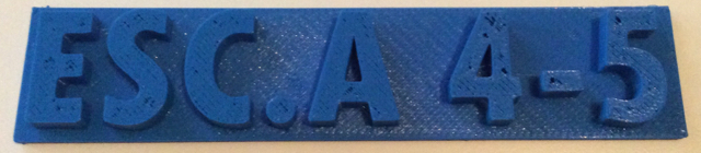

Ros
Posts: 42
Joined: 06 Dec 2014, 10:50
Location: Sabadell, Catalunya
Re: Help, something wrong with layers
Post by Ros »
This is the new print and... Almost what I want... Almost...
How can I solve this holes on the surface?
Hugues
Posts: 126
Joined: 11 Nov 2014, 03:40
Re: Re : Help, something wrong with layers
Post by Hugues »
The "cloncks" can be done by Min jump and trigger value in the material tab. Put 15 in the two, I didn't find which one is the cause but since I put higher value i've less sound like this.
For your hole I would purpose to increase your %solid but you're at 110... Maybe increase the infill or the thickness
regards,
Hugues
www.cubexupgrade.com

Add more thickness to top/bottom layers and/or try lowering the temperature a bit?
