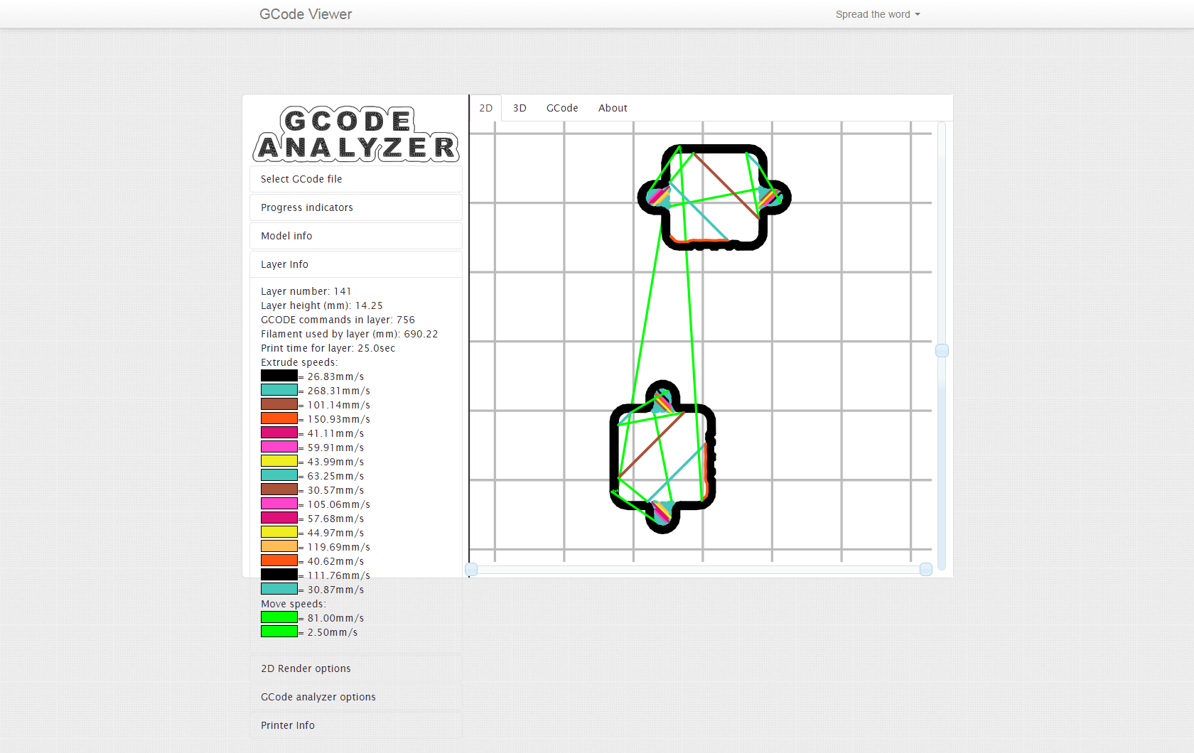

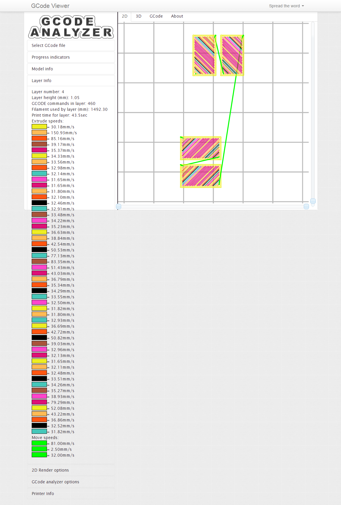

Just made a short test in 0.2 mm layer height, i get the same issue with too high speed.
Forget to says that my %infill and %solid are setup to 100%, they should not give 3 times the setup speed...

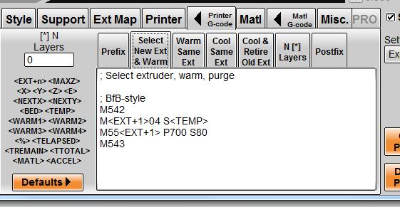

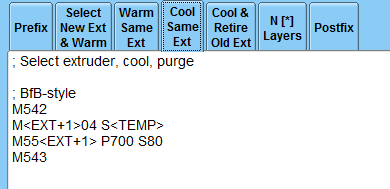

In your first files I can see that you forgot to adapt the G-Code in Kisslicer (Printer G-code Tab). It is important to set al three tabs ("Select New Ext & Warm" , "Warm Same Ext" and "Cool Same Ext") up with the same content:
; Select extruder, warm, purge
; BfB-style
M542
M<EXT+1>04 S<TEMP>
M55<EXT+1> P700 S80
M543
Otherwise the speed for extrusion won't be saved to the bfb-file which makes it impossible to figure out where the high speeds are coming from.
Once you have done that, can you please slice&save it again for both, 0.1 & 0.2mm ? It would be great if you could then do the same without stacking ( I can not compare your stacked outputs with mine since the normal Licence doesn't alow stacking).
And have you seen the language file that I've posted earlier? Could you try to change your language in Kisslicer to this file and check if your %Infill Box is showing up again?

Once again, don't forget to check the "Printer G-code" Tab.

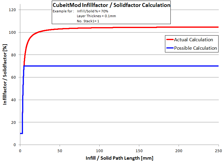

I found something that I want to discuss with you and everybody else who is interested in this topic (best would be to talk to Giovanni if possible). It is about the Solid- and Infillfacor Calculation done in CubeitMod. The way the calculation is set up, it is not possible to get a Solid or Infillfactor higher than 105%. The other thing which makes me wondering if it really should be like this is: If you set Solid or Infill to below 100% this will only affect short Solid and Infill Paths. The higher the Solid/Infill length is the higher the Solid and Infillfactor gets, up to the maximum at 105%. I plotted the calculation to show what is happening. The example is for 70% Infill% or Solid%, 0.1 Layer Thickness and no Stacking. You can see that Solid and Infill will only be decreased to 70% (or below for the acceleration/deceleration compensation.....) if the path is shorter than 4.75mm. For paths longer than 4.75 Solid and Infill increase more and more (100% at 22.25mm, 104% at 92.2mm). Should it really be like this or would it make more sense to limit Solid and Infill to whatever you set in Kisslicer? The second Trendline shows how it would look like if the Factor really would be limited to the setpoint in Kisslicer. Please have a look at this and let me know if you want to test a CubeitMod-Version that does the limitation.
