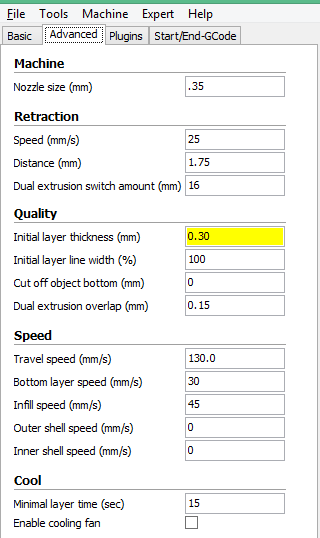

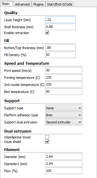

Thank you for taking a look. Where is Cura getting extrusion width 0.44? Below are Cura's extrusion settings from the Advanced and Basic tabs. Notice in the Advanced tab I have "Initial layer line width" set at 100% so I'm not trying to inflate it:

- Cura Advanced Settings - 1st Layer Line Width.PNG (14.89 KiB) Viewed 6017 times
- Cura Basic Settings.PNG (16.2 KiB) Viewed 6017 times
