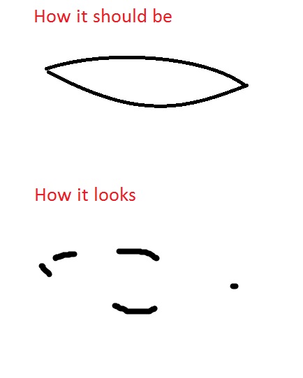

But the seam problem remains. I still can't send a pic of it, but I can try to describe it:
Basically when the orinter should print a seam, instead of printing a line it's printing some dots on where the line should be. But it only happen on those two thin shapes.
I upload a sketch there I try to describe it.

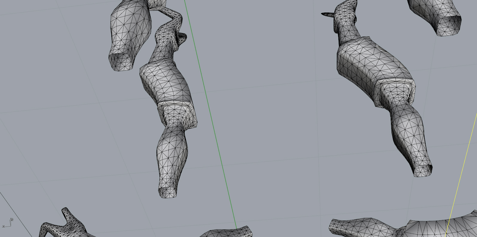

How do you test you seam setup ?
I just open your file and they are not really printable ! there is lot of error on it.

All shapes are open, true you can slice them but result may be weird. Close them all.

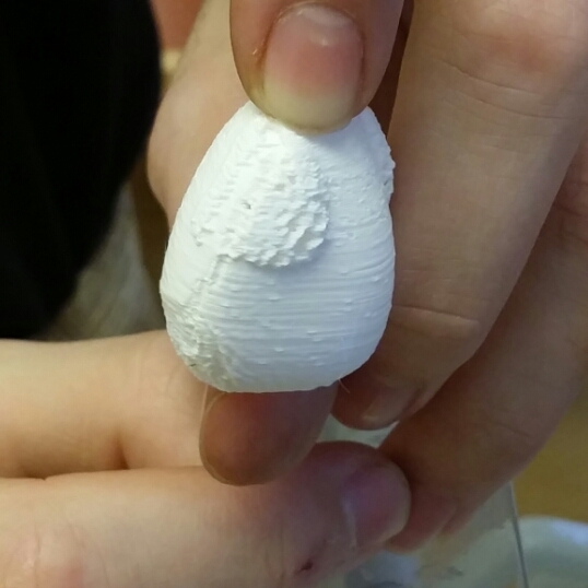

I finally got a picture of the problem!
As you see the surface is generally a little bumpy, and when it comes to the eyes... :shock: :shock: :shock: ... it doesn't look that good.
I'm sure it doesn't depend on the model since the most of the printing is very accurate.
