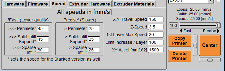

Hugues
Posts: 126
Joined: 11 Nov 2014, 03:40
Re: What does this message mean?
Post by Hugues »
Sorry, i don't understand the question but this is my setup, it can help you
regards,
Hugues
www.cubexupgrade.com

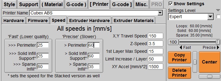

Miatpi
Posts: 32
Joined: 15 Jan 2015, 07:05
Post by Miatpi »
Hmm, thats pretty much how I had my settings. These are the ones I use right now

Post by Hugues »
No, you inverted Precise/Fast. Copy my setup exactly, it will work

I dont really understand. What if I ask like this:
Here are the three places I can see that change the fast/precision
and I call them 1, 2 respective 3.
And my questions are the following: Which of 1,2 and 3 do I have to increase to get a more precise print and which do I have to increase to have a faster/less precise print?
Hugues
Posts: 126
Post by Hugues »
1. setup 1 and 2. 1 is the target speed for fast print and 2 the target for precise print
2. Slide the box 3 to precise or fast (depend of what you want), in you case precise
Personally i don't use the slider, it's setup on precise and i prefer modifying the precise section.
regards,
Hugues

Hugues wrote:1. setup 1 and 2. 1 is the target speed for fast print and 2 the target for precise print
Sorry for being so slow learned :oops:, but if 2 is the target speed for precise print, why shouldn't I increase it? In the settings pic you sent you had set the 1 settings to 45 and the 2 settings to 25. To me it sounds that you have increased the speed and lowered the precision. Where am I thinking wrong?

Post by Hugues »
Because in the box 1 and 2 you setup the speed mm/s....
and with the slider you setup the balance between precise and fast
regards,
Hugues
