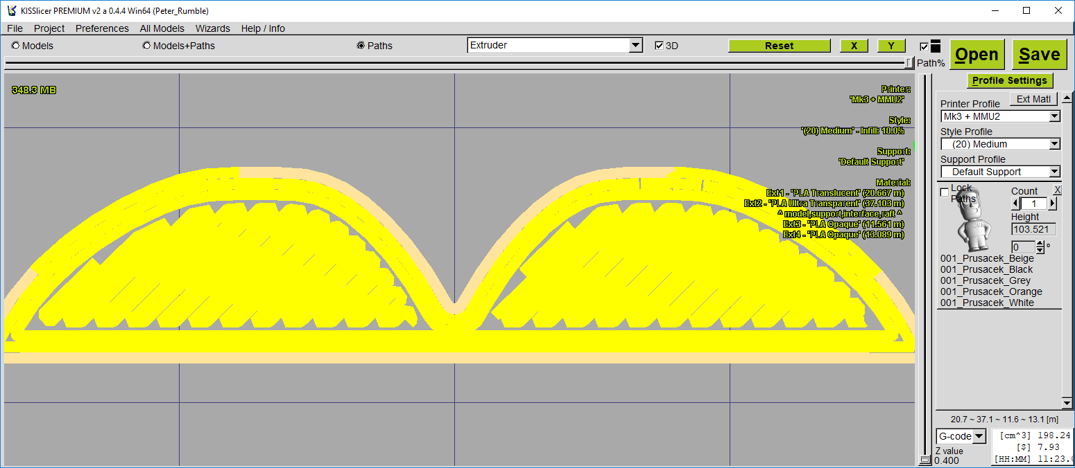

Layer 1:

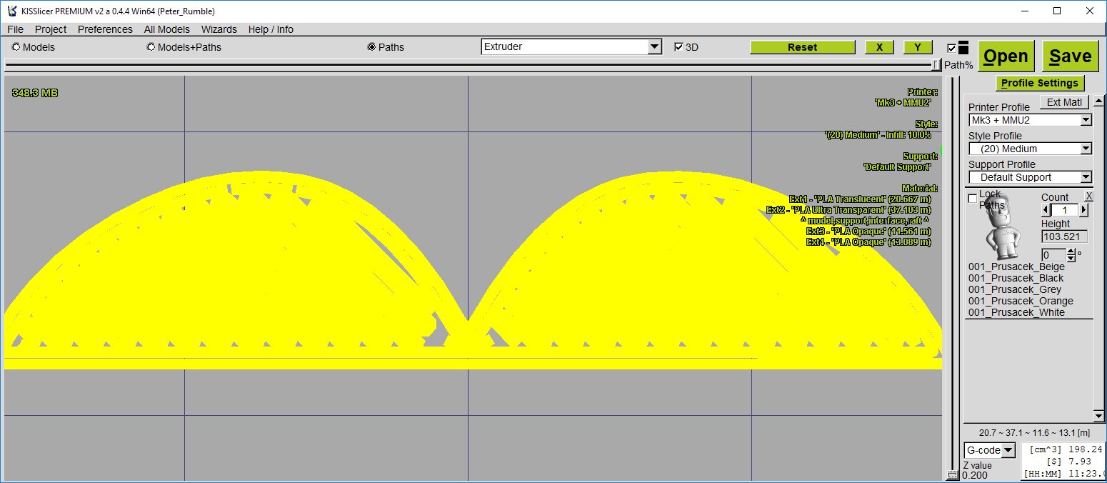

Layer 2:
To me, the first layer looks about how I would expect, whereas layer 2 does not.
