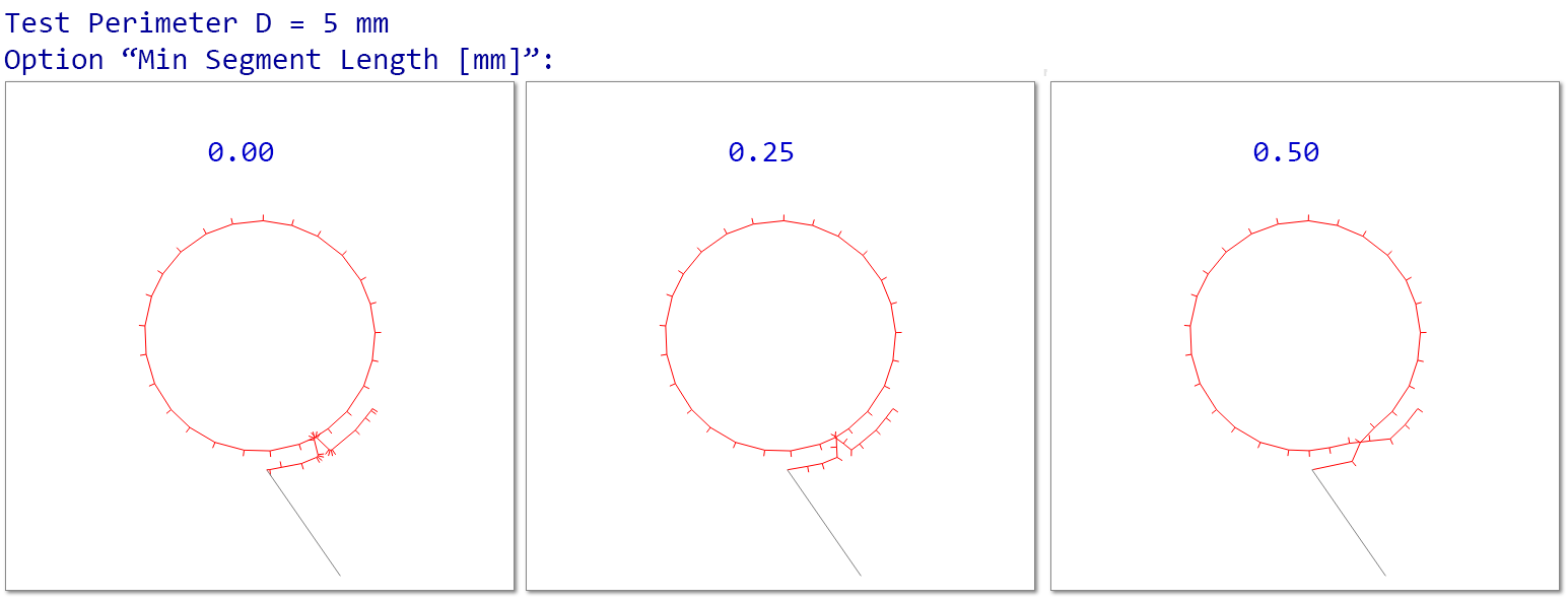

I maked 3 gcode-files in KISSlicer and visualise Perimeters.
Length of segmets in radial path: 0.62 - 0.75 mm.
Look to difference at picture below please (short perpendicular lines is markers end/begin of segments).
- min_seg_len.png (21.99 KiB) Viewed 2558 times
