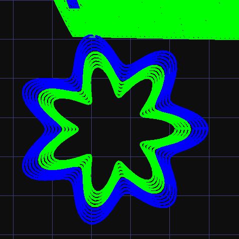

Prime Pillar prints on the edge of the part when Misc./Print Order is set to Simultaneous or Model Tab Order. Sequential prints fine.
