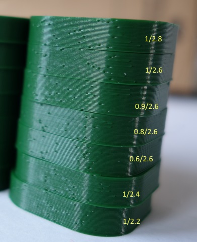

That's pretty much where I left off testing/tuning; I left the depth and gap set to 0.8/0.2, turned on Join-Loop and started printing.

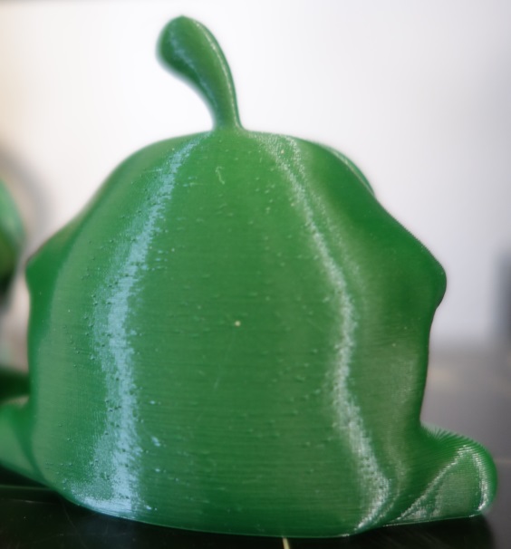

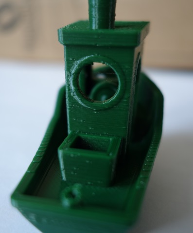

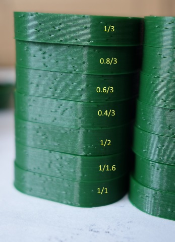

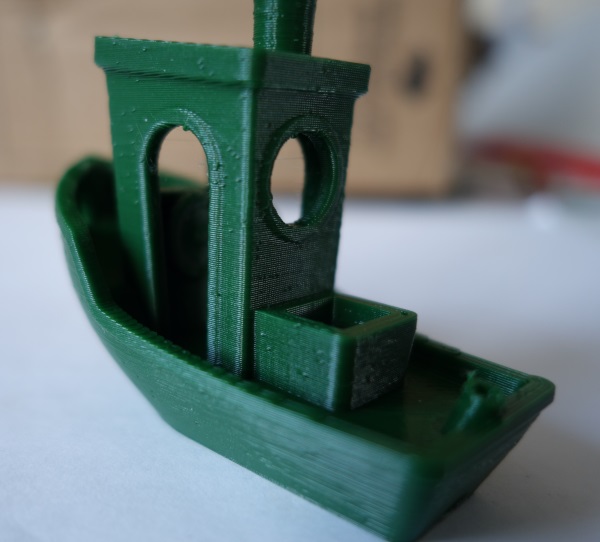

I also want to print only, but the results forced me to test.
I am used to the fact that when values are changed, at least one tendency can be seen.
So I test some more rounds. It would be something sobering that no better result
should be achieved.
Maybe I'm doing something wrong, or my expectations are some way off.
Maybe someone is so kind and prints the tuning part (0.2 scaling in Z, 200m Layer, 3.5 Perim, Loop1> Perim, 0.6 Skin, 10% rounded infill) with hers/his settings
and insert some pics
