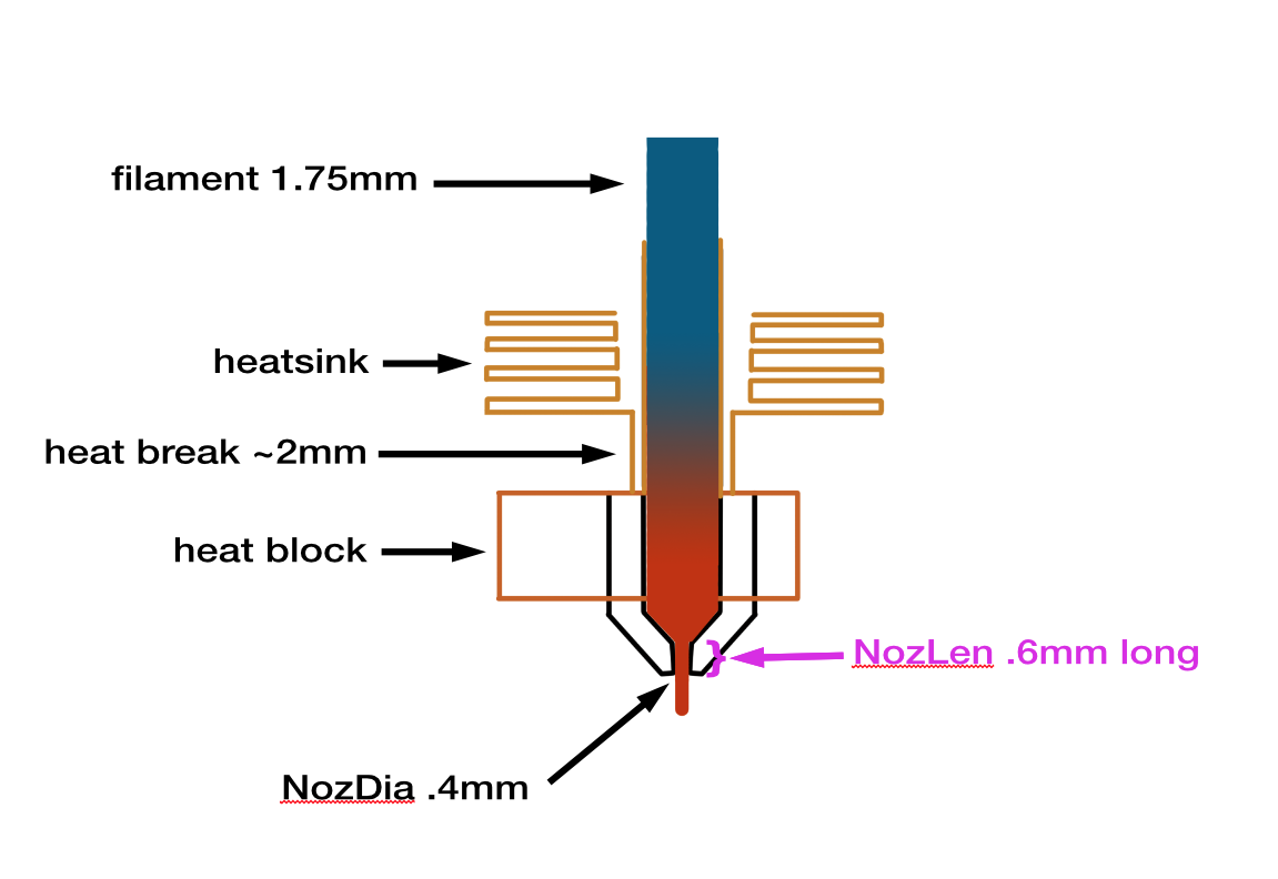

I wanted to double check my bore length but I'm not 100% sure what is being asked for here. Is this in essence the length of the threaded part on the nozzle? Is it the diameter? Is it the nozzle and heatbreak? The profile I have has these filled in for a typical prusa setup but I run microswiss nozzles and wanted to do my own measurements.

There are 3 parameters you need:
NozDia - this is the published diameter of your nozzle's bore. E3D V6 default nozzle is .4mm. Rostock MAX HE280 hot end default is .5mm
NozLen - this is the length of that bore inside the nozzle
DrvLen - this is the distance from where the extruder's drive gear engages the filament to the tip of the nozzle (technically, it does not include NozLen but that little difference is not important. A value within a few mm of actual is fine for this.)
Screen Shot 2017-10-20 at 10.17.21 AM.png (94.47 KiB) Viewed 8294 times

Thanks. A picture always helps. However, if I'm interpreting noz length correctly, I'm mearuing at least 2mm on both my E3D nozzles and my Microswiss nozzles. I'm measuring from the square part of the nozzle to the tip. Is that correct?

If your E3D is a .4mm nozzle, it's nozlen is .6mm - that is a fact.
This is something you can't really measure from the outside. There is a technique to indirectly measure it - the "cold pull" test. But in the case of E3D, they publish the bore length (NozLen) of their nozzles. I'm not sure what you mean by the square part, keep in mind that inside the nozzle there is a taper from the nominal filament diameter to the bore diameter. This tapered section is not part of the NozLen.

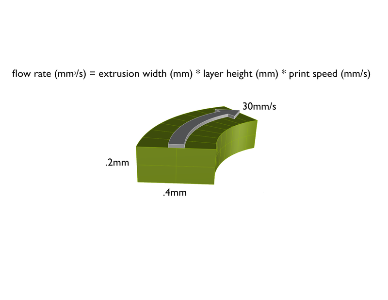

There is a theoretical max for flow rate so you don't want to go above that or you will clog your hot end. An E3D V6 hotend with .4mm nozzle printing .4mm x .2mm layers is right around 10mm^3. That's likely where the "10" came from. That is a safe place to start. It will move fast to achieve that high flow rate! My flow rate video will go into more detail but flow rate is dependent on the filament, its extrusion temp (which is why you do that first) as well as layer height, layer width and print speed. The formula is:
layer height (mm) * layer width (mm) * print speed (mm/s) = flow rate (mm^3/s) at a given extrusion temperature.
Here's a graphic I made to use in the tutorial I'm working on:
