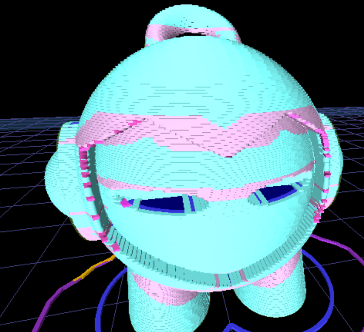

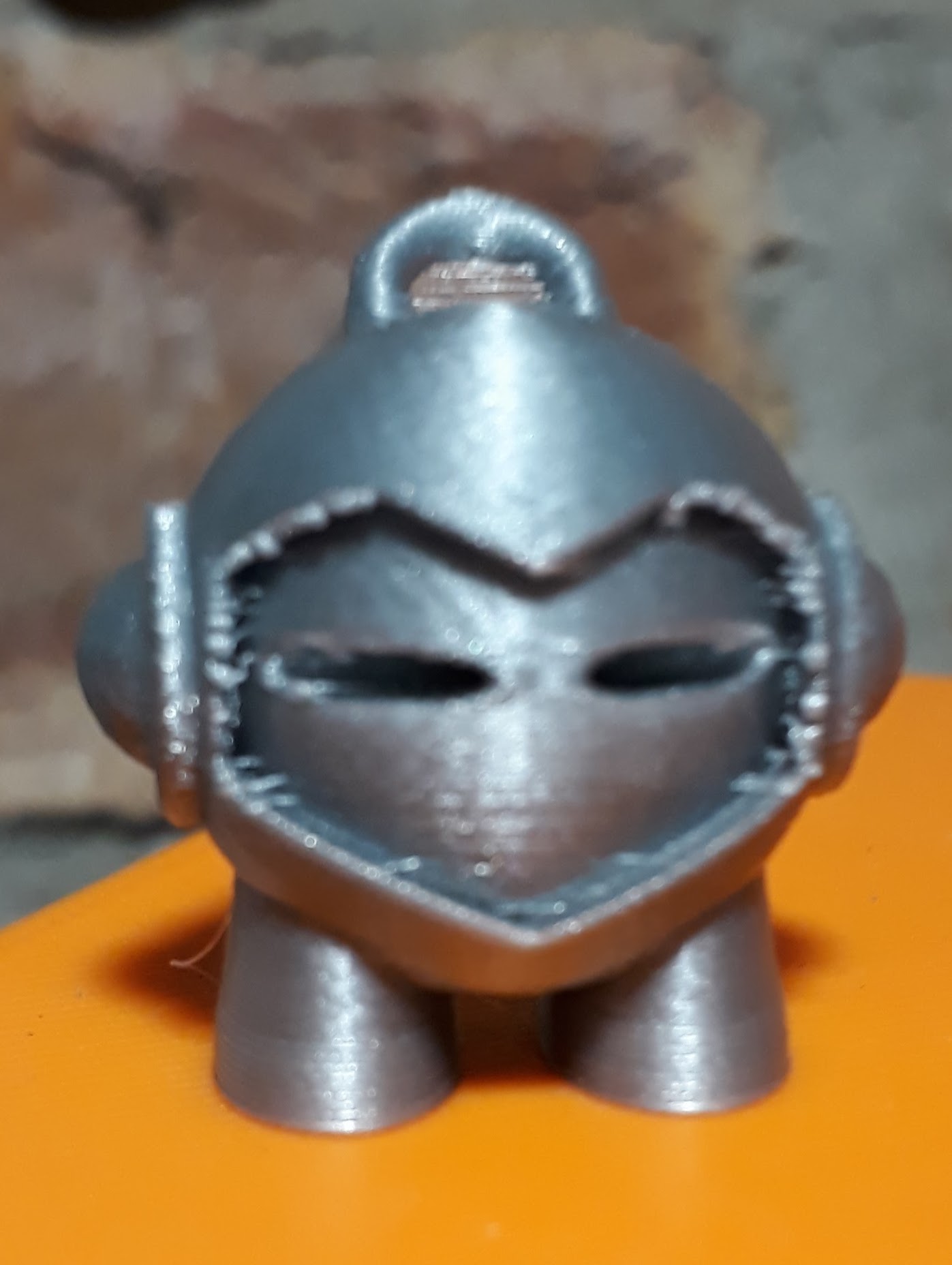

Thanks, that makes sense. Of now I've tuned preload i thought I would print a Marvin. I seems to be getting artefacts around the mask
These seems to correspond with the dark purple blobs on the preview. What setting would help to control these?
Re: Preload wizard - what am I looking for?
The hot pink spikes on either side of the face are crowning trying to fill in plastic...in this particular case it's better not to have crowning there, since it is visibly different from the layers above and below. In my working build (not released yet, but will be in the final 1.6 release) I have made the crowning threshold a setting in the style tab, and also made it settable for FREE users. For my Marvin prints I believe I have the threshold set to 3mm to keep crowning out of those regions.
