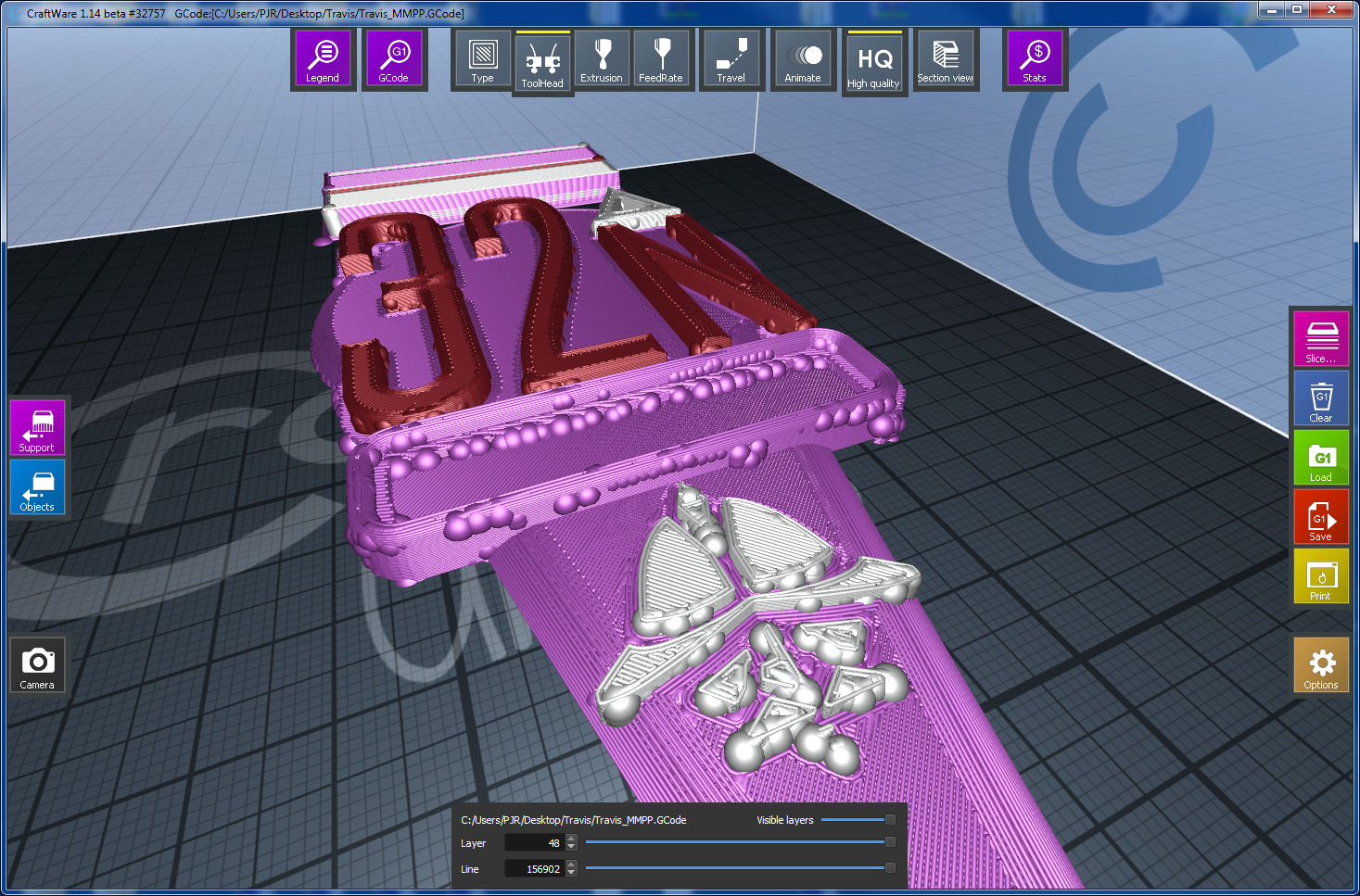

@funBart
You seem to be very aware of the capabilities of Craftware... It does look really good as a GCode previewer, but it looks like it has problems with KISS PreloadVE:
Any thoughts?
TIA

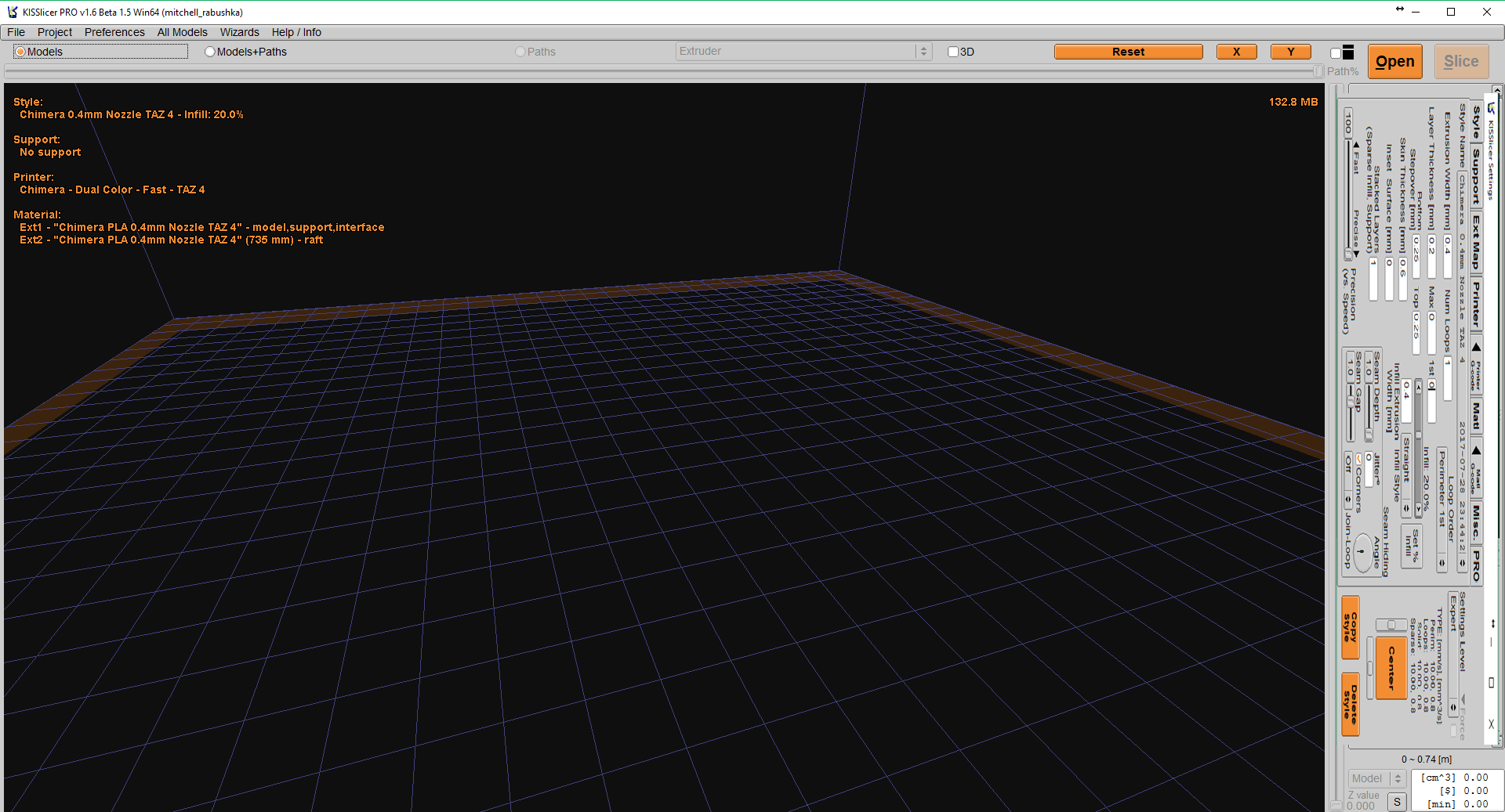

It will free up total viewable space of the print platform while working with the settings window and give a cleaner looking UI if the setting window could be reformatted into more of a vertical layout that snaps into the right side vertical column that currently has a lot of blank space:
Vertical Settings Layout

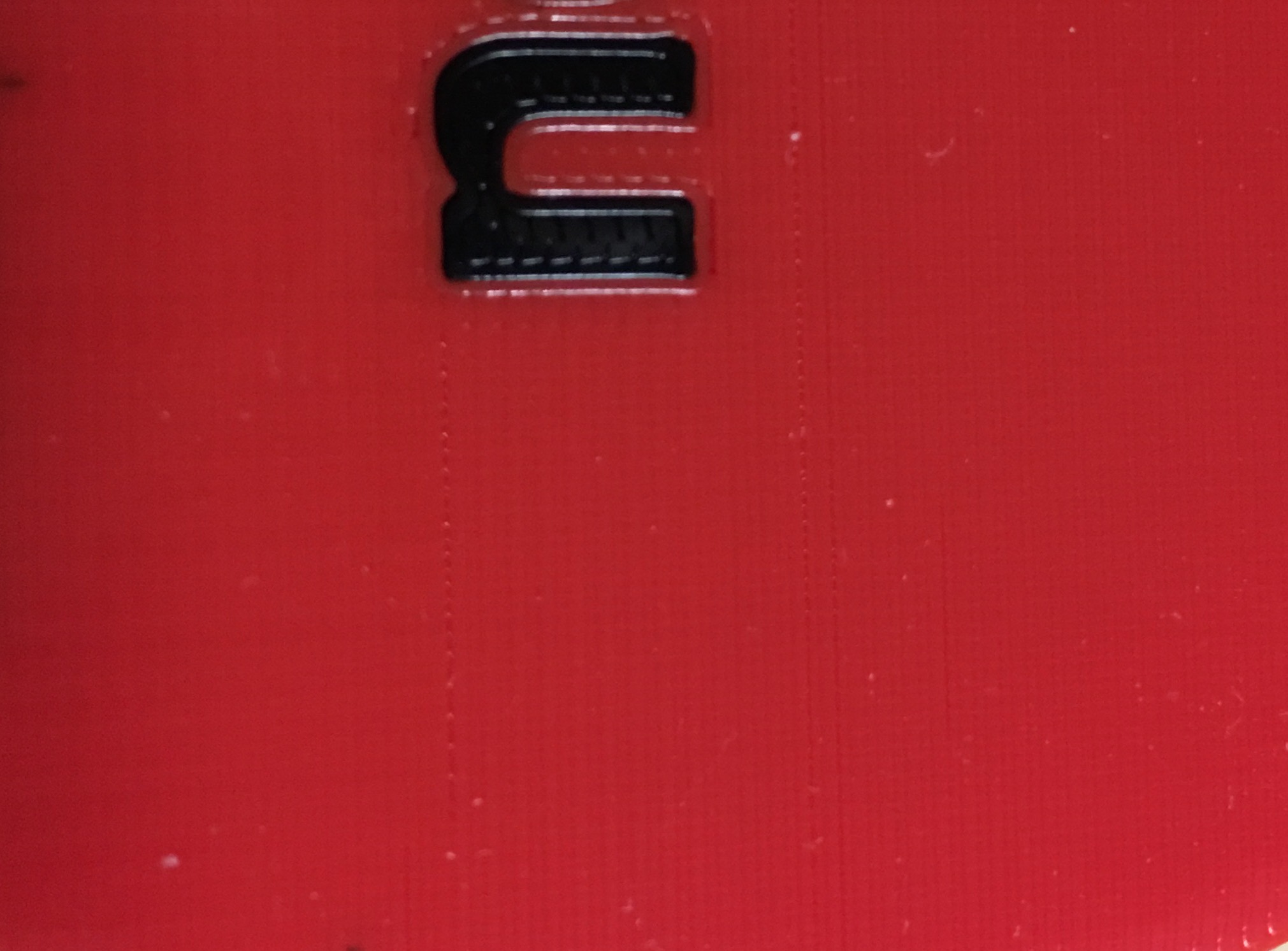

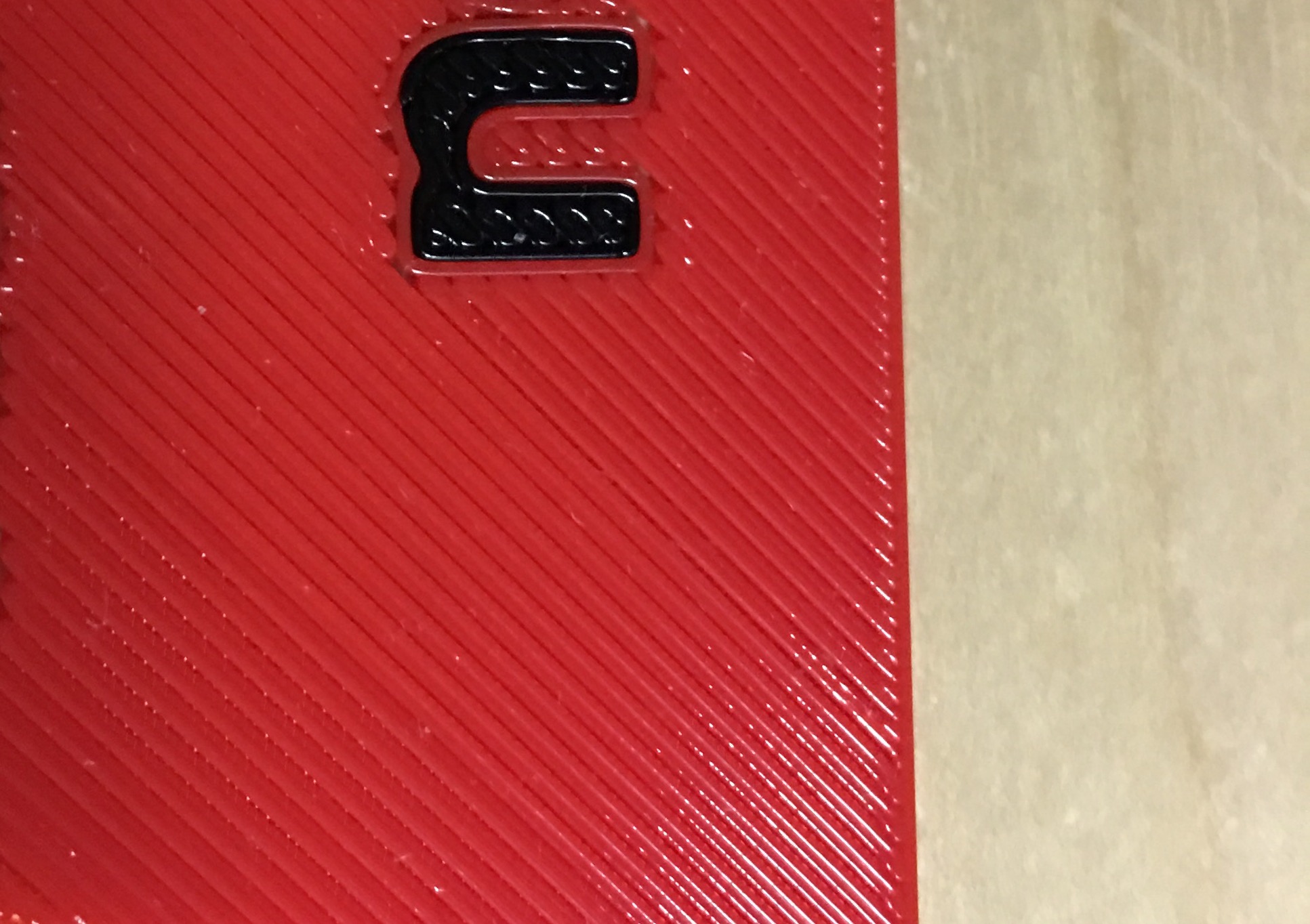

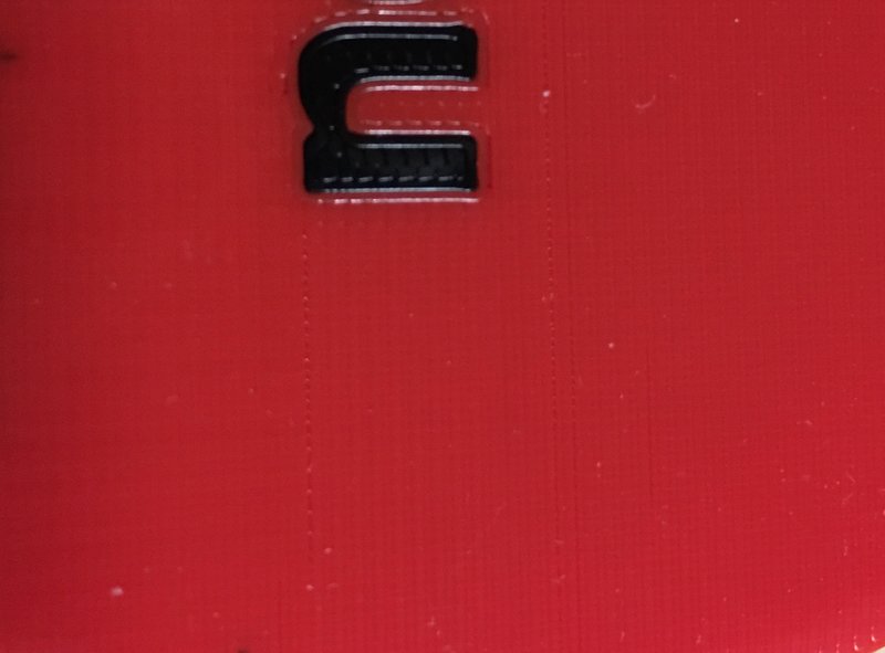

The aesthetics of printed parts can be improved if the direction of the layer lines is adjustable. For example I'm printing a part where it is desirable to have the layer lines print parallel with the text:
Diagonal Layer Lines
Horizontal Layer Lines
Along these same lines it will be helpful if parts can be rotated. When packing parts KISSlicer could offer the most efficient configuration, but then allow the user to rotate the parts so the layer lines print in the desired direction for all the parts.
