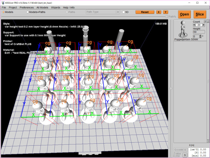

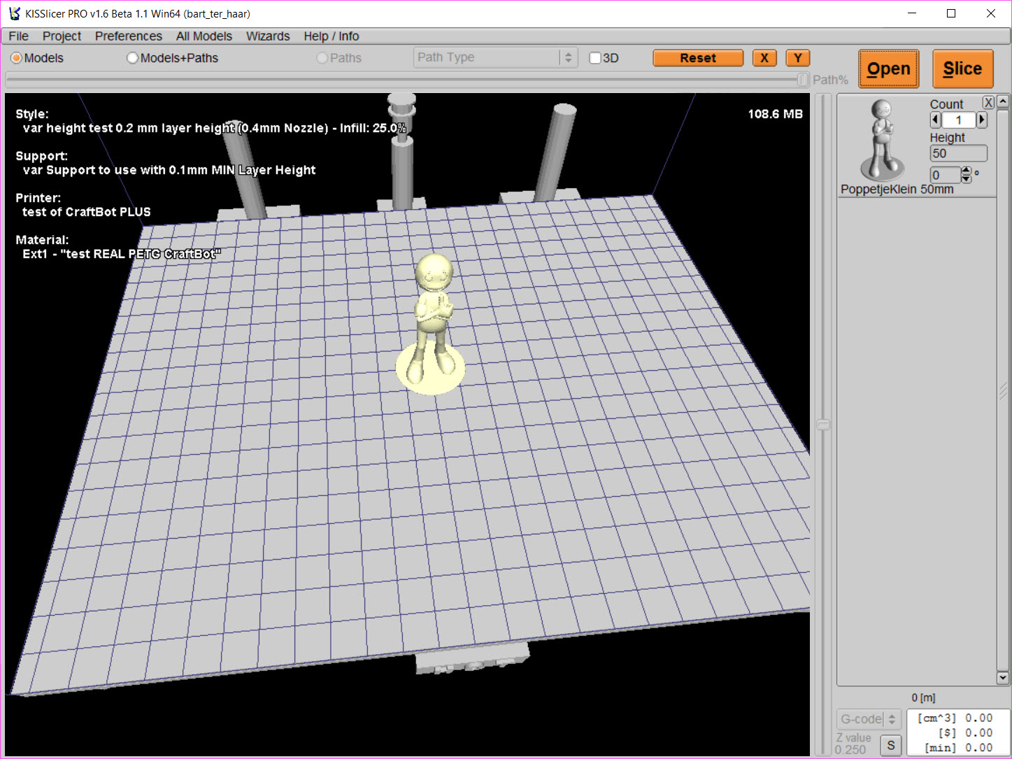

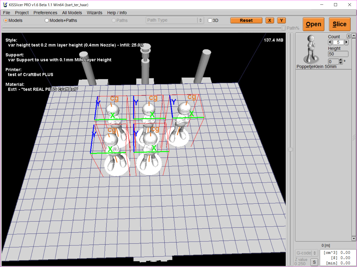

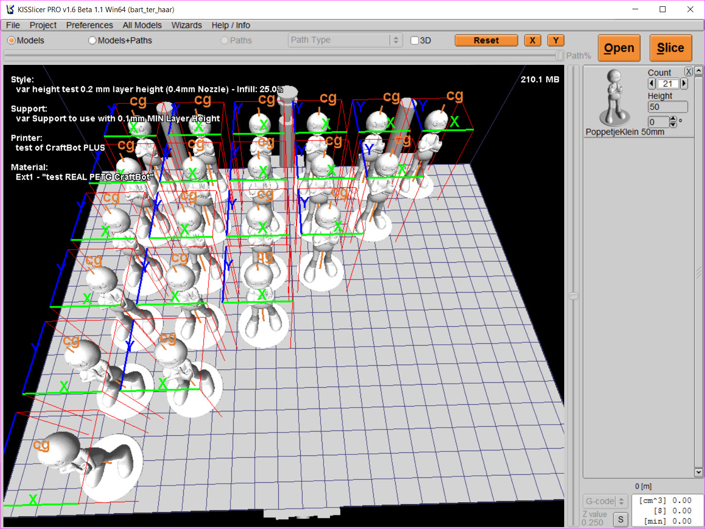

I don't think it was like this with previous KS versions, but when multiplying objects it would be nice all was centered (see example above 20):
And if outside the build volume it would be signaled.
Bart ter Haar

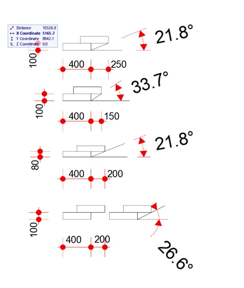

unnamed (3).jpg (45.26 KiB) Viewed 6150 times
Given a min layer height there is a threshold were support needs to be generated. For example with 0.1mm min height it's needed from 37,6 degrees.
For all combinations between nozzle size (or path width) and the given min layer height there is an exact angle from were the support structure needs to be generated.
Free thinking: with that in mind the min and max layer height belong actually to the support tab, and not the style of printer tab. ;-)
So when using a switch on the style tab: using stepping over / var layer height or not : than on the support tab there are the original values visible, or the settings belong to nozzle size / path width and min / max layer height.

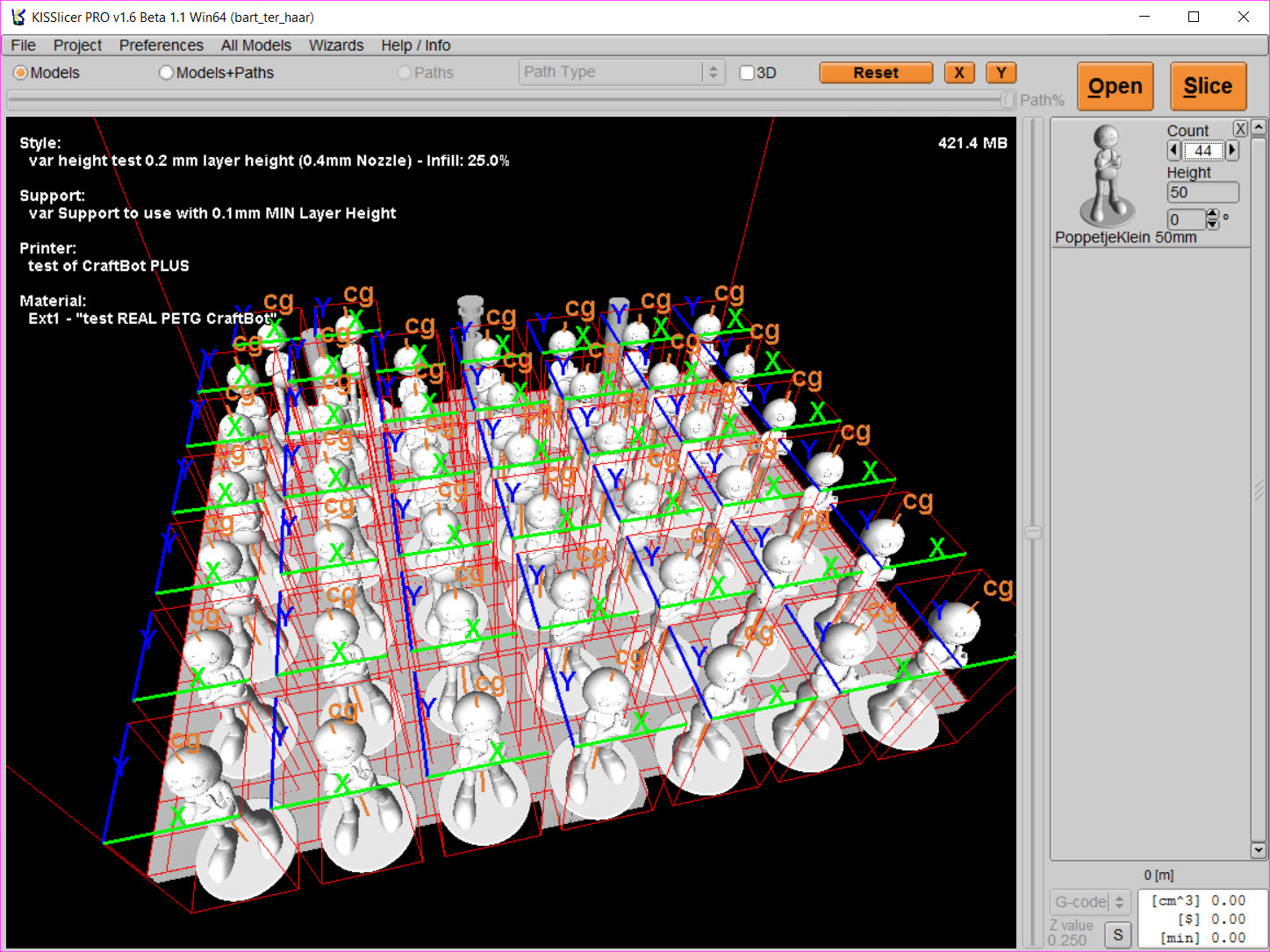

When you load multiple stl's on the KS bed, than each one gets sliced according the min and max step over set set on the style tab. That's already great, as it saves a lot of time this way!
But when you load a single stl (with a lot of islands or objects) than it's sliced with the threshold set on the style tab for all objects, with the min / max threshold aplied for all.
Of course it's a question of the hungry Caterpillar, but for the future it would be nice that the min/max layer of the stepover would be applied to each single mesh, or -better?- to each individual print island.

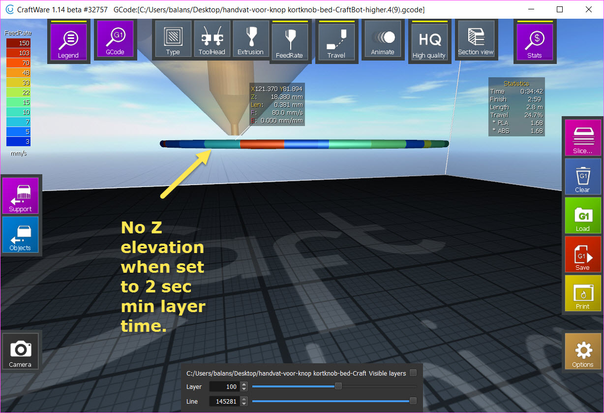

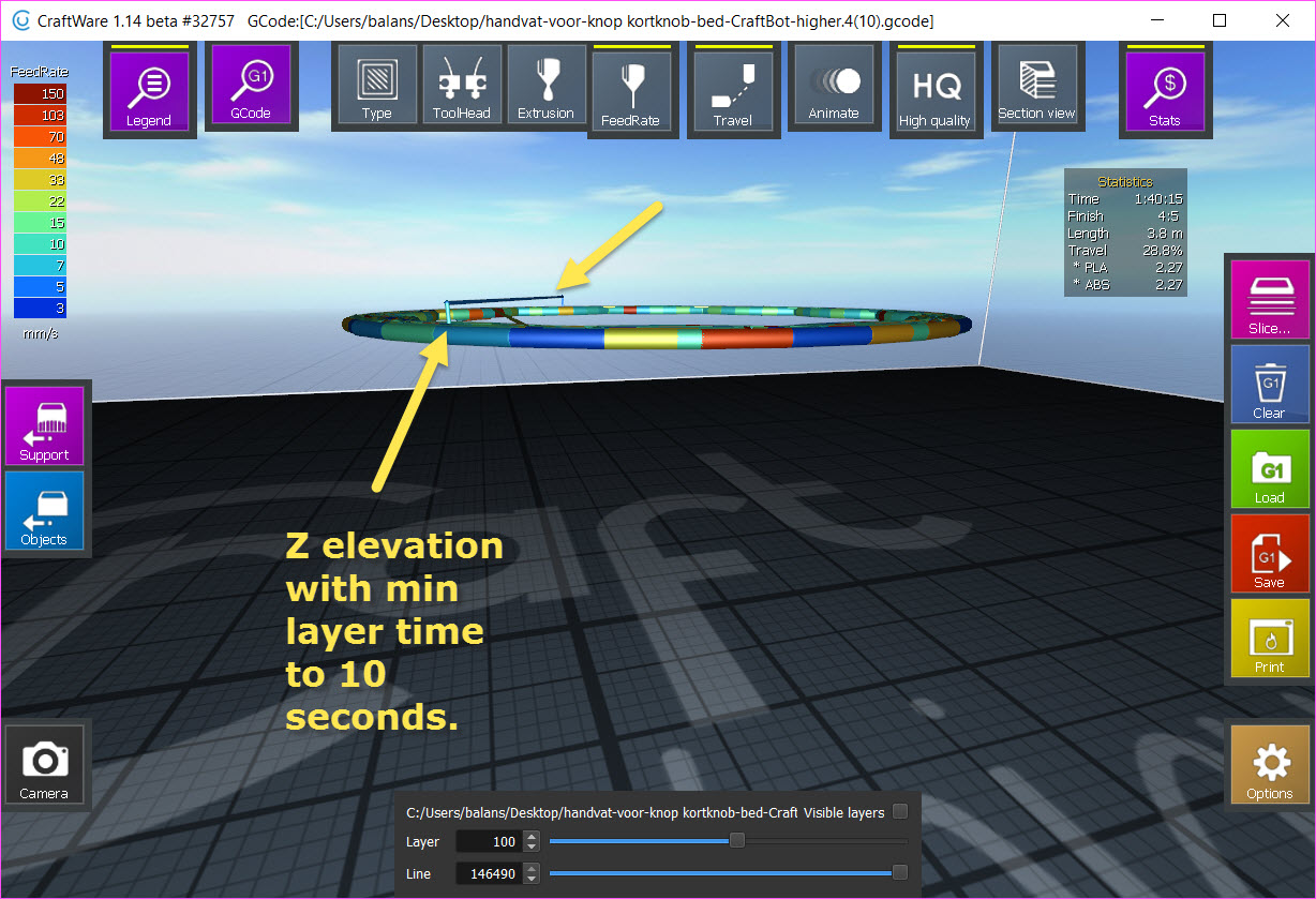

It seems that when setting the min layer somewhat higher there is also a Z elevation applied. Also some slow start for that layer that's under the min layer threshold.
Hereunder the differences between two gcodes with the only difference the min layer. First 2 second min layer time.
The second 10 seconds min layer time.
Of course it's good when the min layer time is causing the speed to slow down. but when too slow, than it's not good either as the nozzle is radiating to much heat to the print.
It seems that the min layer time now is causing slowing down and above a threshold also is causing a Z lift.
But if so, than a setting for that would be nice, as it's
1: causing a Z elevation, but not enough
2: causing some inconsistent print speed
Bart ter Haar
CraftBot PLUS support: https://www.CraftBot.nl

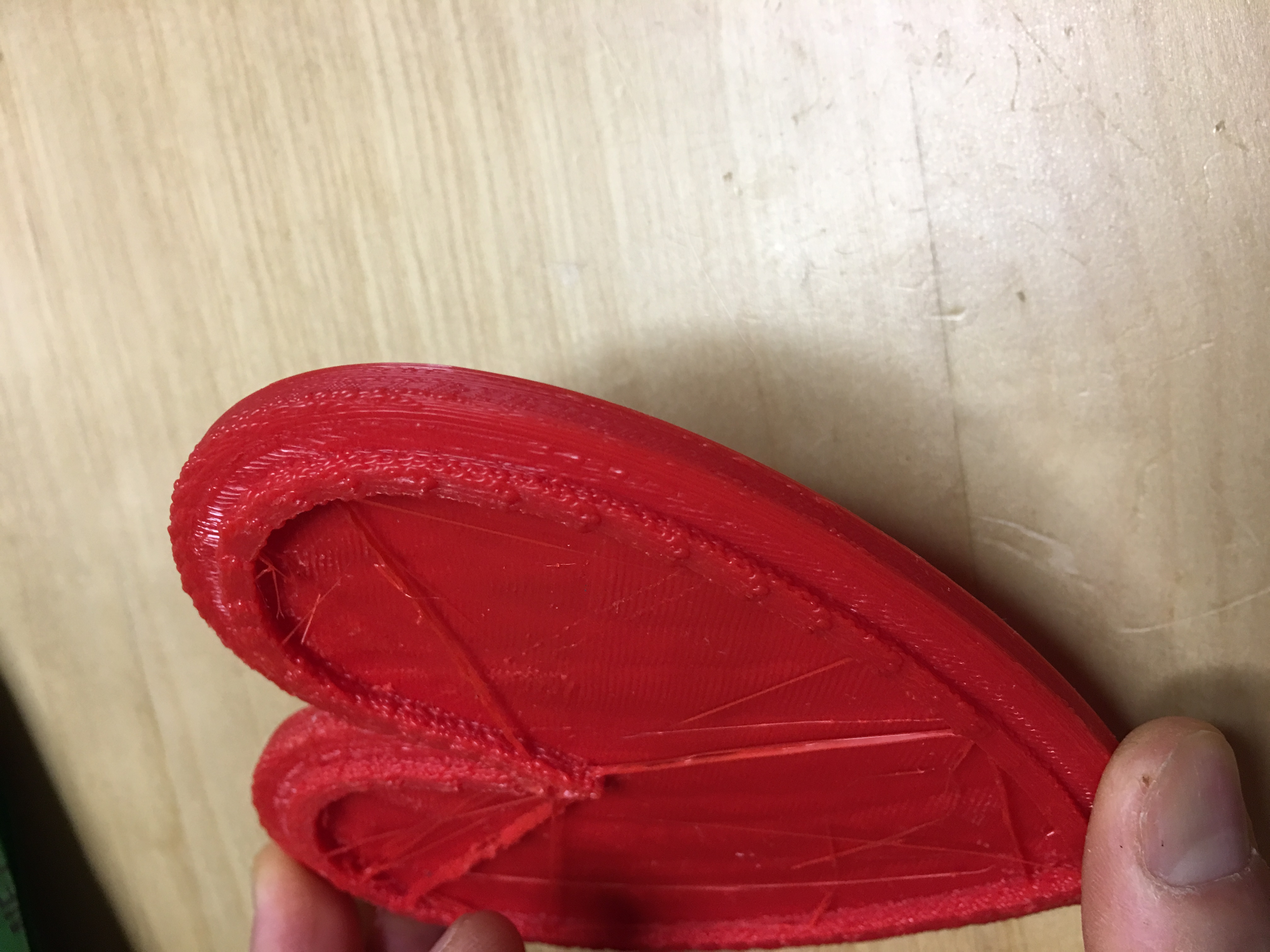

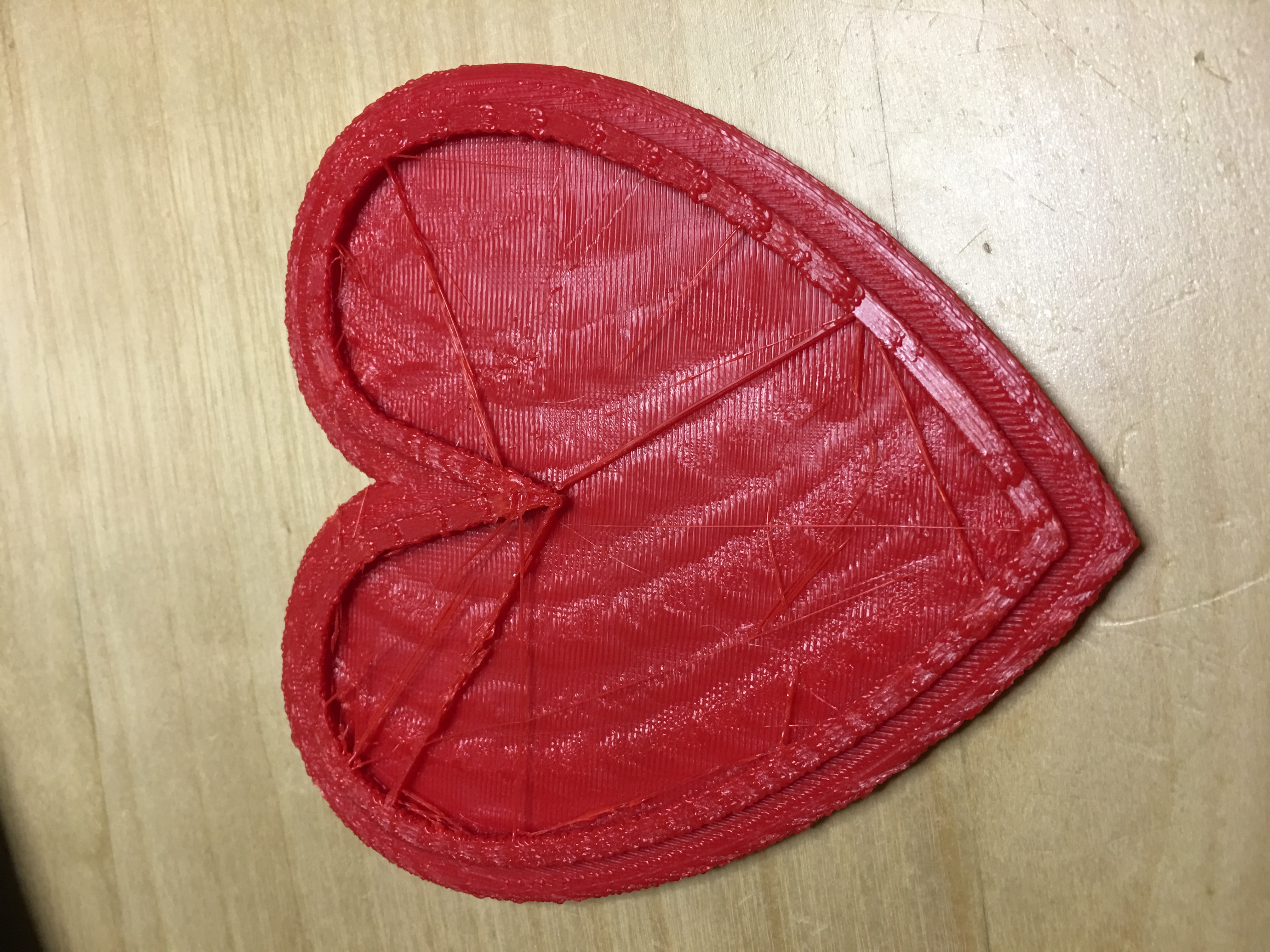

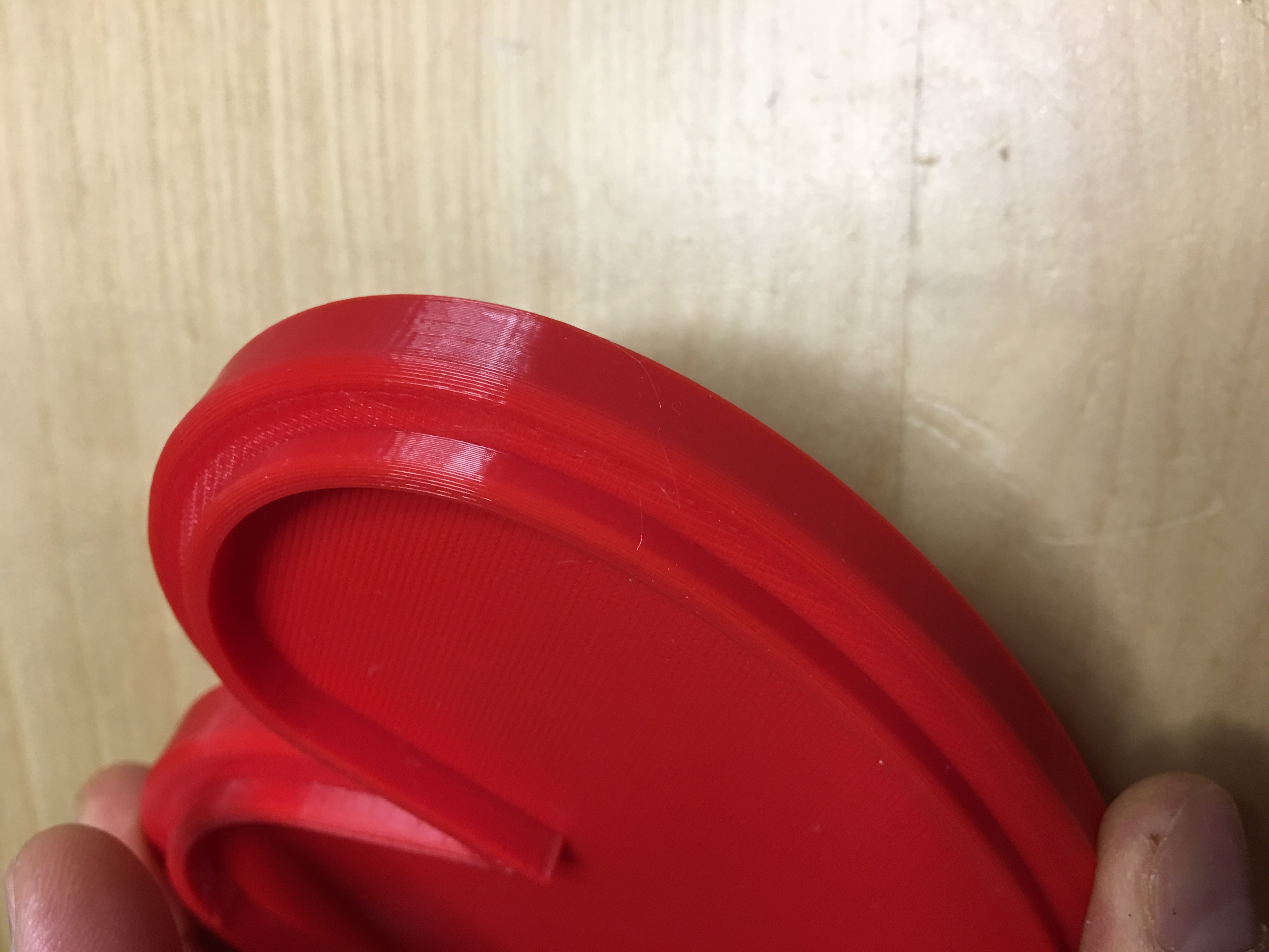

1.6 Beta 1.1 - Under Extruding / Strange Behavior
Pic 1 1.6 Beta 1.1 - Top of Heart - Strange Behavior
Pic 2 1.6 Beta 1.1 - Side of Heart - Strange Behavior

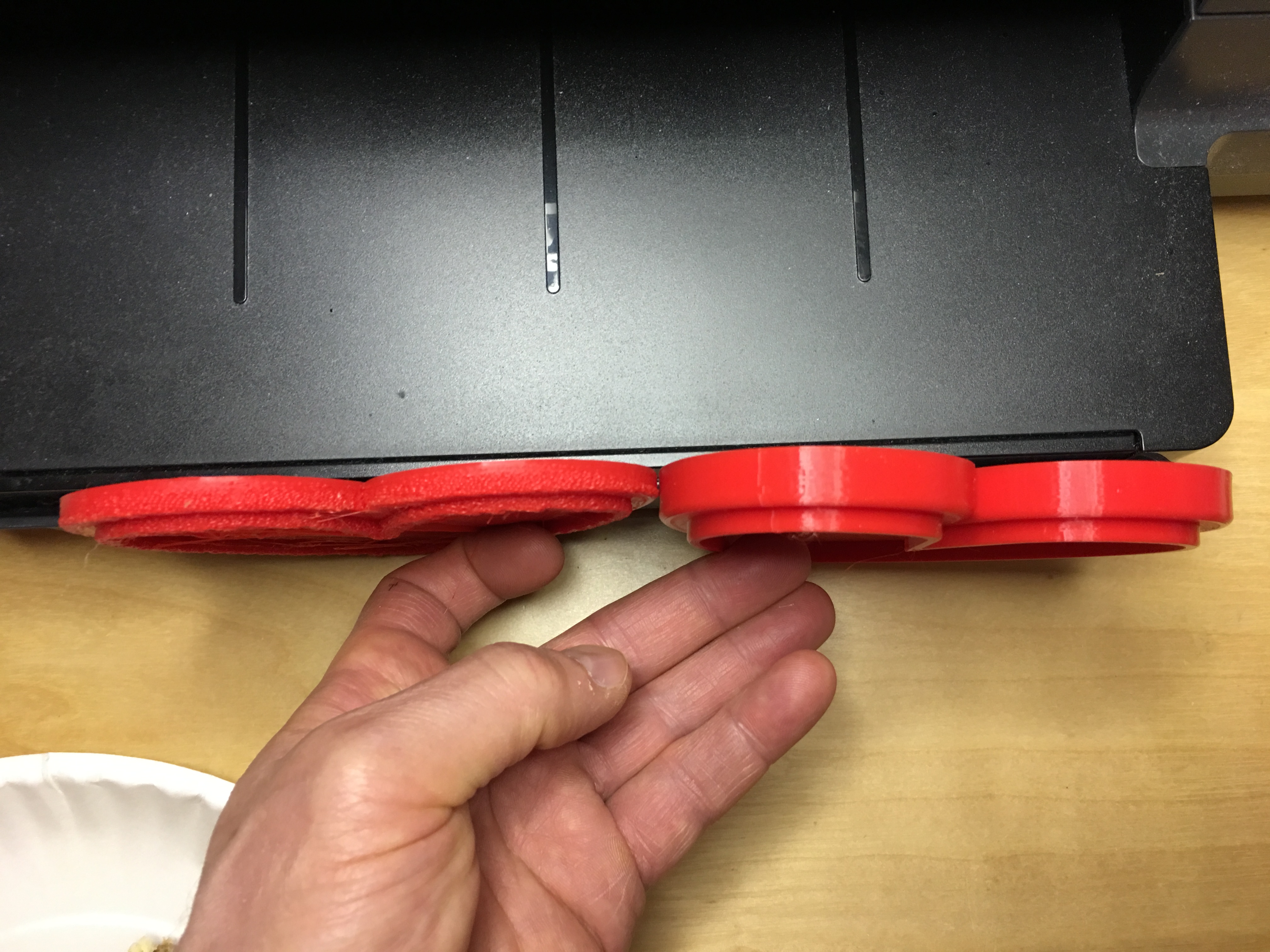

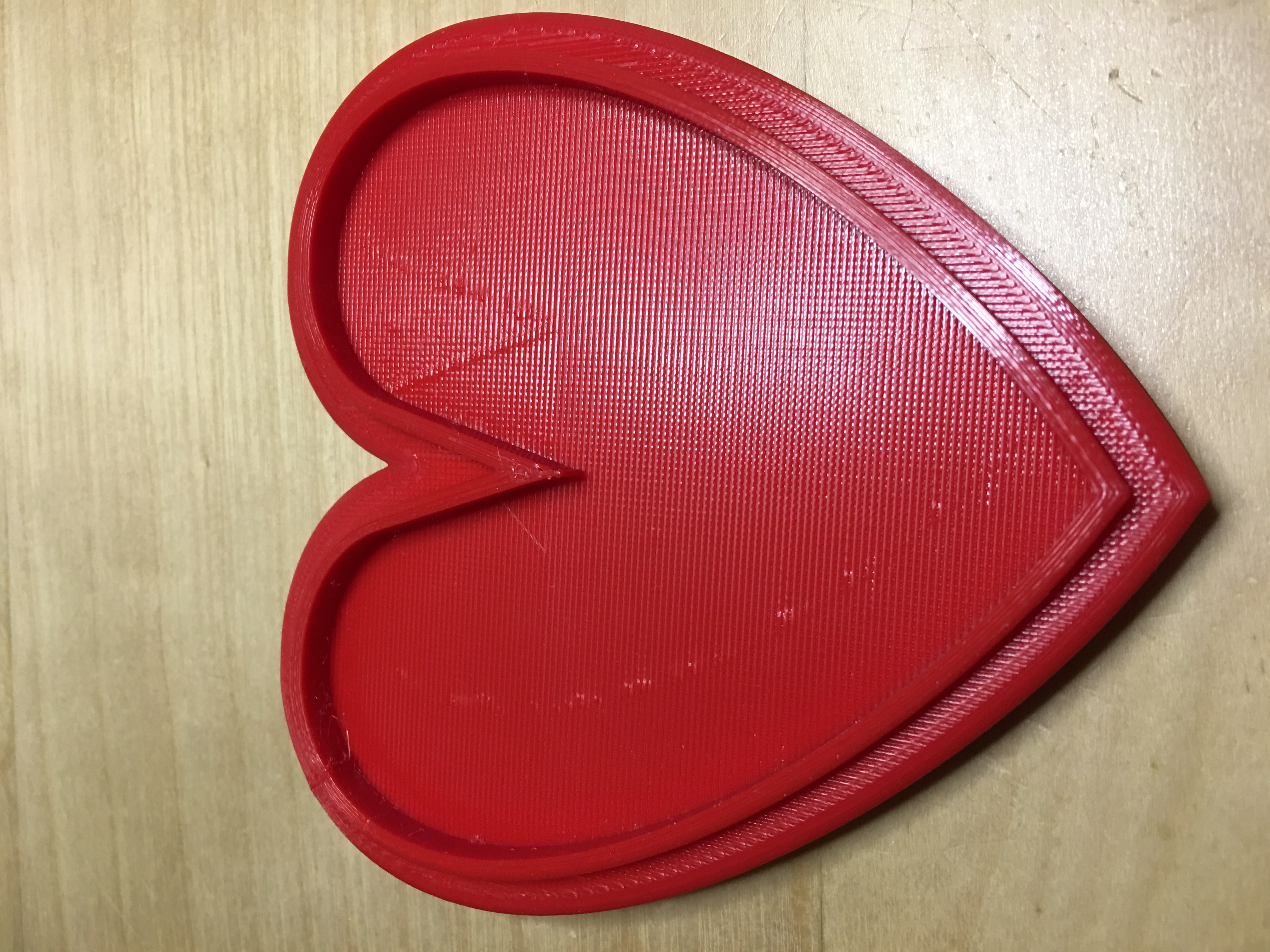

1.5 Release - Beautiful Prints
Pic 3 1.5 Release - Top of Heart - Nice Finish
Pic 4 1.5 Release - Side of Heart - Nice Layers
Side By Side Comparison
Pic 5 - 1.6 Beta 1.1 is much thinner than 1.5 Release
KISSlicer 1.6 Beta 1.1 Settings
Pic 6 - 1.6 Beta 1.1 Style Settings
Pic 7 - 1.6 Beta 1.1 Material Settings
The first few layers of 1.6 Beta 1.1 come out nice and then it starts going crazy. Any idea if this is a bug in KISSlicer 1.6 Beta 1.1 or a settings issue?

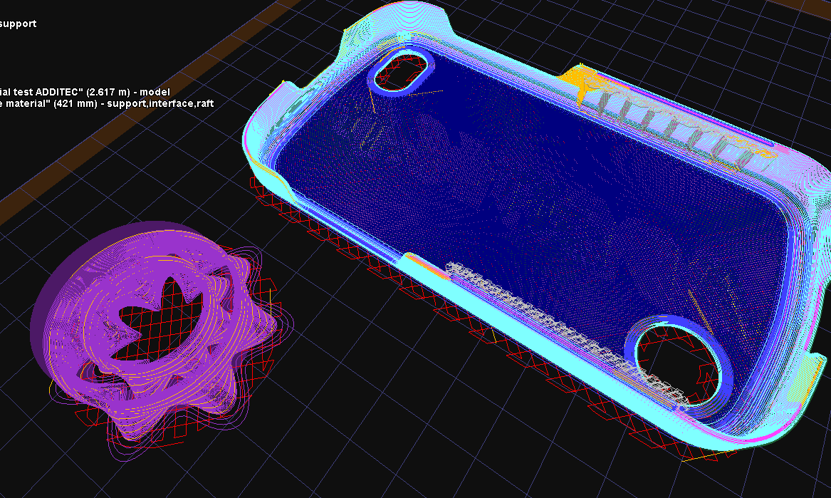

  • with more than 2 loop, and with "Perimeter after inner loop", KS only do one inner loop before
    the perimeter loop
  • Prime Pillar is affected by the brim option, and the grid under the brim of the pillar do not "match"
  • (perhaps a "fake bug") there is two Prime Pillar :shock:
Printer : A4v3 From 3ntr - 2 Extruders.

inventabuild wrote:1.6 Beta 1.1 - Under Extruding / Strange Behavior
Any chance of uploading the STL and I will do a test print to check if it is a settings or slicer issue.
Thanks
Peter

funBart wrote:It seems that when setting the min layer somewhat higher there is also a Z elevation applied. Also some slow start for that layer that's under the min layer threshold.
Hi Bart
Apologies, I am really having difficulties summarising some of your bug reports. Sorry... Please let me know if my summaries are incorrect.
Yes, when the print cannot be slowed sufficiently (due to minimum volume settings) and the layer time exceeds the min layer time, there is a pause with the nozzle raised and I get significant oozing during the pause even with preload and destring happening during the pause. I think this was also in 1.5, but the problem is that the pause may be unnecessary when multiple objects are being printed or when multiple extruders are in use- I think the pause is being calculated on a per mode/per extruder basis.
Peter

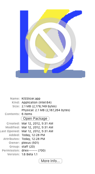

Just tried 1.6 beta 1.1 on mac. It wont open. the application has the "NO" symbol through it (see screenshot)
