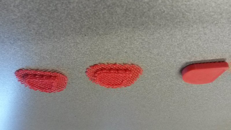

But the prints have gone backwards...
Left: print before a setting was changed (don't know which one)
middle: cubex trio 1
right: cubex trio 2

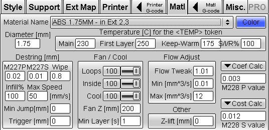

see image below.
matl tab below as well

If you still have the bak file of the good part you can look inside and find all the parameters.
