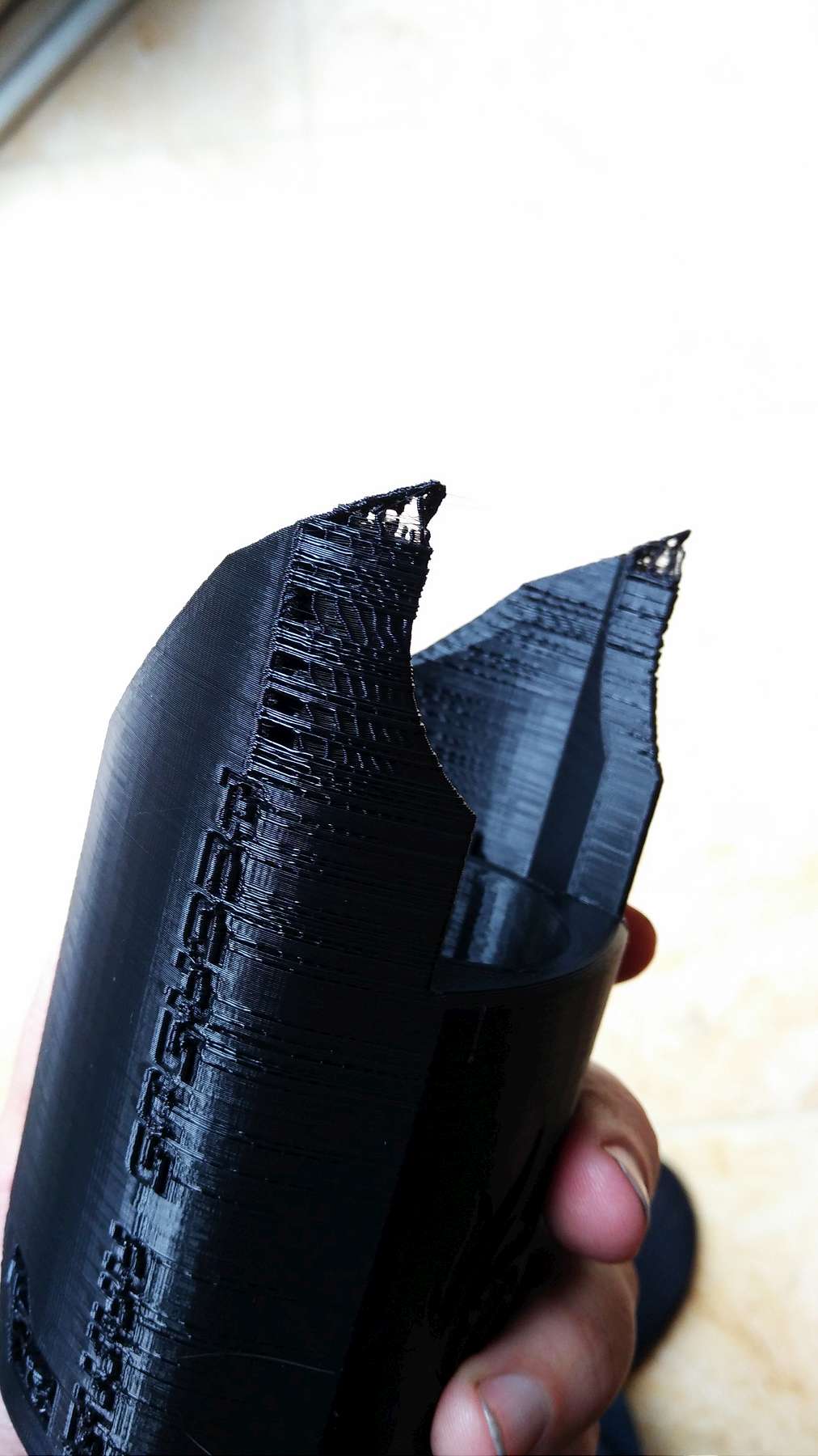

Some parts of my model are all chewed up???

So, what makes me believe it is a slicer setting, is ALL PARTS of the model are ALWAYS amazingly perfect, except for the top tips which are the last 1-2 inches to print. 9 times out of 10 they are chewed up. Which is why I was thinking the width of those tips may not have enough skin or wall or material set as it tries to create the infil??
Can you recommend a setting to try?
If I don't feel comfortable with voltage change, would that new $110 hot tip be a good thing to try?

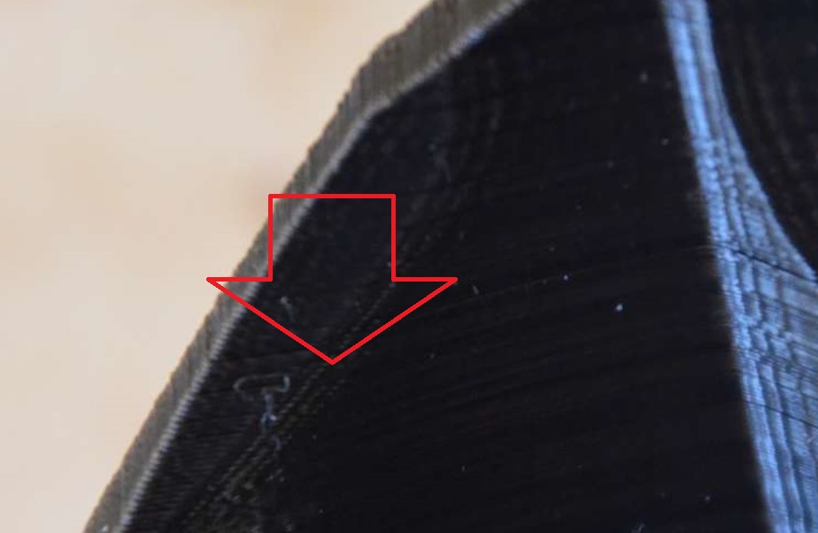

Do you see these tips are where the print quality goes bad...

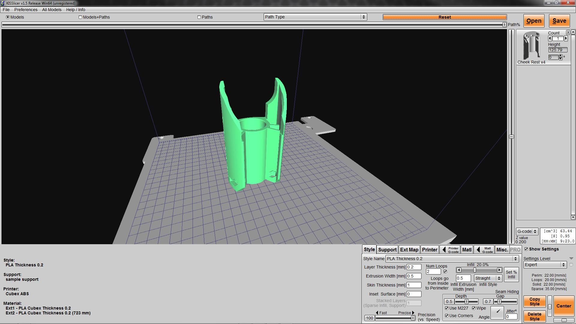

And like I said with EXACT same settings V4.91 shows a print time of 9hrs and V6.05 shows a print time of 30 hours! I cant run 1 part for 30 hours???

On this picture I can see that the print start to go bad not only on the top but also on other parts of the model.PegasusArms wrote:Do you see these tips are where the print quality goes bad...
It's important to determine if those points are related to the seam.
Into KS, after you've sliced the model, click on "PATHS" then move the cursor on the right to inspect the layer where you have the problem and look if the seam is located where the problem starts.
But on this picture the line is the seam ? ( If yes I'm a little bit confused because here the seam looks OK, anyway I'll tell you what to do for the seam )
If the problem is the seam this is related to M227 & M228 parameters.
To find the right ones you better use the model into the zip file below.
load it into KS, then select "count" 2 to have two parts.
Into Style tab select :
- Loops go from inside to perimeter : checked
- infill : vase
- loops 2
- skin thinckness : 0
Into Matl : use the same M227 & 228 parameters you've used for your parts.
slice and print, then observe the seam internal and external on both parts.
Do you have the same problem ?
Now go to Matl and change like this ;
M227P 0.1
M227S 0.04
M228P 0
M228S 0.015
slice and print, is that better ?
When the seam is not too bad you can fine tune it into Style tab using depth and gap.
About the printing time, if you look the time given by KS this is not affected by the version of Cubeitmod, because KS can't know how the post-processor works, you have different settings ( check acceleration, but this parameter affect only the time calculated by KS not the real print time ).
You have also different parameters for the print because if you look the length of filament calculated by KS they are totally different ( 723mm 1.95m !!!)
