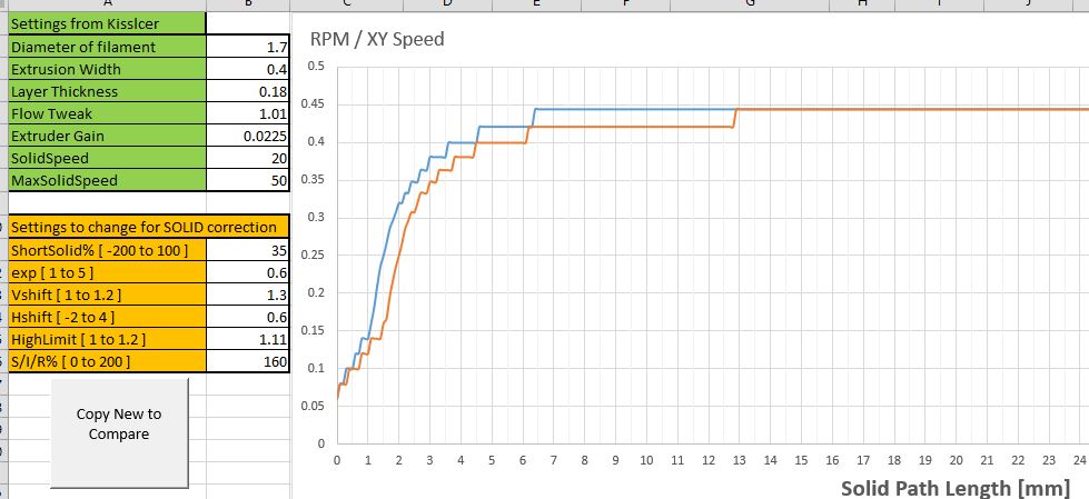

Re: New Version CubeItModV6.05
1 enter the parameter you used to print
2. click the "Copy to Compare button", this will give you the Brown line, the Brown line is your reference line.
3. change the parameters to push up or down the blue line as needded. Looking at the picture you sent, looks like for long path is OK but for short paths ( ~ < 10mm) you have to encrease the output, something like this goes in that direction :
4.Use the new parameters into KS and print a new part
5. if needded make another correction with the help of the Excel file.

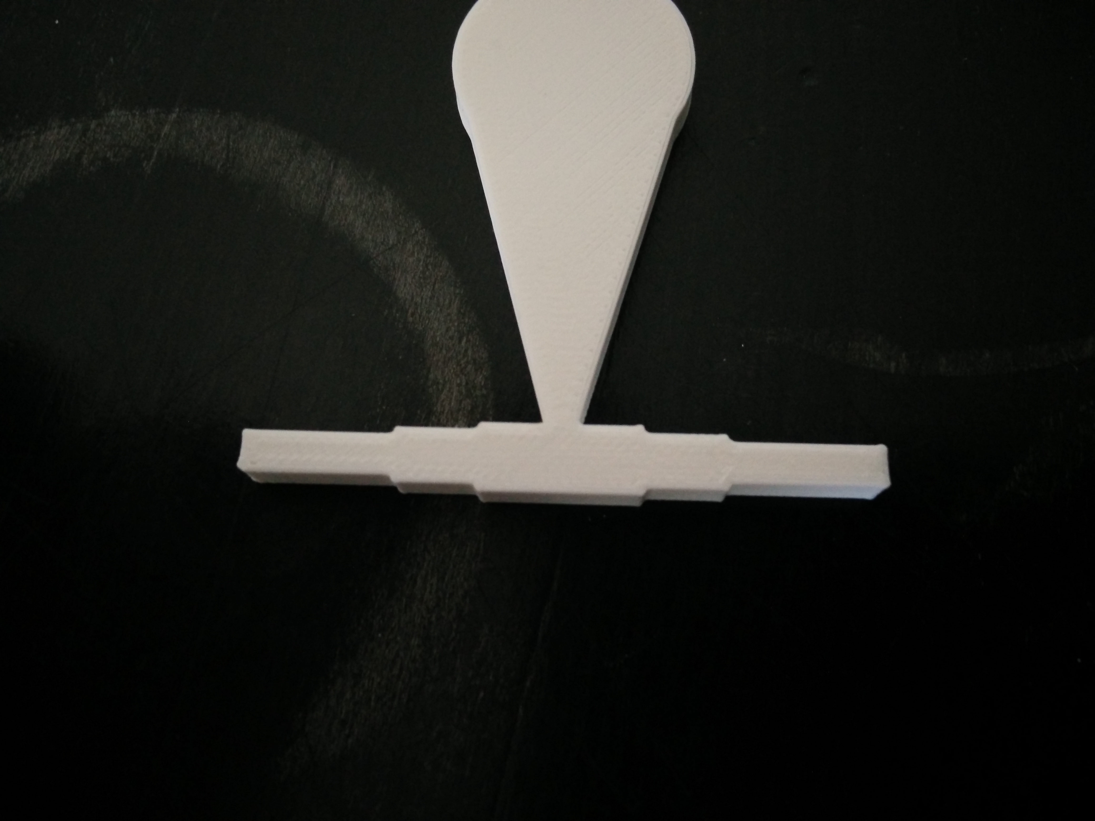

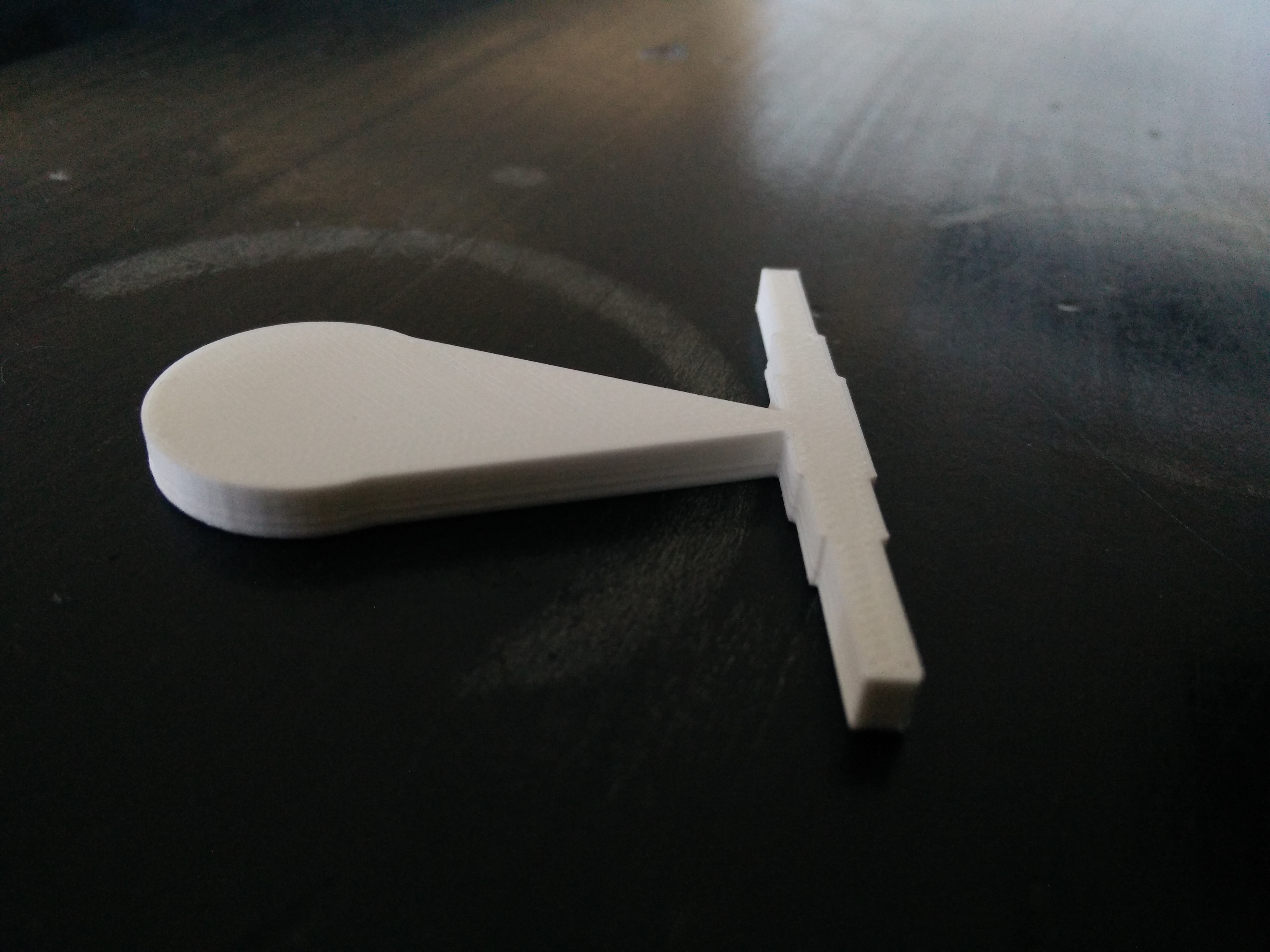

hi Giovanni
Here are some new pictures of an part printet with changed values.
New Print 2
New Print 2
New Print 1
New Print 1
Excel settings
Excel settings
rantzaus wrote:hi Giovanni
Ok, are you happy with this?
From the pictures and with white plastic I cannot see if there's something that can be improved.

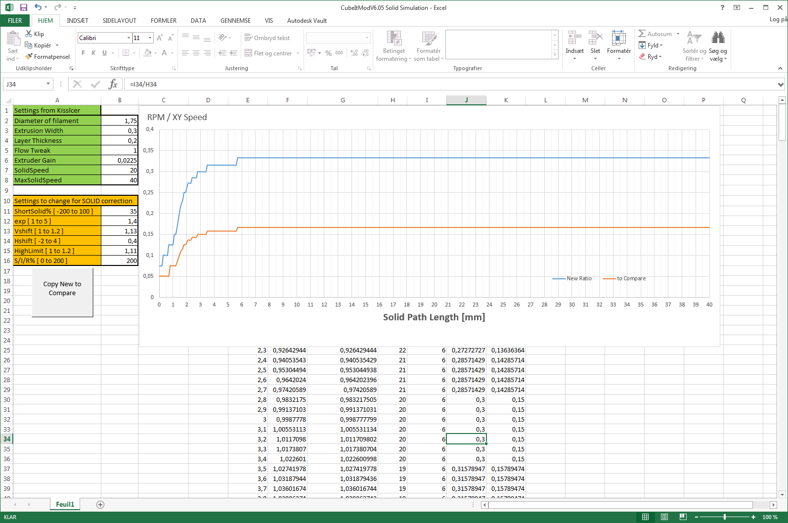

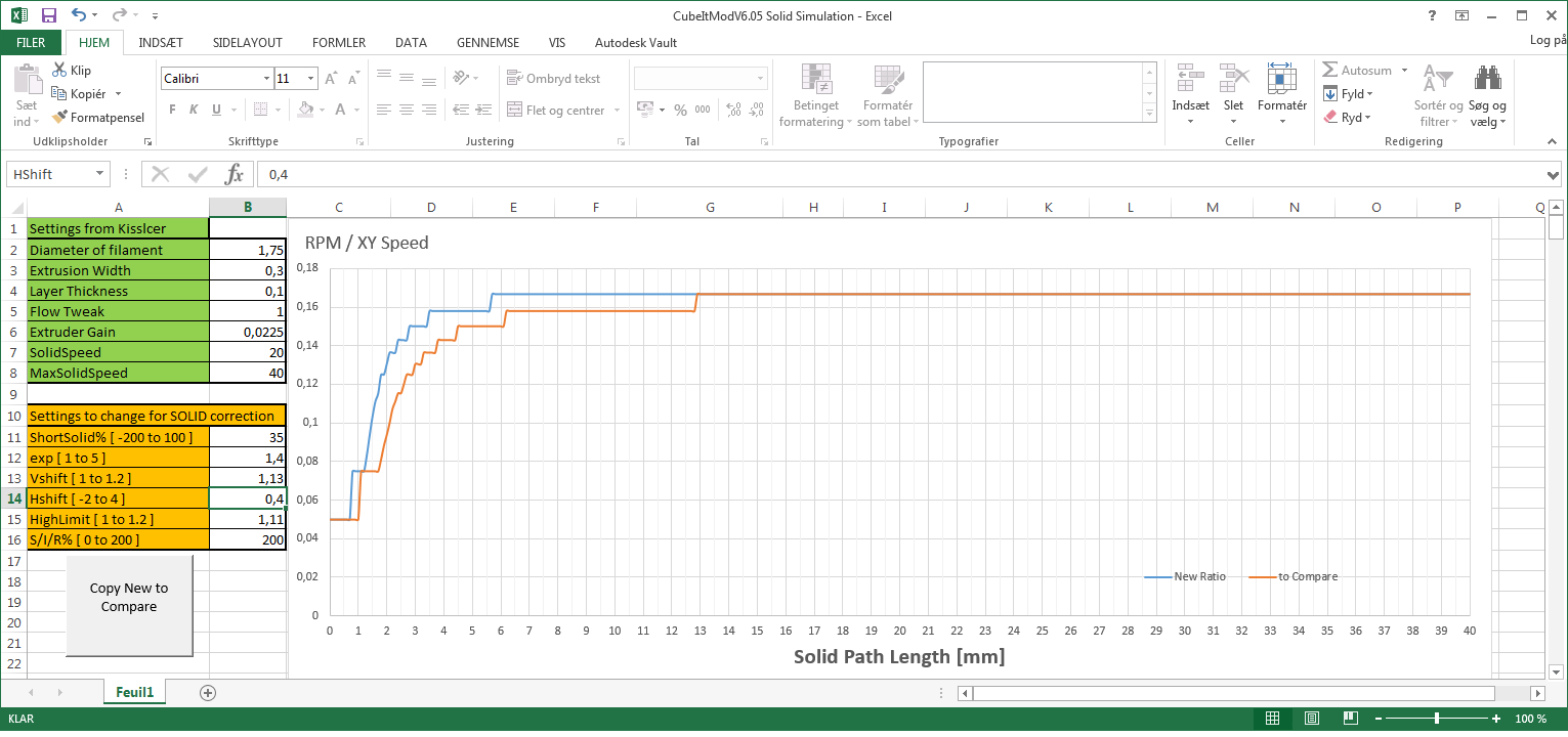

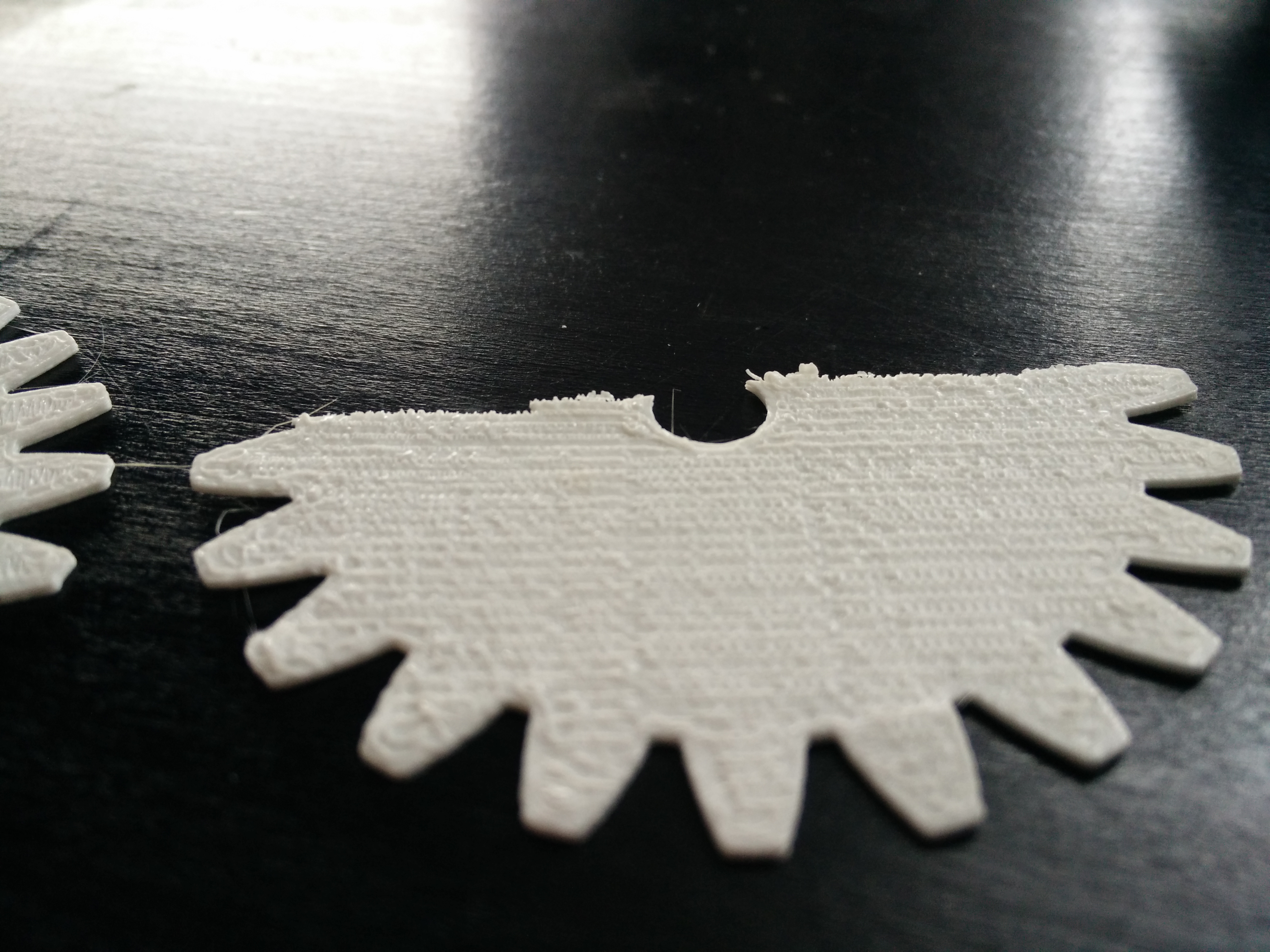

Hei Giovanni
I got my printer good results in 0.1 layer heights. But when I'm printing 0.2 layer heights, it looks like the infill is overextruded.
I have attached some pictures. I have also attached a picture of the spreadsheet showing the difference on the two layer settings. Brown is 0.1 height and blue is 0.2 height.
rantzaus wrote:Hei Giovanni
If the layer thickness is 2 x bigger is normal to have the the blue curb 2x higher because for the same X/Y speed the printer must push 2x more material.
You just have to fine tune for 0.2 layer thickness, if you have overextrusion use the parameters to push a little down the blue curb and print again until you have a perfect extrusion on all the path lengths.
