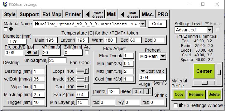

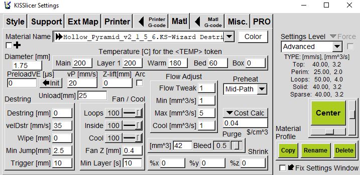

KISSlicer_Win64_v2_alpha_1.5.6 Destring problem
Re: KISSlicer_Win64_v2_alpha_1.5.6 Destring problem
It looks as though you have the wrong filament selected...
V2.0.9.9
Hollow_Pyramid_v2_0_9_9.DasFilament PLA weiss
V2.1.5.6
Hollow_Pyramid_v2_1_5_6.KS-Wizard Destring Procatec PLA weiss
