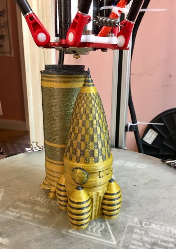

Dual Extrusion Rocket
KISSlicer 1.6 w/Preload. 20% octagonal infill, 2.5 fractional loops. .2mm layers. Trick Laer MAXMetal delta with Duet WiFi, .9° steppers, 24VDC power, Trick Laser Ball Cup arms and Micro X Carriages, 713Maker Effector and Cyclops Mount, E3D Cyclops dual in-one out hot end, Dual Zesty Nimble Remote Direct Drive Extruders, Fillamentum Gold Happens and Vertigo Grey PLA filaments,
Dual Extrusion Torture Test DX Rocket: https://www.thingiverse.com/thing:2574424
Apparently, this might be the first one made, even the designer didn't print one.

Hello!!
It was very good! You could share the Scripts for me when I change the material, I'm lost with the configuration.
