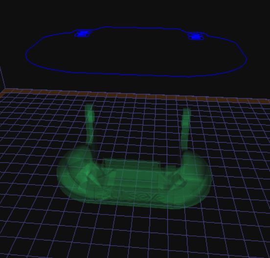

Hi, I have just found KISSlicer and found it verry capable and it creates verry nice 3D prints but it fails for me with larger models without any messages.
The slice seems to go verry fast but nothing get sliced and if I click on Models+Paths it showes on layer in the air abov the model and it is not possible to change hight on the scroll bar on the right.
Any suggestions?

- Pic.JPG (40.71 KiB) Viewed 3844 times

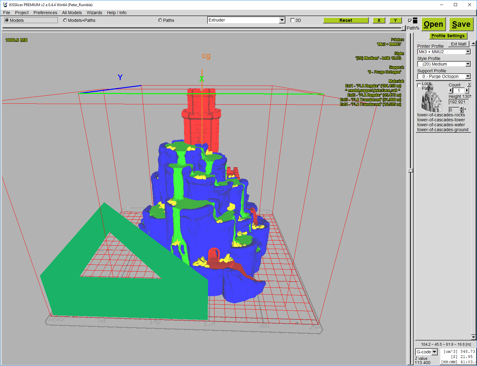

Hi. What version and OS are you using. How many processor cores/threads and what memory is available?
I just sliced this:
Using 4 extruders, with purge tower, generating a 133MB G-code file.
I just sliced this:

Re: KISSlicer fails with slicing on bigger models.
Sorry, should have thought about that, had not used projects befor but now I think I have created one, hopefully it is correctWhen you
EDIT:
After thinking a little bit I realized that I copied and used the same configuratin for all test just because I'm lacy so I created a new directory and started KISSlicer from the begining so to say and recreated all configuration.
After that it slices the part as it should.
Sorry that I did not think about that erlier.
Yup, there's a problem with that profile.
Having Z Step set to 95mm is not really a good idea
(Settings/Printer/Hardware/Z Step [mm])
This should be set to the distance moved per (micro)step of the Z axis.
You also should consider increasing the Loop/Solid Infill Overlap on the same tab.
