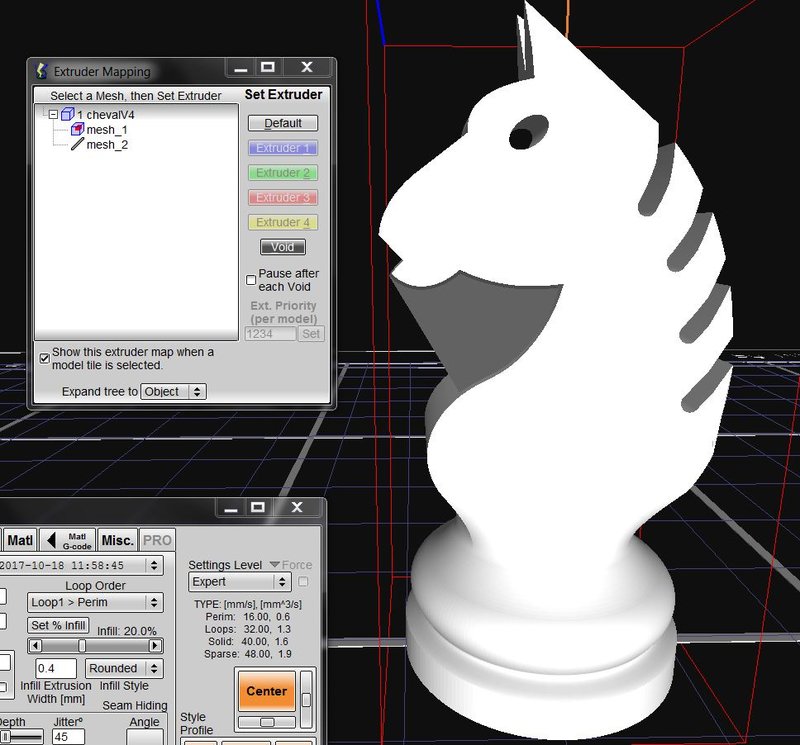

Hi, I want to print an object and I designed it's own supports (as a part of the object), I can select this part with kisslicer (when I click on extruder mapping, this is the part in grey color in the picture) and I want for example to be able to change only for this part the speed, the infill etc...Is this possile ? It's like using the modifiers in slic3r...

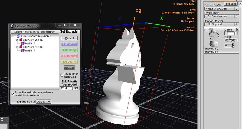

Thank you mhackney, I've already watched your video many times but are you sure I can lock path of two parts that are from the same object ? I mean my object is made of two components in only one STL file, I can't lock path for each of them :
I've tried to save my object into two different STL files but they are not positionned at the right place when I load them:

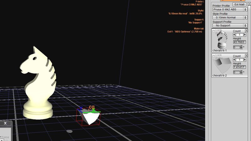

I've also tried to load multiple files into one STL file but they are not positionned correctly, and also I think I can't lock path for only one STL file:

You are correct, they locked parts only works on objects from separate files. Unfortunately, I don't think the lock paths feature was designed to deal with situations like yours - it was designed for completely separate parts, not parts that compose a single print.
