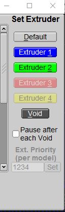

With dual extrusion of a single model KISSlicer always starts w/ extruder 2 even though my Ext. Priority (per model) is set to 1234:
Ext. Priority Not Working.JPG (19.75 KiB) Viewed 17251 times
inventabuild wrote:With dual extrusion of a single model KISSlicer always starts w/ extruder 2 even though my Ext. Priority (per model) is set to 1234:
The extruder priority function does not set the extruder order...its job it to decide which extruder is chosen if two meshes overlap and are set to different extruders. For example, if you want to print a heart with an arrow through it, you can just let an arrow mesh overlap with a heart mesh, then tell KISSlicer which extruder "wins" in the regions that overlap.
If you want the extruders to always print in the same order per layer, set the "Extruder Order Optimization" in the [Ext Map] tab to "Fixed Order (most cooling)". It's a great idea to use the extruder priority as the sort order, though!
Having written a post processor I have to add the following:
1. PP can only handle up to 3 changes per layer, so using Fixed Order with potentially screw things.
2. If the prints start with the "wrong" extruder, it is possible to require a filament change at the end of a layer - which would not work. Somehow, KISS seens to start with the right extruder to prevent this happening and any changes would put my PP back to the drawing board...

lonesock wrote: If you want the extruders to always print in the same order per layer, set the "Extruder Order Optimization" in the [Ext Map] tab to "Fixed Order (most cooling)". It's a great idea to use the extruder priority as the sort order, though!
Unfortunately, when I select "Fixed Order (most cooling)", then the first extruder always starts first even though sometimes I need the second extruder to start first.
I've been doing a lot of testing and sometimes I need to run the extruders in a certain order to get the cleanest prints. Using extruder priority as the sort order is ideal for this. Is it possible to do this and give Peter a token variable so he knows how many extruder changes are taking place so he can provide an error message when it exceeds the current limitations of his Post Processor?
