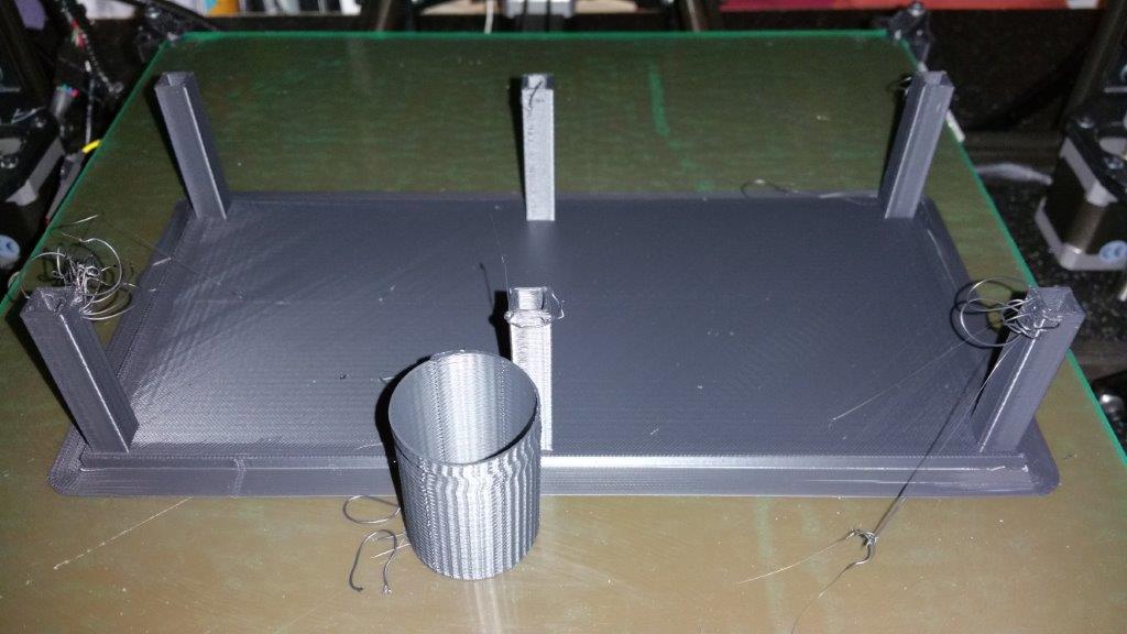

The last pic shows a table printed with a prime pillar. The pillar stopped printing for an unknown reason then KISSlicer started printing strings on the legs.

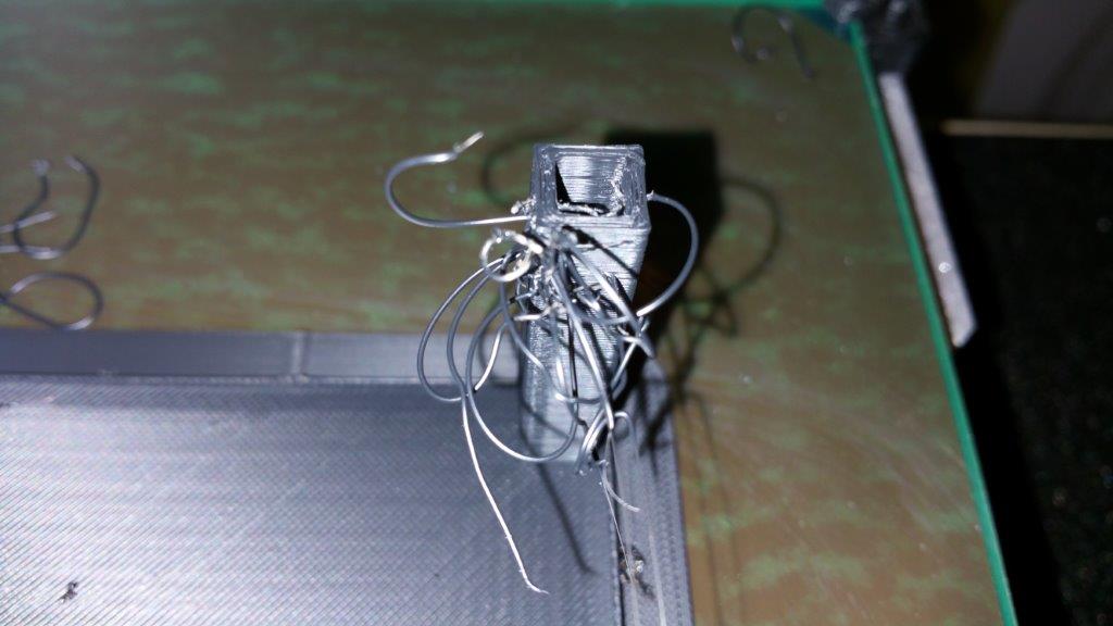

The second picture shows a closeup of one of the stringy legs that KISSlicer printed.

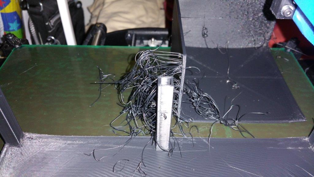

The first pic shows a table and wall (separate stls) printed together w/out a prime pillar. Once again KISSlicer started adding strings to my prints, especially the wall.

- Stringy Wall.jpg (95.74 KiB) Viewed 5069 times
- Stringy Leg.jpg (58.03 KiB) Viewed 5069 times
- Table - Full View.jpg (71.66 KiB) Viewed 5069 times
