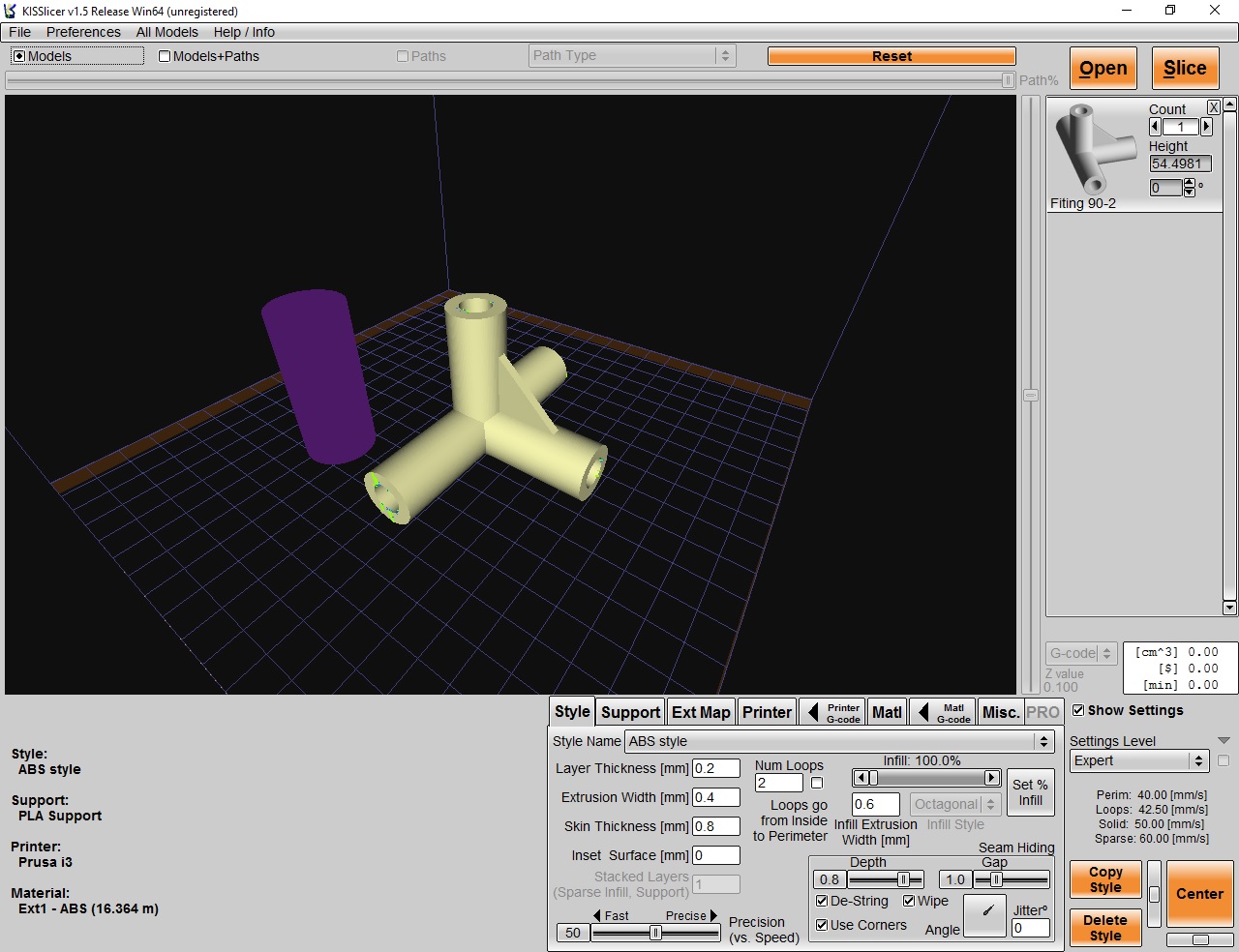

Hi all! I have a problem with releases KS1.5
Strange model appear in all files. (purple cylinder)
- Posts: 137
- Joined: 17 Nov 2014, 09:20
Re: KISSlicer 1.5 has been released!
under support tab, you have single pillar selected. That is generally used to purge the nozzle when printing with a dual extruder printer.
