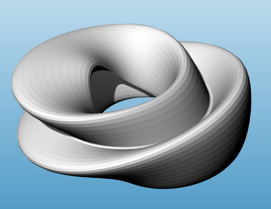

Problem 1 - You have mentioned well the first problem which is difficulty in differentiating between internal and external surfaces [ non uniform direction of surface Normals. ]
Problem 2 - The whole model has a height of 2mm. It is very small to print the details.
Third problem is - the Mesh [.stl] generated out of the model is bad, I have tried to repair it but it's not repairable.
Therefore, I have remodeled it.
The remodeled version can be downloaded from : http://www.thingiverse.com/thing:1895107/#files
I have increased the height from 2 mm to 30 mm for good printout, you can scale it down though.

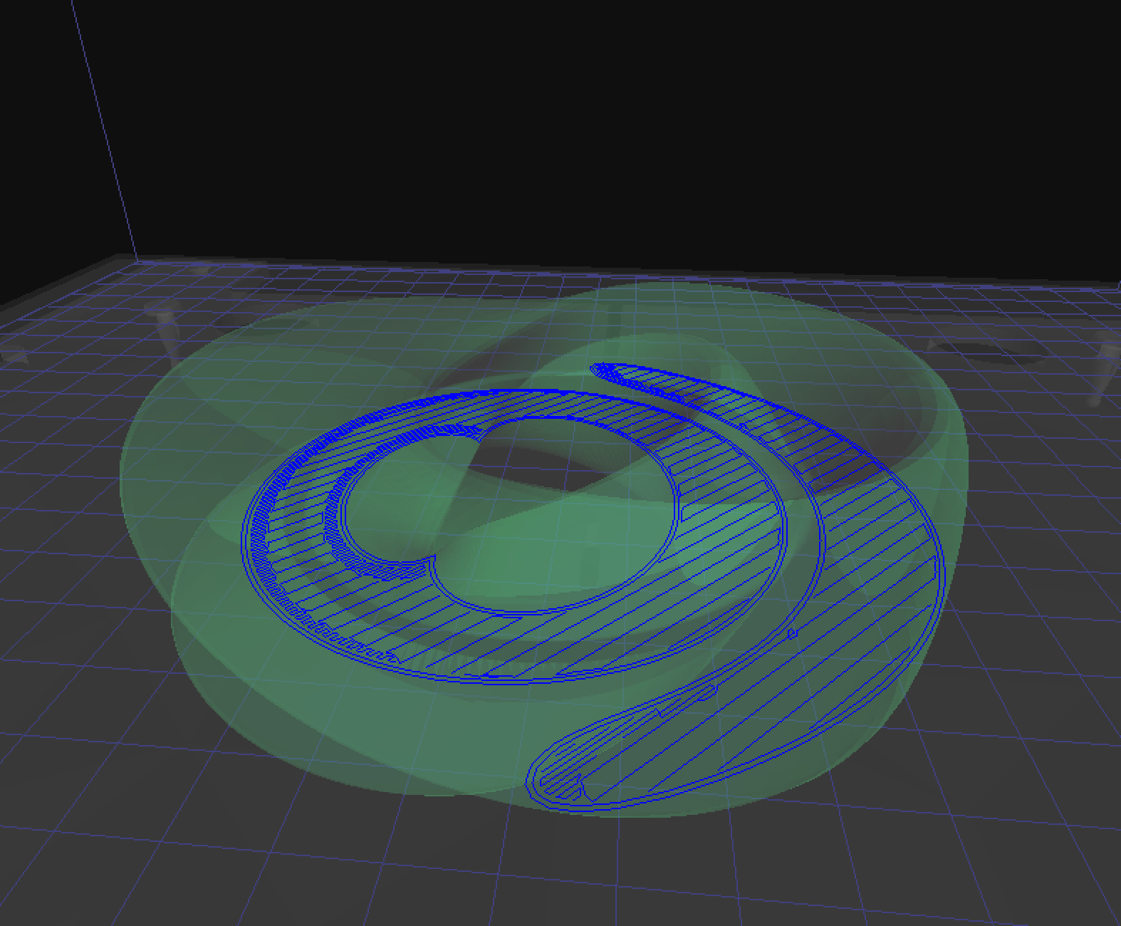

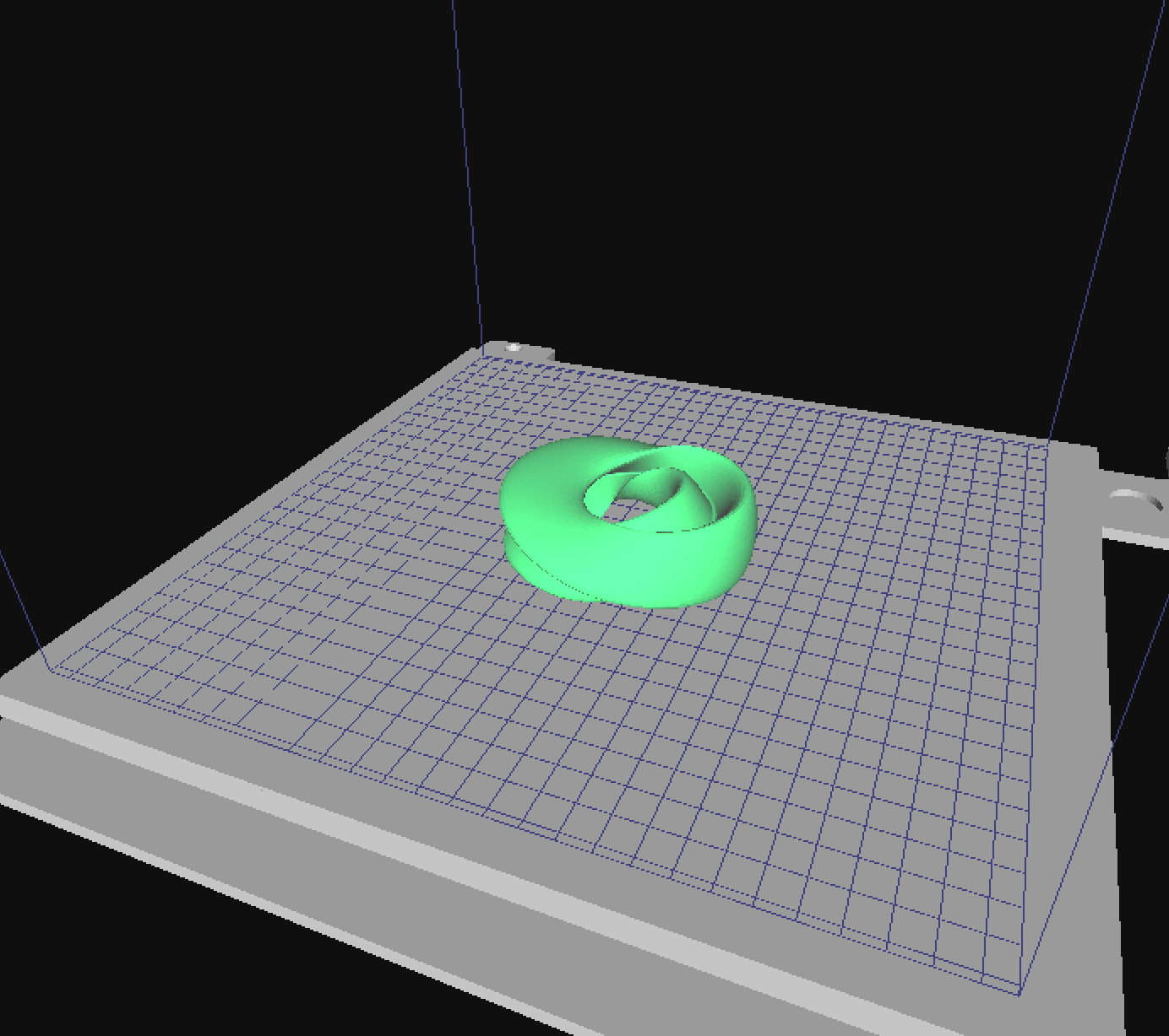

I have sliced it and attached a screen capture.

Remodeled infinite symbol abstract
imported stl to kisslicer
Sliced layer
Sliced layer

Also thanks for elaborating on the problems. Indeed the model was not designed for 3D printing in the first place. I did not design it myself, I just found it after a discussion with a cousin on Moebius rings and Klein bottles. As I'm interesting into looking into this further, maybe use it in a project, I'm curious how you remodeled it. Not via the standard SketchUp tools I guess. Can you elaborate on that?

I sliced with the KISSlicer, mostly default settings for 200 micron resolution, printed it on my Felix, attached a photo on your entry at Thingiverse. (http://www.thingiverse.com/make:268709).
Thanks again for the remodeling, but I'm still curious how to do that properly.

Just for your curiosity the model is a simple one.
The software is not that important. You can use any 3D CAD software that you are familiar with.
The important thing is the method which is commonly found on almost all 3D modeling software.
I have attached a pdf file which shows the steps I used to remodel the above shape.
Infinite symbole abstract shape.pdf
How to remodel the infinite symbole abstract shape for 3D printing
