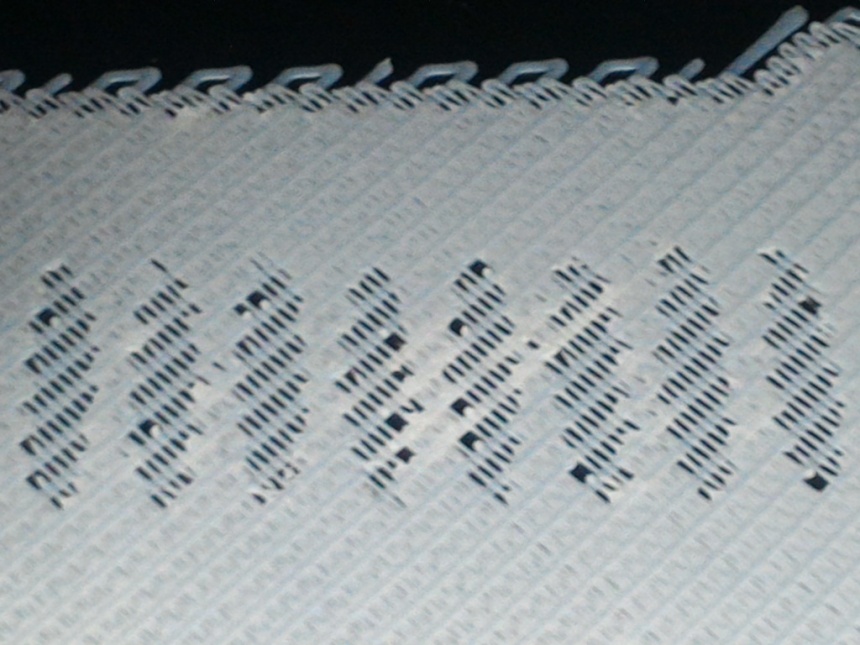

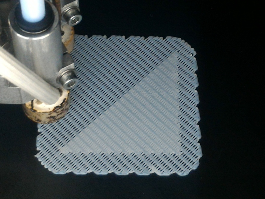

Hi all
When slicing with grid and solid layer enable, KS mix the solid path with the second grid layer.
When printing, it seem KS do 50% of the solid path, then the second grid layer, and 50% of solid path.
Is there a good reason of that?
This new "feature" is not good at all :
1) the grid warp, then the object (always if short length of solid path extrusion is done) => ruins of the print :!:
2) bottom surface/angle of the object have a better look under the 50% of the solid path made after the second grid layer. :cry:
Is it possible to separate again the solid path from the grid path?
Ex 1 : The second grid layer and the solid path are mixed
Ex2 - just after the end of second grid layer
Warping because no second grid before solid path

I want to keep the solid layer. It is a problem of sequence of printing the raft and solid.
For now (KS RC1 and 3.10), raft grid (2 layers) and solid layer are printed like that :
1) first layer of the grid
2) 50% of solid layer
3) second layer of the grid
4) 50% of solid layer
By doing it like that, when small segment of solid layer is printed before the second layer of the grid, I have "automatically" blobs at the end of concerned solid segment. Those blobs are responsible for :
• holes in the second layer of the grid
• warping of raft grid
• bad surface quality
I would like this sequence of printing :
2) second layer of the grid
3) 100% of solid layer
Is it possible?

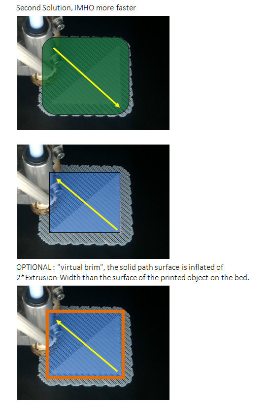

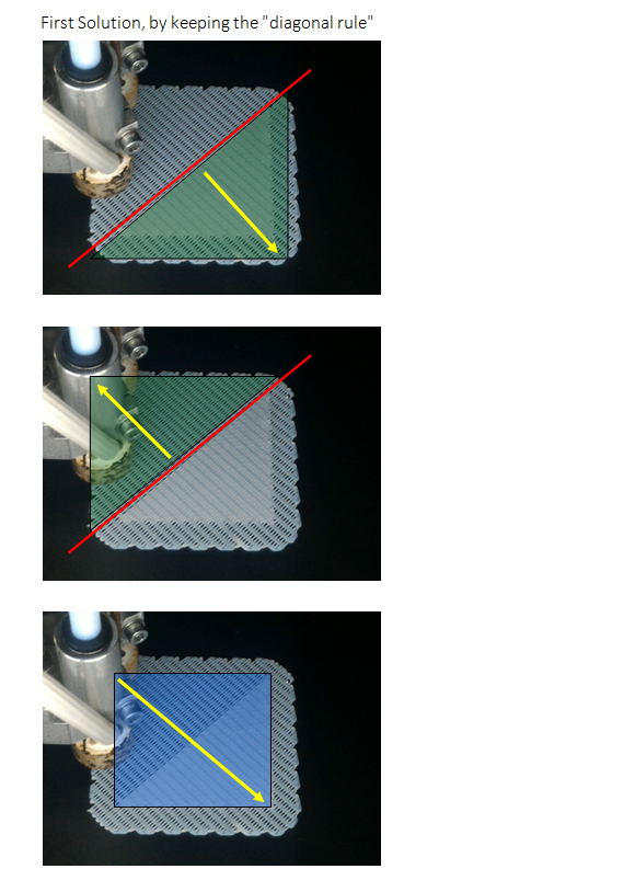

Perhaps there is another solution : where the second layer of the grid+solid start.
Now, i trust you use a "diagonal rule" to determine where the 2nd layer of grid will start. So, is it possible to change the start/end of the beginning of the second grid layer + solid OR move the diagonal to a back corner of the object?
See proposal in pics bellow
1st Proposal
2nd proposal
Regards
