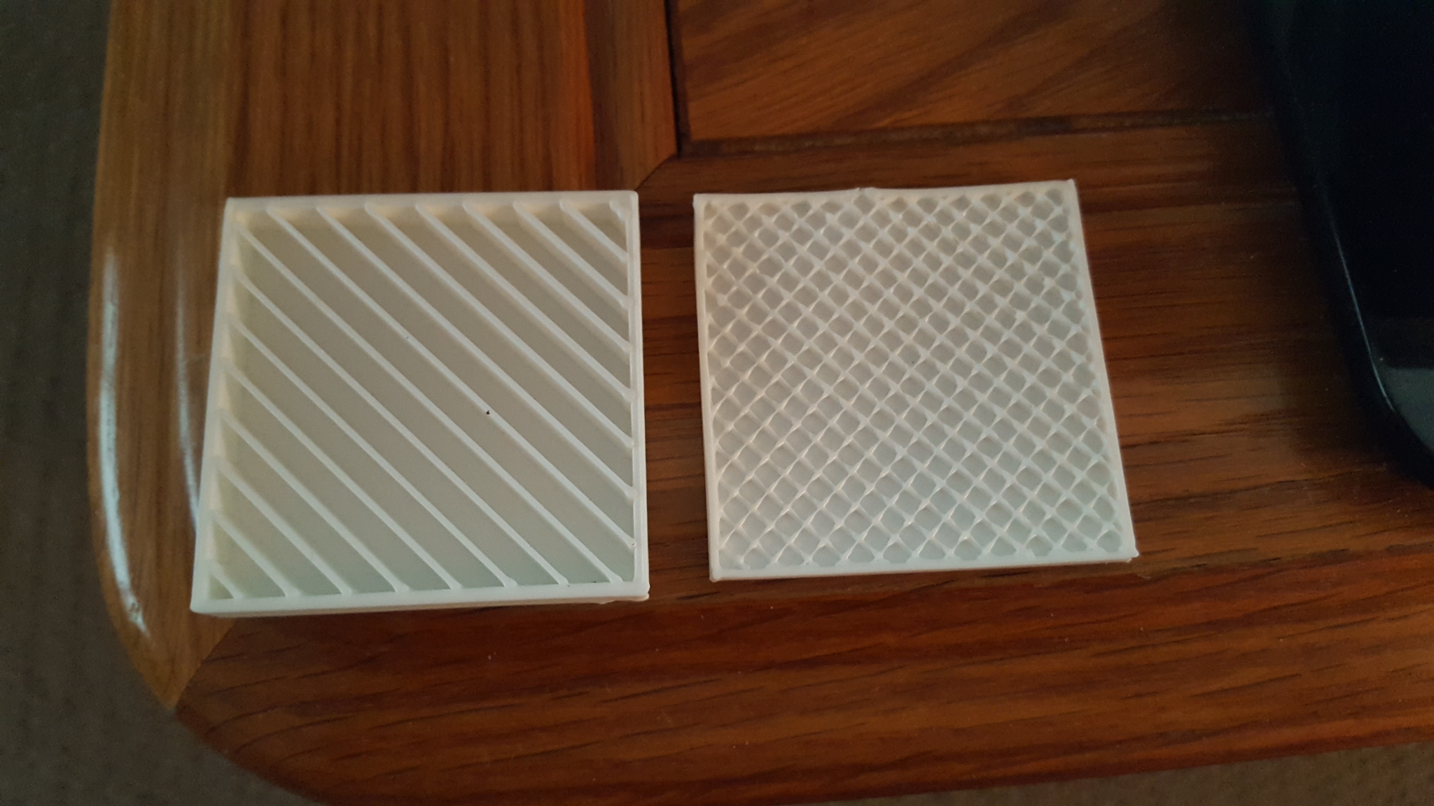

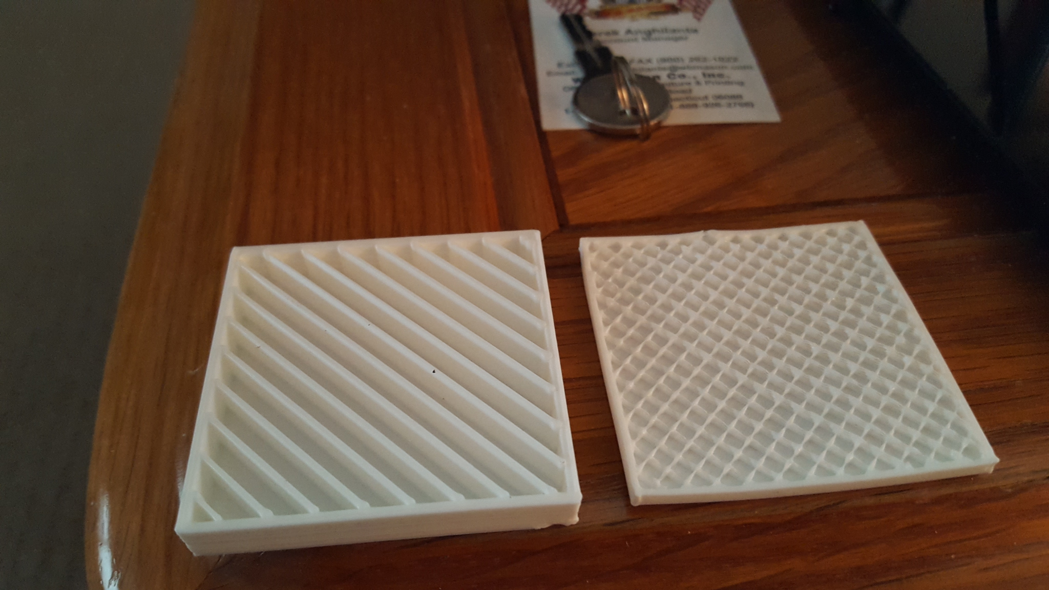

I don't want to use CubeX slicer but there are some things that it does that I like better than KS/Cubeitmod. Box1 is CubeX set at Med part density, Box2 is KS set at 25% infill. Is there a way of setting KS so that it will infill like CubeX? Stacked infill ? set at 1.0 now
I am also having a problem with side wall pitting with KS
I am up to date on versions.
Infill

The Cubex infill is not good at all, KS crossed lines are much more stronger than unidirectional Cubex infill and putting the lines into one direction add constraint when the melted plastic cools, with KS crossed lines the constraint are broken and at the end you have less deformation.joestefano wrote:I don't want to use CubeX slicer but there are some things that it does that I like better than KS/Cubeitmod. Box1 is CubeX set at Med part density, Box2 is KS set at 25% infill. Is there a way of setting KS so that it will infill like CubeX? Stacked infill ? set at 1.0 now
Side wall pitting are probably caused by bad M227&228 settings.

That makes sense. I have followed all of the recommendations I can find including yours. what is the best way to find the right settings? do I reduce one and increase the other?
