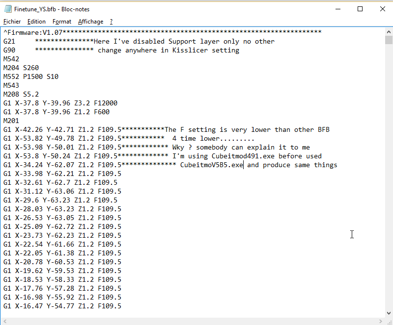

I'm trying print Finetune.stl

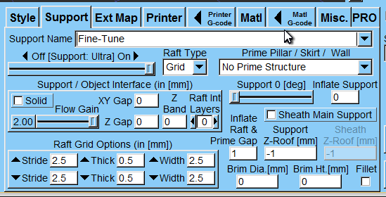

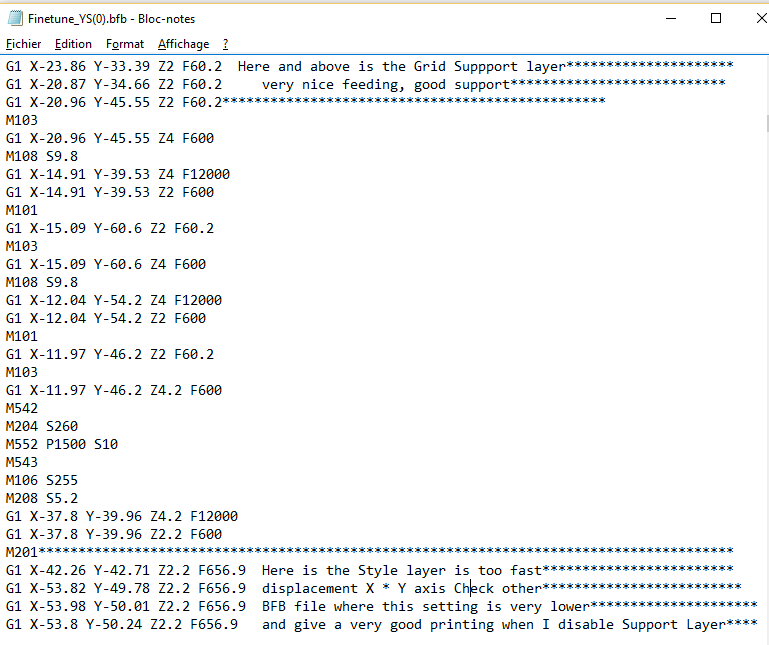

When I print with support, support layers make good job, but the style layer is too fast with flow tweak setting

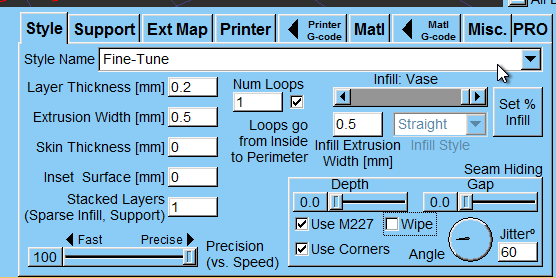

If I disable Support layer and I print only Style Layer the printer built a good work
Why when printing with Support Layer the Style Layer velocity is very rapid and when I'm printing without Support Layer the velocity is good
Somebody can explain it ? Help me to understanding this crasy thing :roll: :oops:
