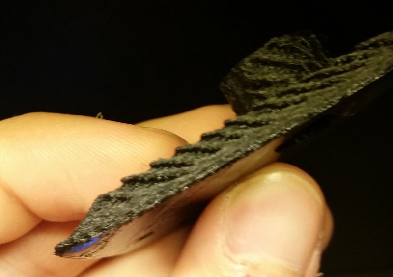

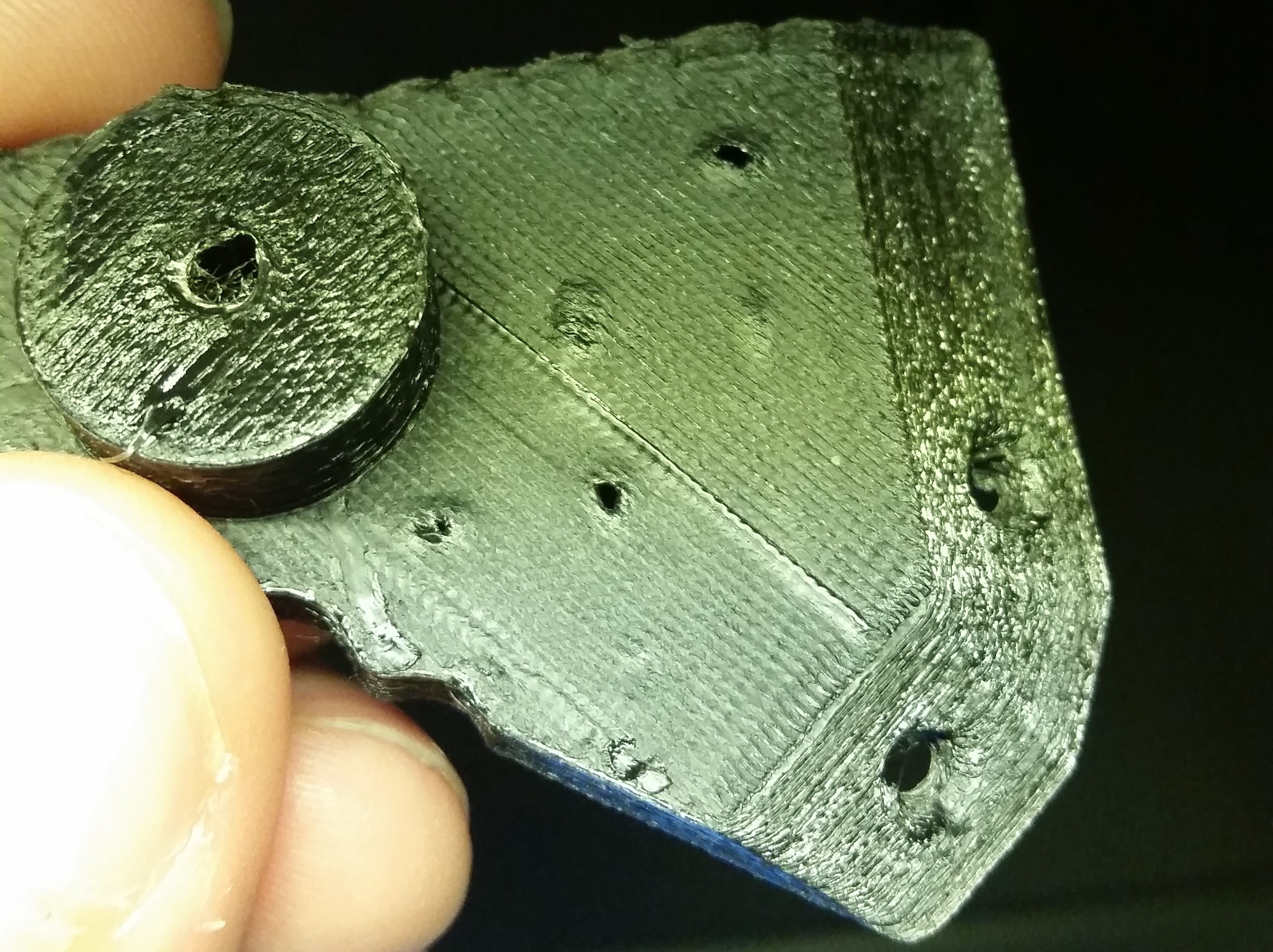

Hi, my name is Andrea..i'm Italian, and I don't "speek" english very well..so, sorry if I write incorrectly. I'm a very happy user of KS, it's wonderful..but, i've some problems with the configuration yes , Because the top it ' s holey ( i've add a picture ) and a side it's very coarse. so,whats' happen? i've just talk with Davide Ardizzola, but i don't want bother he so much. Thanks for the answer and sorry for my english
P.s. i've a 3drag/k8200 with IeC hotend and 0,35mm nozzle, 3mm filament, trapezoidal screw 10x2, i print pla at 210° (yes, i'ts so hight, but i can go most fast), layer 0.15, estrusion width 0.35 or 0.3, skin thickness 0.75mm (5 layer), 2 loops for perimeter. Tomorrow i try to print with 190° and 3 loops..

Hello Andrea!,
I also have a K8200.
My experiences with the 0.3 mm nozzle were mixed. Some filaments worked fine (e.g. white, black),
some (e.g. yellow) not. I had to set up the temperature up to 220°C but yellow lost it's colour.
Now I use the 0.5 mm nozzle, but say the system it is a 0.4 mm one
I send you my set of parameter files that work quite fine for me as PM.
Ciao,
Eddy
