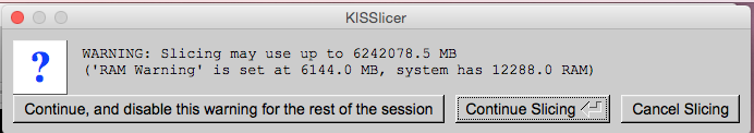

Captura de Tela 2015-06-27 às 16.01.50.png (29.51 KiB) Viewed 3585 times
Thanks for your answer, Jonathan. What amazes me is that KISSlicer was working perfectly and then it suddenly stopped to show the desired stl file on the main screen. I read many posts on the forum, and mainly they refer to a memory problem. Well, running both the Extended Apple Hardware Test and its basic version, and also the Rember.app , I got a failure message in adresses at the Bit Flip test. Following some suggestions, I cleaned the memory cards, re-inserted them in their slots, to no avail. And what amazes still more is that some other apps work perfectly well, like the Slic3r, the Repetier itself, as well as AutoCAD, SketchUp, netfabb (basic version), meshlab and so on. No problem whatsoever with those softwares. So, I am almost sure that or the problem is caused by that memory failure - error 4MEM/9/40000000:0x877cc118 and some others similar to that one, or there is an incompatibility between KISSlicer version 1.4.5.10 and the iMac mid 2011 I use. I also installed the KISSlicer on my MacBook Air 13" begin of 2014, and until now I had no problems. Any ideas?
I wrote the above words this morning. Now it is 5:00 PM, and I found a quite interesting thing. If you select the option Preferences > File Handling > Preview On Open STL, everything works perfectly, at least until now. All files open normally, albeit a few present the above message. With other slicers I have not this problem. If Even so I try to slice, the computer screen goes crazy, and maybe this affected some memory location. I shall be happy to receive any comments on that.
