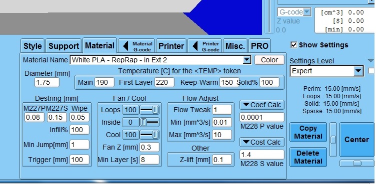

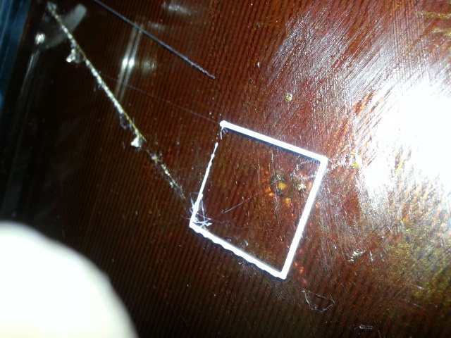

Working with KS1.5 V2.7, Cubeitmod safe from Hugues. Printing a 1"x1" thin wall test box. As the picture demonstrates the filament is not extruding for at least an inch from the start corner of the box. I copied the M227 and M228 from an earlier post. With version 2.0 this prints fine with M227P @ 0.25 and M227S @ .004 but not with this version.

Hugues, Why is it when I read some posts they refer to M227 & M228 "S" as speed and some refer to it as suck. I have tried all sorts of combinations of settings but cant get the "fine tune" model to print without a 15 - 17 mm gap starting at the z level change. I've tried all version from 2.0 to the latest 2.20. I have tried with CubeitMod491, your Safe version and even without any cubeitmod. No change. I have tried your settings and other settings that I have found in other posts. The only version I can get to print correctly is 1.4.5.6.
Lonesock if you read this can you set the record straight? is the "S" speed or suck?
I even printed the file using CubeX and it printed great, I used that M227 and M228 code but it didn't work.
I just saw a post that a guy with a delta printer is having the same problem.
Update: I just realized that M227 and M228 are not showing up in the g code of the newer versions. I pasted them in to the latest version and it printed fine. Is this because Cubeitmod is not up to date?
M227 P.15 S .04 M228 P.015 S .025
