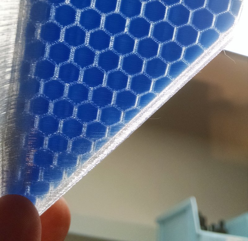

Blue PLA honeycombs encased inside of a clear PLA superstructure.
The part is a fin for a rocket.
Multi color honeycomb fill rocket fins

now, HOW did you get that with Kisslicer ?!?

one way with a single extruder is to set the infil to about 20%, start with clear, as soon as the first skin is printed, switch to blue, as soon as the honecomb infil finishes, switch back to clear.

Multi extruder is the only practical way...

Trouble is: I don't know how Kisslicer can do an hex infill.
