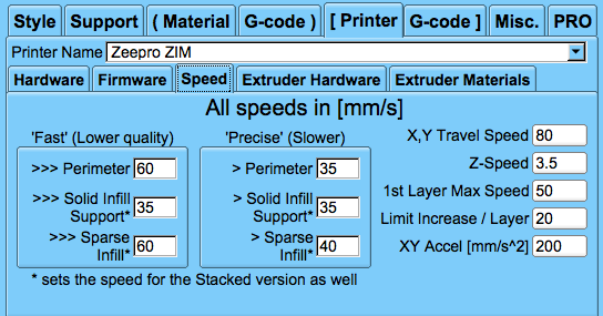

Well, what I really want to do is to give my PVA material a lower speed.
In Kiss (as far as I know) you only can add speeds for solid infills (PLA material) AND supports (PVA material).
Bildschirmfoto 2015-01-11 um 11.06.51.png (69.67 KiB) Viewed 4577 times
Posts: 122
Joined: 07 Nov 2014, 13:05
Location: Oleggio, Italy
Re: <MATL> token: howto?
Post by Davide Ardizzoia »
That's easy.
Put the following line into your PVA MATL section
M220 S50
...and this in your PLA section
M220 S100
Then put the following line in your "Select Extruder" printer gcode section
<MATL>
Now, all your PVA will printat 50% of KS speed.

ohh - I haven't noticed that the <MATL> belongs to a specific material which I have to check at the "material" section and enter the gCode at "G-code" :roll:
I thought about entering something like:
if (MATL == "PVA){
lower speed;}
else if (MATL == "whatever"){
speed * 0.9;}
BUT: as you mentioned it's material related (material tab belongs to gCode tab)
-> alright, works perfect now - thank you!
