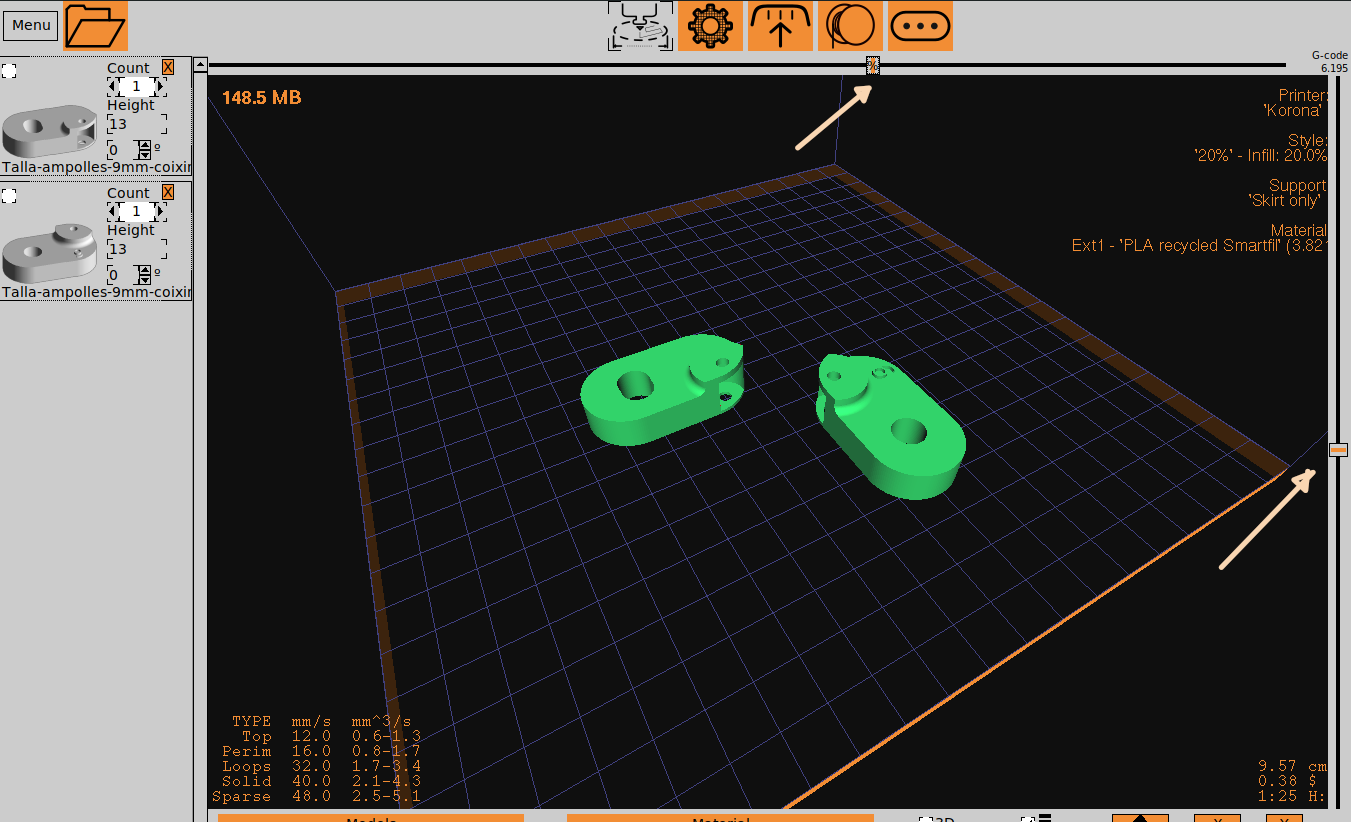

I would like to review the supports after slicing.
As far as I remember, in the previous versions one could move the horizontal and vertical handles to see a preview of the part at different heights.
But in V22.11, after slicing, I move the handles withou any action on the screen.
Is it a bug or I'm missing something?.

Lower left corner - switch Models to Models and Paths or Paths.

Thanks a lot Dorje!
I'm trying to get used to the new UI.
