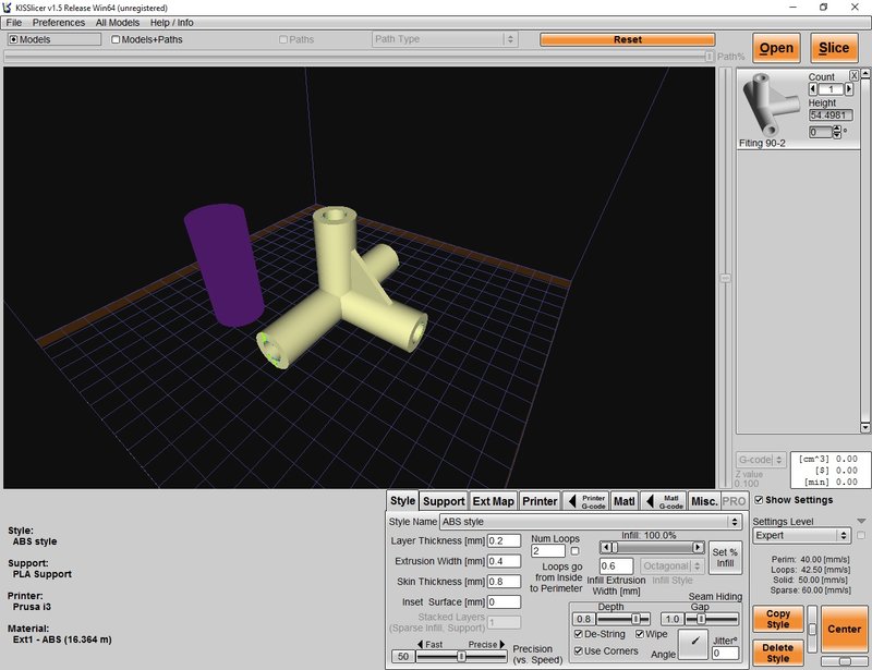

Hi all! I have a problem with releases KS1.5
Strange model appear in all files. (purple cylinder)
You do not have the required permissions to view the files attached to this post.

Post by frozen.rabbit » 14 Jan 2017, 12:28
under support tab, you have single pillar selected. That is generally used to purge the nozzle when printing with a dual extruder printer.
