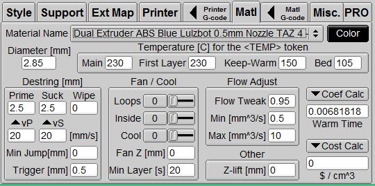

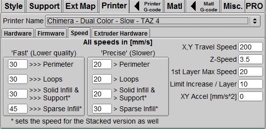

When I change printers the Material Name in the Matl tab turns red. Not sure if it creates an issue or not.
Original Printer
Original Printer
Printer - Original.JPG (51.4 KiB) Viewed 18353 times
Original Material Tab
Material Tab - Original.JPG (56.84 KiB) Viewed 18353 times
New Printer
New Printer
Printer - New.JPG (50.36 KiB) Viewed 18353 times
New Material Tab After Changing Printer
Material Tab - New.JPG (56.62 KiB) Viewed 18353 times

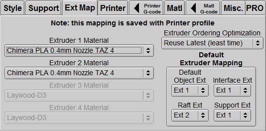

When I click on the new Material Name in the Ext Map tab the Material Name goes to the normal black color.
Click On Material Name In Ext Tab
Extruder Tab - New.JPG (45.76 KiB) Viewed 18353 times
