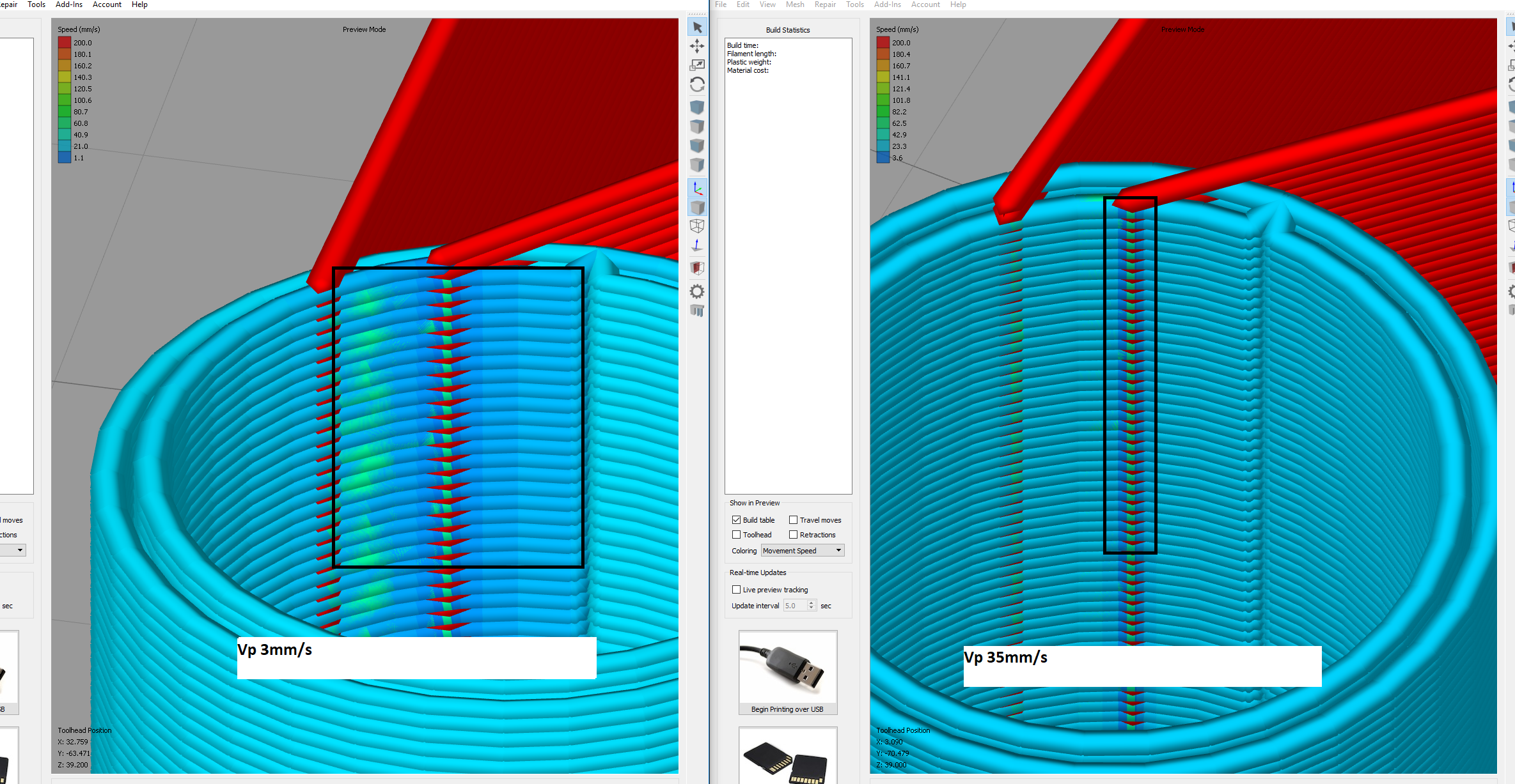

For what its worth my thoughts from observation - vP viscoelasity Preload is the max speed ramp down allowed of your extrusion. Pictured you can see the difference in the speed decrease the blue getting darker the only setting changed was preload vP 3 to 35 mm/s at 50mm/s I couldnt see the gradient.
