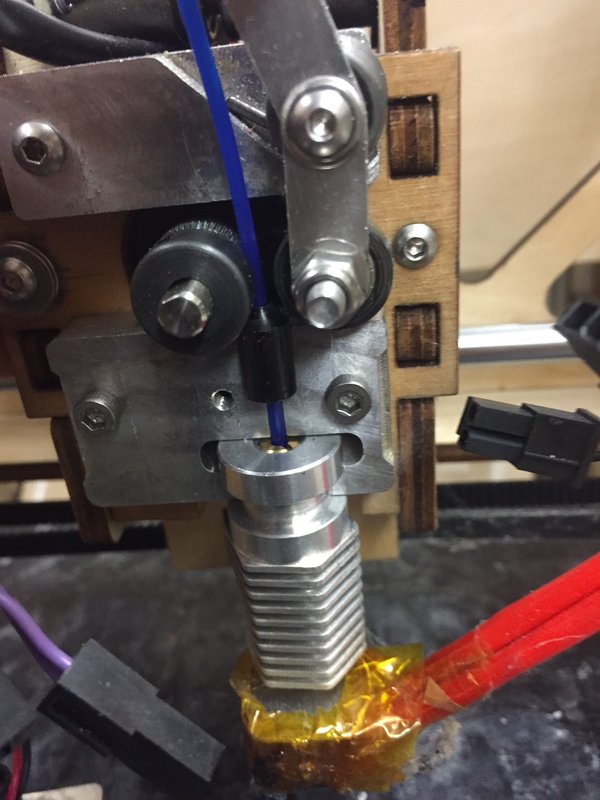

Postby Isaac_alaska » 18 Nov 2015, 17:06
here's what i did to mine to be able to extrude ninjaflex at an acceptable speed. i also had to change the idler bearing so it was the same diameter as the drive gear, so that the "cone" that fits up between them as as tight as possible of a fit on both sides. it's actually such a tight fit that to get the cone out, i have to loosen the set screw on the drive gear and slide them both out at the same time.
stock, there is no black plastic insert, it's just a flat aluminum block and the filament is unsupported from where it leaves the drive gear to where it enters the block, a distance of maybe 4mm. to eliminate this, i counter-bored the aluminum block and machined a delrin insert (the black cone) for the filament to slide through
