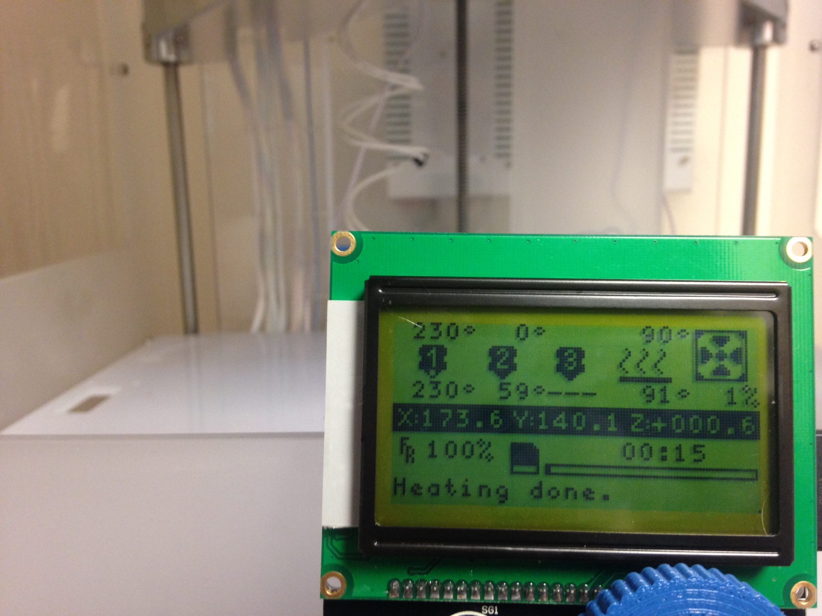

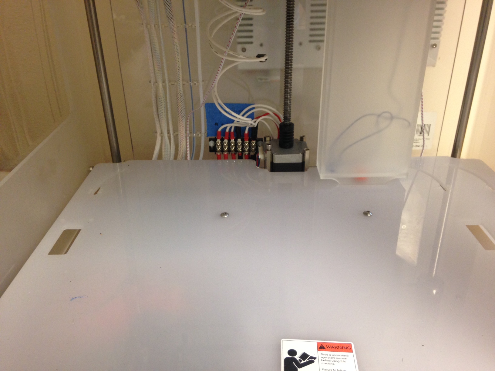

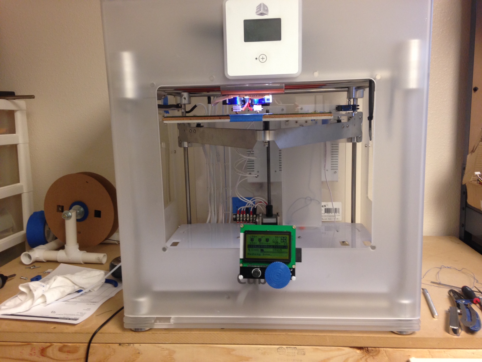

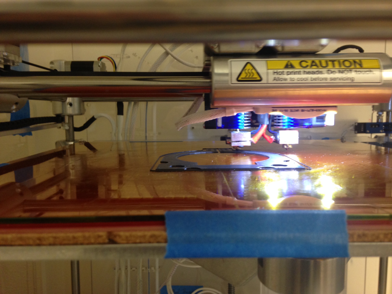

Thought I would post a quick update on the progress of the fully re-brained CubeX.
What started out as a regular CubeX has now been converted to a fully functioning open source machine.
Currently Setup:
12v 12''x12'' heated PCB print bed with glass top
Arduino mega 2560
RAMPS 1.4 Shield
DRV8825 drivers
LCD with SD
Stock belts
Stock threaded rod
dual 12v 360W power supplies
Dual E3d v6 hot ends
Hot Ends
Inside
LCD
Front View

So originaly it had one hot end ? and now you upgraded to 2 .
so now u can print suport material with the second one ?
do you have any more pictures and/or explanation for that ?
