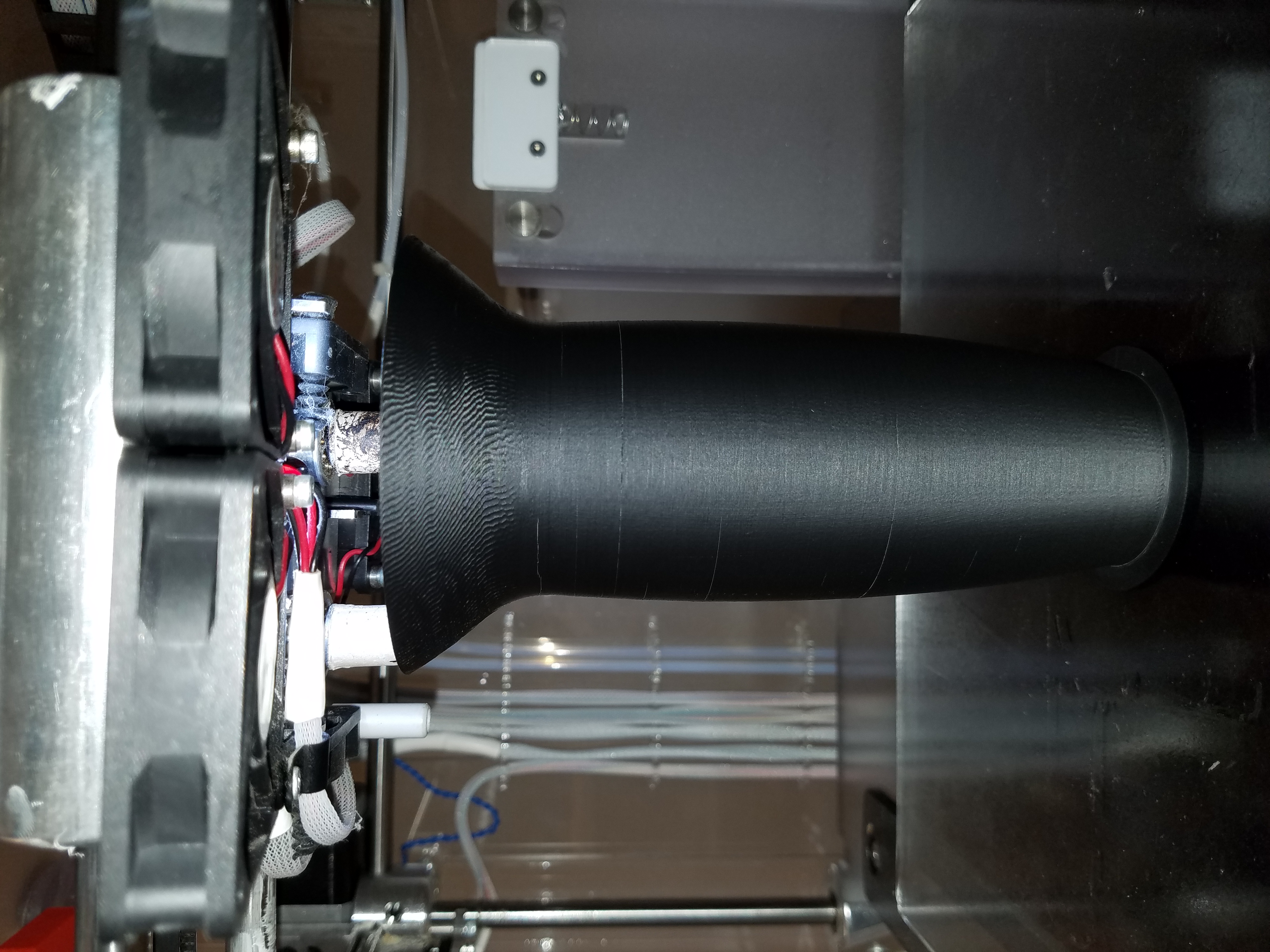

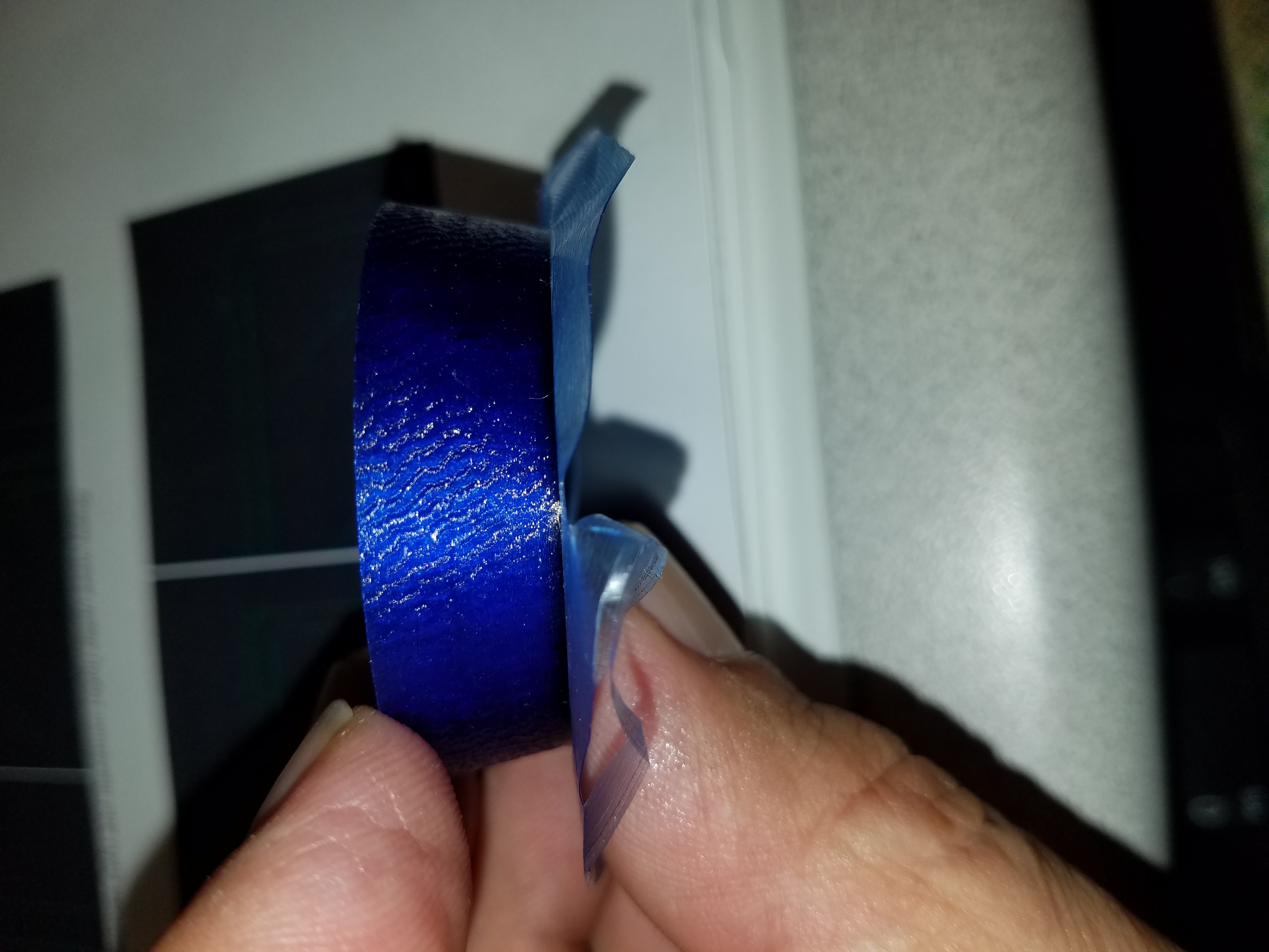

I have been having problems with this Ripples and waves on the sides of round parts. No matter what filament i use (ABS, PLA, PETG, etc...) the ripple is always there.(see attached) I don't have this issue straight wall parts. Any help would be appreciated.

I only get these ripples and waves when I am printing round parts with slight overhang. As you can see in the photo the part is printing very well until it starts to flare out at the top. That's when the ripples start.
Re: Ripples and waves on the sides of round parts.
What layer thickness and extrusion width are you using for those prints? I start getting surfaces that look like that when each perimeter isn't supported enough by the perimeter below it. You could do a quick test with thinner layers, or wider extrusion width, or slower / more cooled perimeters.

You were right. I have a 0.4 tip and my extrusion width was 0.3. With a little bit of experimentation, setting the extrusion width to 0.5 reduced the ripples.
