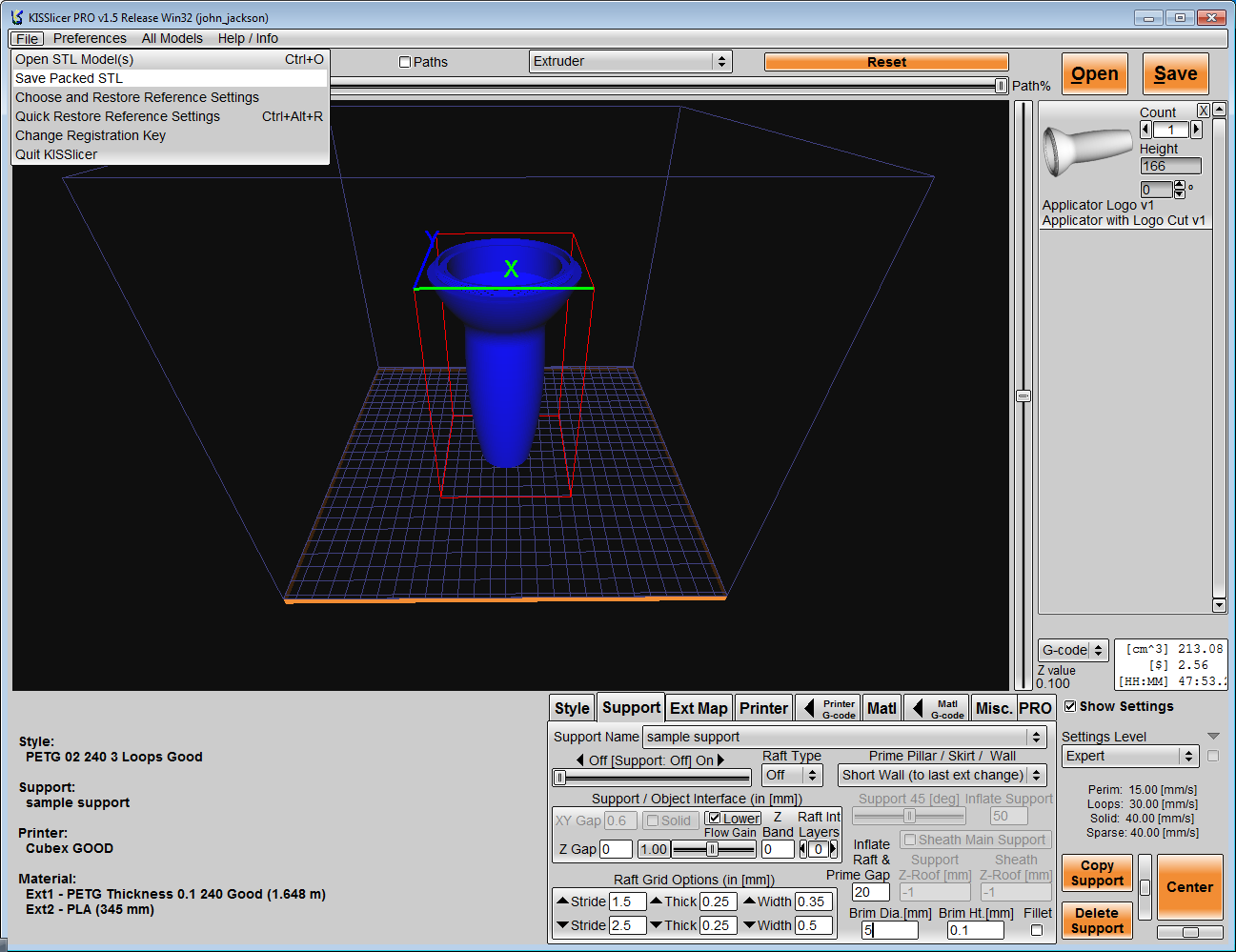

If you save a KISSlicer Project file (*.KSP) and upload it here, we could easily take a look at your settings.

How do you save to a *.ksp file?

On the menu, [Project]->[Save Project As]

Don't have that option.

Ah, my mistake! I thought you were running the new 1.6 beta...that option does not exist in the older version.
If you can just trim the opening text of the G-code, all the settings are saved in comments there.
